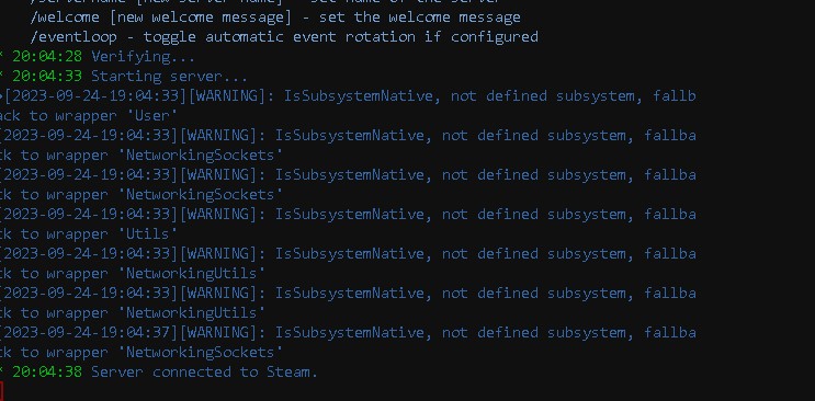

Hi Ich. This is perplexing then as when i set to false the server crashes. When i set to true its stable and connects to steam. could there be bios settings that solve this?
Hi ich, I just checked the log files at the point of crash from the docker console and this is the line logged indicating a segmentation fault when FORCE_86 is set to false:
15:24:48 Host identity created.
/opt/scripts/start-server.sh: line 69:     66 Segmentation fault     ./arma3server_x64 ${GAME_PARAMS}
  • Replies 12.6k
  • Views 2.2m
Usually not.
This happens on some systems don‘t worry too much about it, if it runs fine in x86 mode than it‘s fine too.

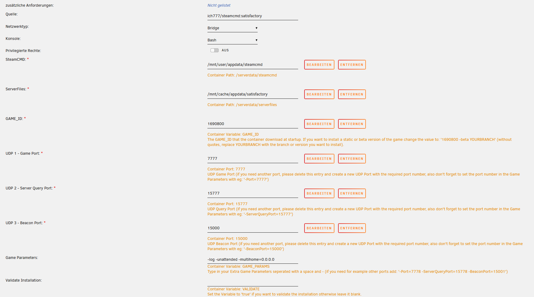

I have 3 minecraft basic server's up and running, every thing works game wise but i can't get the tcp web console to work on any of them chrome or edge.
cheers
A bit more information please, what ports have you changed or what did you do exactly?
Do you have by any chance a screenshot from your Docker template?
I think you are talking about that correct:

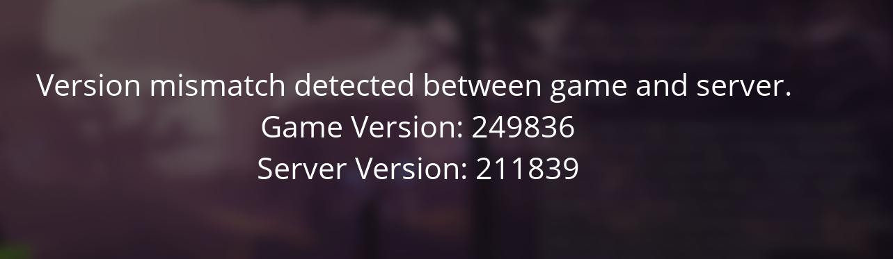

On 9/11/2023 at 10:16 PM, ich777 said:
What version conflict do you get?
When I start the Game and got to Server Manager to start a session from my Server, i get the following Screen:
What version do you use on your PC and what on your Server?
Do you maybe use another branch on your PC?
I'm not completly sure how to view the Version. I attach some screenshot from the game and the Docker page, maybe you can see whats mismatching.
This config worked for quite a long time, but since I updatet the game some weeks ago, I always get the message of the mismatch.
Have you yet tried to force a update with the Validation Installation (please don't forget to unset it again after it finished verifying)?
You can also try to set up a second instance if that is working.
Yes, I set the Validate Installation to true, updatet the container and removet the variable, still doesn't work. Just set up a new container, also don't work.
Could there be a problem with steamcmd?
No.

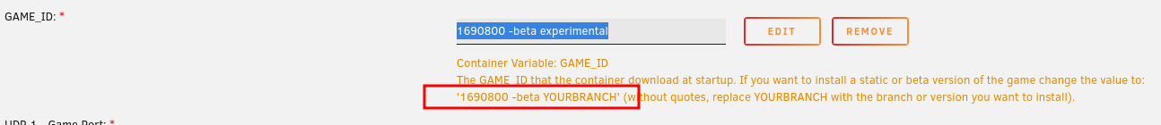

22 minutes ago, b_tob said:
Ah, now I saw it... You are using the experimental client. You have to add that to the GAME_ID:
-beta experimental
You are on the experimental branch and therefore you have to also use the experimental branch on the server (please note that switching branches needs validation the installation once).
See also here: Click
Thanks, this was the solution!

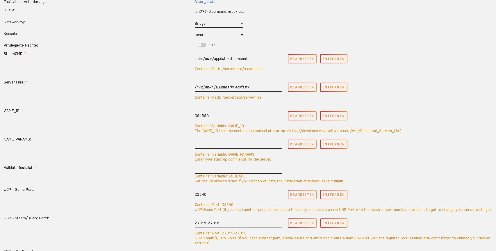

I installed Wreckfest today. (for testing for a lan party) unfortunately I can't find the server in the game under LAN. I didn't change anything after the installation.
Did you make sure that it is also reachable from outside?
The log is also looking good to me.
What do you mean?  The server comes onto the Internet.  Or should I set port forward.  (I'll have to see how it works first).
Yes, you should definitely do the port forwarding.
My server is only visible on the LAN after I do a proper port forwading.
Just to be sure you changed nothing in terms of port forwarding in the template correct?
Ok thx. Is that necessary for all servers that are from STEAM.
Nope, only for a few of them. V-Rising back then was such a game but they've implemented LAN mode but you have to pass over an argument to start it in LAN mode for example. AssettoCorsa and AssettoCorsaCompetitione is online only and a few more but I don't remember all of them.
However most of them work fine in LAN too and sometimes need a special argument to be passed over <- but that is only necessary for a few games.

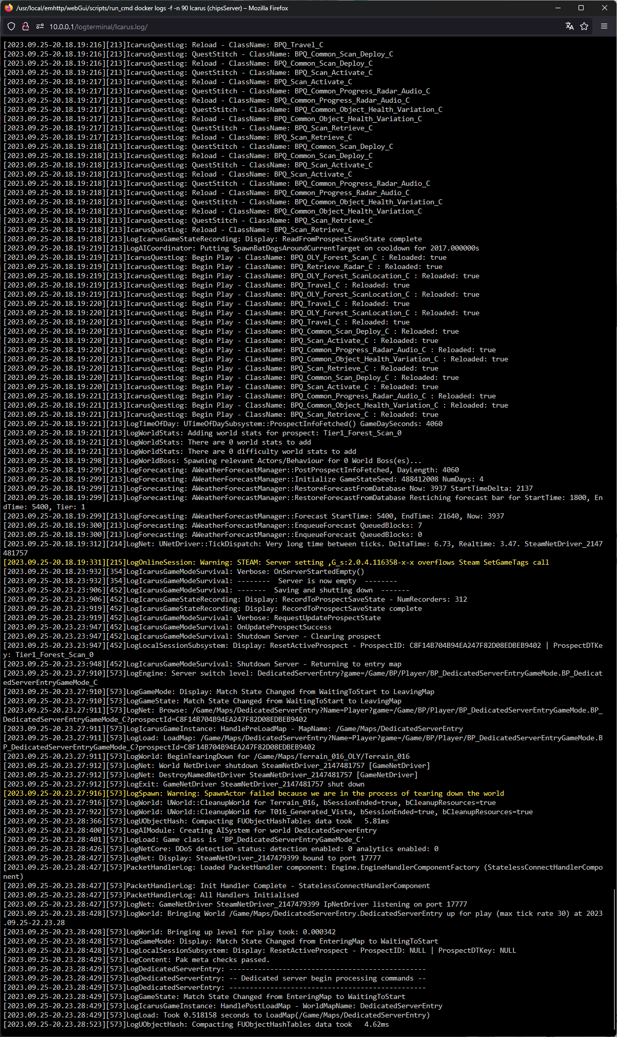

Having the same problem with Icarus. Yesterday everthing was working fine but since today it stops everytime. We change nothing. I have removed everything in appdata and the steam folder went to CA and grabbed a fresh template but with the same result. The log of the docker is the same as @SlyFox
Edited by Pepreal
3 minutes ago, Pepreal said:
We change nothing.
Was maybe the dedicated server updated through SteamCMD?
I'll just update my container real quick and let you know how my container is doing.
Just tried it on a different Unraid server which is on a different location with a clean Icarus docker but it does exactly the same.
Edited by Pepreal
Just working fine here:
What CPU/type of system are you using? Does you system support AVX?
CPU is AMD R5 5600G and yes it supports AVX. We played yesterday with no problems. When start to play we start the docker and when we are done we are stopping the docker thats it. Both server doing the same thing.
Edited by Pepreal
Just now, Pepreal said:
CPU is AMD R5 5600G and yes it supports AVX. We played yesterday with no problems. When start to play we start the docker and when we are done we are stopping the docker thats it. And it both server doing the same thing.
Since when have you set up this container?
Have you maybe restarted the container when it still was doing stuff for the second time? The container can take a really long time (about 3-5 minutes on my i5-10600 after the initial download finished).
I assume you have enough free RAM correct?
It seems like that WINE can't start the game which most of the time happens when it is not set up correctly.
Please do the following:
  1. Stop the container
  2. Go into the directory for Icarus (usually in your appdata)
  3. Remove the directory "WINE64" and the file "runtimes"
  4. Start the container again and wait <- this could as said take some time and the log probably won't move
Hope that will make it work.

When the docker did not work i removed everything, the Icarus folder in the appdata folder, the steamcmd folder and the docker image, went to the appstore downloaded the latest Icarus template, started the docker waited for long time and when it was finished it started to restart constantly. and my screenshot from above is al what its doing. So this is a clean docker, appdata folder and steamcmd folder. Sorry English is not my main language.
