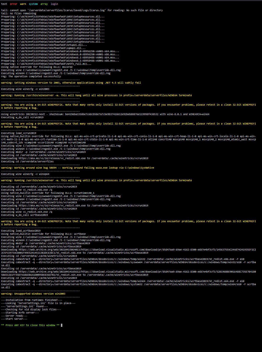

4 minutes ago, Pepreal said:
When the docker did not work i removed everything, the Icarus folder in the appdata folder, the steamcmd folder and the docker image, went to the appstore downloaded the latest Icarus template, started the docker waited for long time and when it was finished it started to restart constantly. and my screenshot from above is al what its doing. So this is a clean docker, appdata folder and steamcmd folder. Sorry English is not my main language.
Do you maybe have another Intel based system? I remember an issue with another container with an AMD system where I was forced to use WINE for starting the game but I really can't remember.
Have you yet tried what I recommended above?
As said, I can just start the container over here fine and it also runs perfectly fine.
I do not have a Intel based system. both server that i can test/use are AMD based
Yes i have tried what you described.
Stop the container
Go into the directory for Icarus (usually in your appdata)
Remove the directory "WINE64" and the file "runtimes"
Start the container again and wait <- this could as said take some time and the log probably won't move
but its still not working
why would for weeks the docker work fine and since today not anymore. The docker image it self hasn't got a update for a month and we have not changed anything to the server itself.
Stop the container
Oke found the problem. We had Icarus and steamcmd folder on a different folder called appdata_gaming (ssd). Now i let it install to appdata folder itself and it seems to start normally again. Its weird because we starten like this with appdata_gaming with no problems until today.

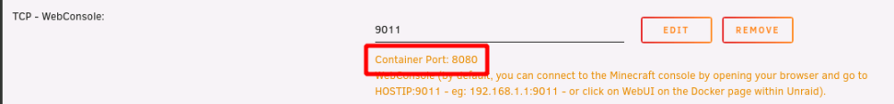

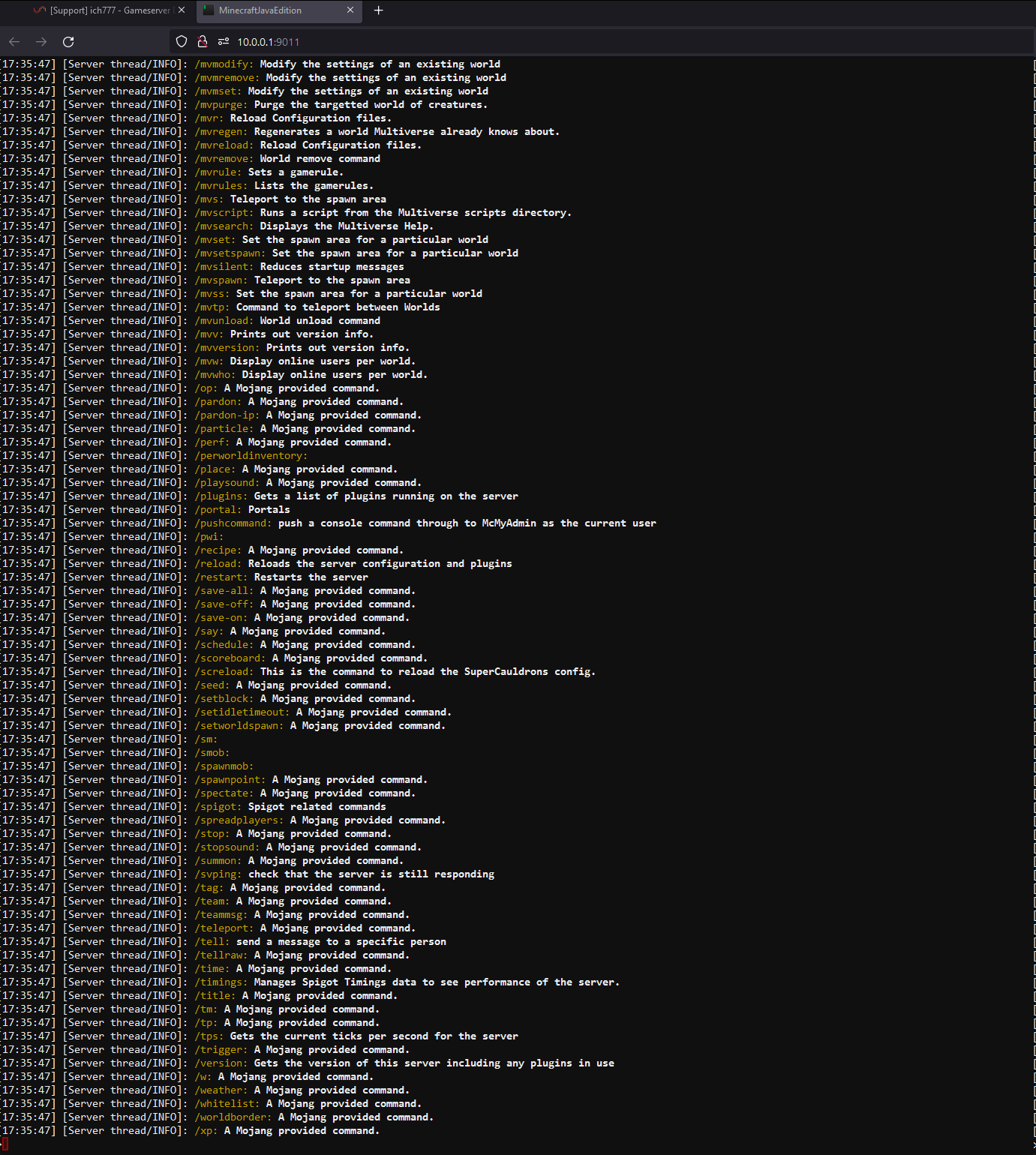

Yes that's that is correct the console. ok so none work in chrome i just get white page, but 2 of them work fine in edge. the one not working always takes me to x.x.x.x:8080 despit setting the port to 9020.
I will try and make new container when i get chance see if that solves it.
Cheers
This is because you've fiddled with the Port itself, the port inside the container always have to be 8080 and you changed that to 9011 which can not work:
If you want it back to get it in a working state then simply delete your port entry, create a new port entry with the container port set to 8080 and the host port set to 9020, after that you will be able to connect to the console through YOURSERVERIP:9020
That should not be the issue at all but TBH I really don't know if this even can cause this because the SteamCMD directory is independent from the Game Data folder.
So is it then working again?
Please also double check your port mappings and if you use for example /mnt/cache/... that the following folder stays on the cache and is not moved off of the cache disk.
Yes for now its working but the folder is not on the cache, its a separate SSD so its something like /mnt/gaming/... I have now installed it on the cache. That works.

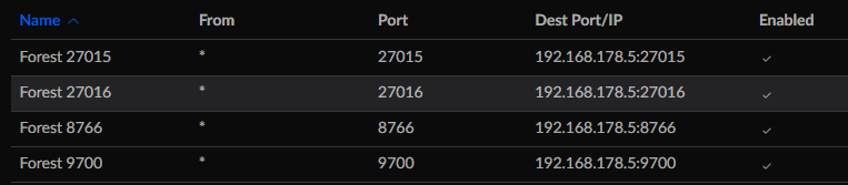

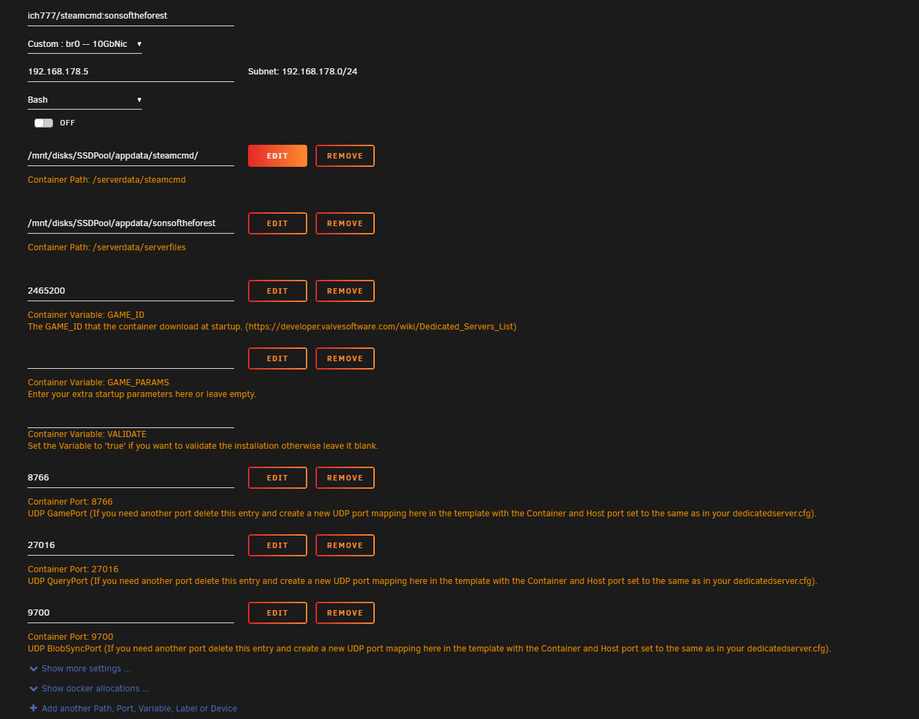

Hey im trying to Start a Sons of Forest Server.
But everytime i get the message that my UDP gameport 8766 is closed. I´ve opened a the port in my UDM Pro Firewall like all the other ports needed. butonly on this port im getting the error.
does anyone know how to solve this?
All ports are not only UDP or TCP they are opend for both.
Edited by stFfn
Don‘t do that. Please only open UDP ports!
EDIT: I forgot, you can also skip the check: Click
ah ok sorry. that seemed to have fixed it.

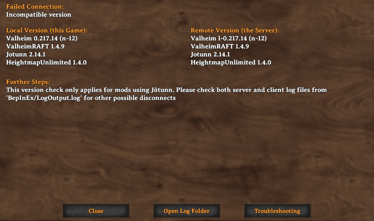

Server downloaded a non existing game version? How do i set it to think it's the version it actually is?
the server thinks it's version 1.0.217, while the client is the latest 0.12.17 image.thumb.png.7834238830a48ef71cf08a11f543858f.png
What are your current settings? Do you habe Valheim+ or BepInEx enabled?
Is this a mod? If yes try to disable it entirely and test again.
