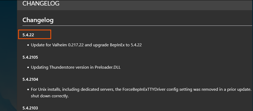

Something is not working correctly after the new Valheim patch and the BepInEx update we got today. Seems like it's not downloading BepInEx properly.
Also, they did add some new parameters for the servers today, not sure if anything needs to be changed for that.
Someone on the Official Valheim Discord actually found the issue for you:
I have no idea why but I looked at that docker code - it's because it is trying to download 5.4.22 but the actual version number in the download URL is 5.4.2200
[...]and is parsing the HTML on the thunderstore page's changelog instead of using the thunderstore API
Just did some tinkering and if you set your game to Beta -> default_old and in the Docker Container the GAME_ID to "896660 -beta default_old" (wothout qoutes) it will work on the old Version and Valheim_Plus or Bepinex have time to update the Mod
