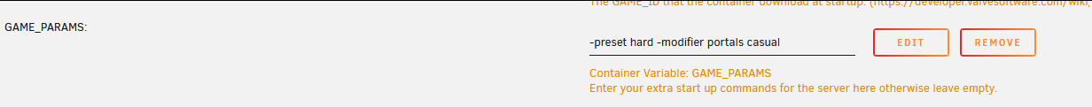

Comma separated, space separated?
Just as you would use them in the .sh file like:
-preset hard -modifier portals casual

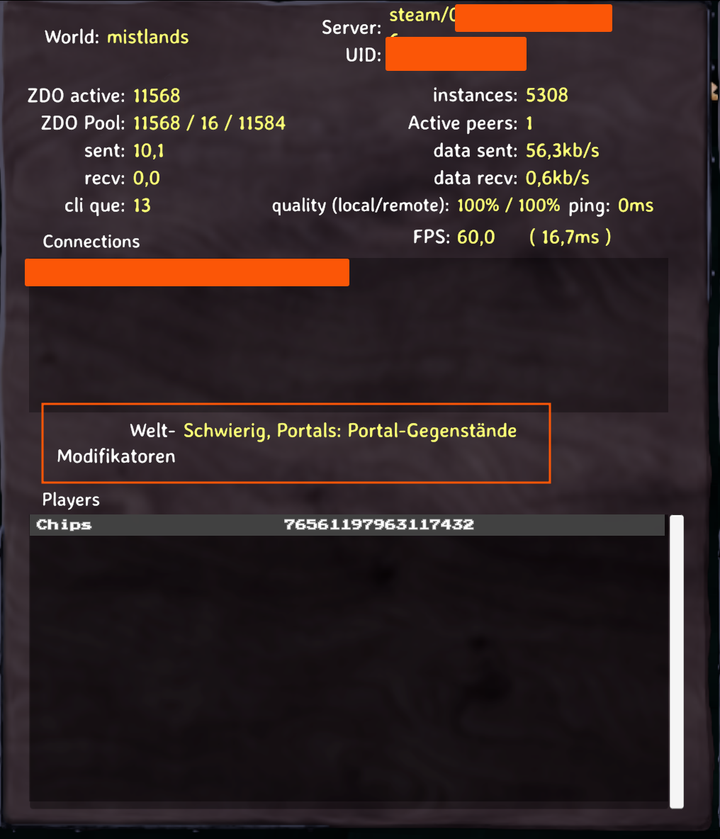

AFAIK the modifiers doesn't always show up on the server list...
However, connect to the game and Press F2 on your keyboard and you should see the modifiers:
