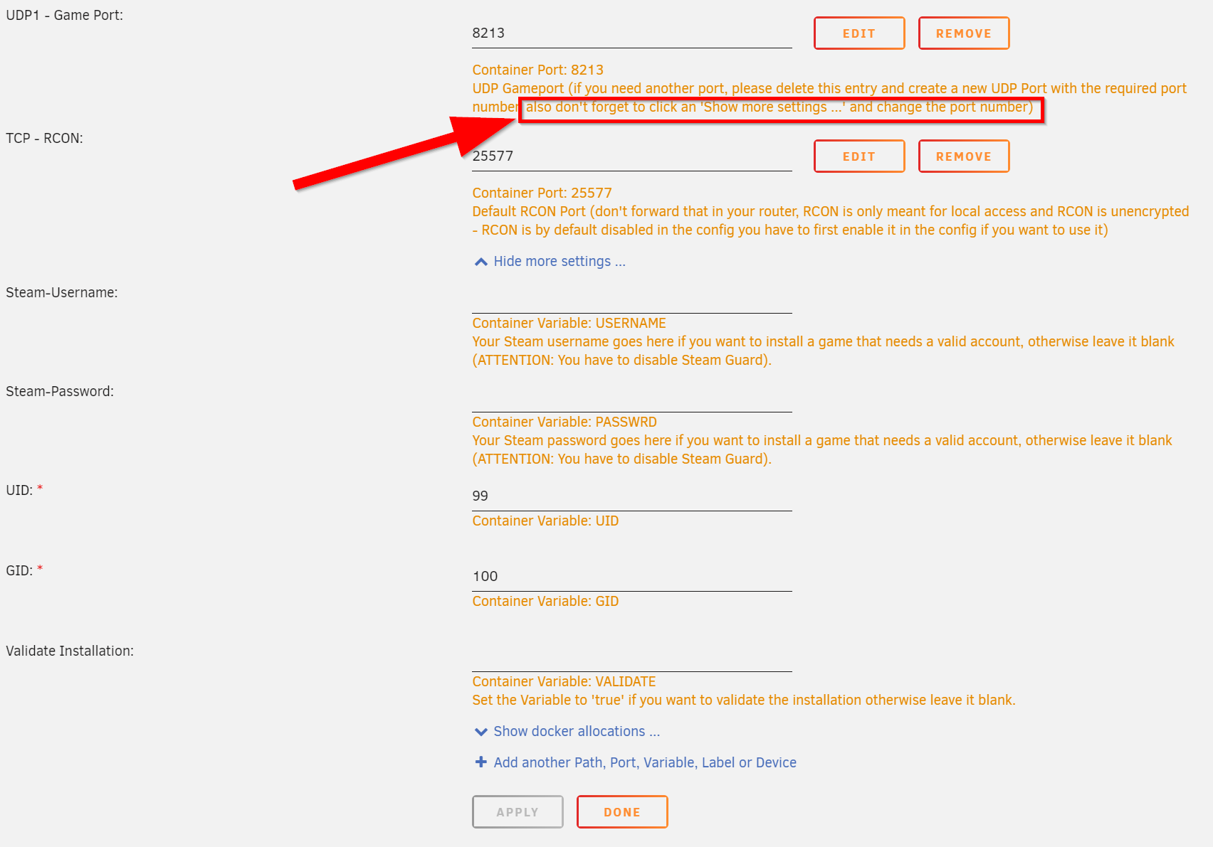

5 hours ago, Zalszibar said:
You have a note in the container @ich777 that says also don't forget to click an 'Show more settings ...' and change the port number, but I'm unsure what value you're intending us to change?
This is a copy paste error and oversight from me, already removed that.
If you want to change the port you have to change it in the config and follow the directions in the template.
I would also not recommend to change the ports since this won't do anything, please start over with a fresh template/game files directory.
However your server seems to be running fine. ;)

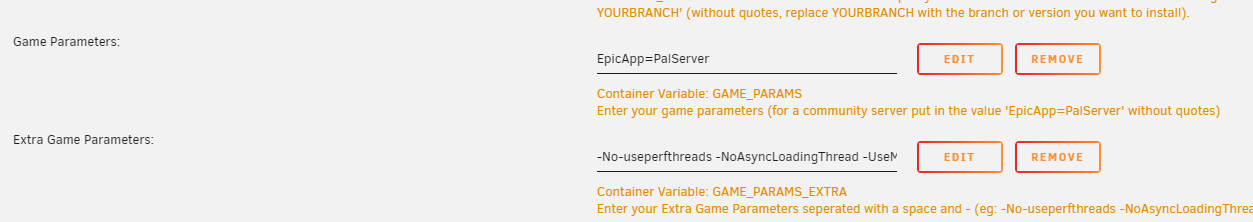

Hey ich777,
I only see these as the default params
EpicApp=PalServer
and
-No-useperfthreads -NoAsyncLoadingThread -UseMultithreadForDS
What is the password removal parameter you are referring to?
Just as I wrote:
  1. Remove the parameter from GAME_PARAMS
  2. Edit the configuration file (read the description from the container) and remove the password (but don't remove the double quotation marks from the password) from the configuration file.
Please also note that you have to first stop the container before editing the configuration otherwise your changes will be discarded and reset.

If it is reachable from outside then it is working.
Keep in mind if you have a dynamic public IP then you have to restart the container if the IP changes.
Please also read this comment about that it takes a few minutes so that the server is actually visible and how to search it in game:
1 hour ago, ich777 said:
What game? Palworld?
If we are talking about Palworld then you have to remove the password from the configuration (but don't remove the double quotation marks) and the entry that is specified in the GAME_PARAMS in the Docker template.
After that you can connect through direct connect.
you were completly right whitout knowing which game i meant!
so removing the line "EpicApp=Palserver" out of the template
and
removing the Password "adminDocker" or "Docker" from the config file?
Yes, but you have to leave the double quotation marks "" in there so that the game knows there are no passwords, you can leave the AdminPassword in btw since this is only the password for the in game console that you can issue admin commands.
So to speak it should look something like:
...,AdminPassword="adminDocker",ServerPassword="",Pub...
Yes.
After that you should be able to direct connect with the IP from your Unraid server and the PORT.
