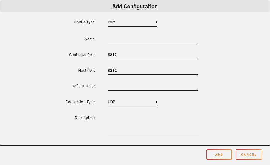

My current challenge is: I want to run multiple palworld servers if possible (for different sets of friends) is why I'm trying to change the ports in other containers.  I've tried changing the ports in both the config file (for example: PublicPort=8213, RCONPort=25577) and deleting then creating new UDP and RCON ports in the template.  Seems to display correctly in the port mappings of the docker container list in Unraid, and I confirmed the config files updated correctly (I stopped the servers, edited the files, verified the files)...but still receive connection timeouts when attempting to connect.
2 hours ago, ich777 said:
Yes, but you have to leave the double quotation marks "" in there so that the game knows there are no passwords, you can leave the AdminPassword in btw since this is only the password for the in game console that you can issue admin commands.
So to speak it should look something like:
...,AdminPassword="adminDocker",ServerPassword="",Pub...
Yes.
After that you should be able to direct connect with the IP from your Unraid server and the PORT.
Can you post screenshots what you did exactly? How does the configuration file look like?
EDIT: I've tested it now and this is the solution:
Please add this to the GAME_PARAMS:
port=8212
After further investigation you don't need to change the port in the config file, simply append or put that in the GAME_PARAMS variable and it will work (of course if you want to use port 8212).
Please also don't forget to delete the existing port mapping in the template for the Game Port and create a new one like that:
Hope that helps. ;)

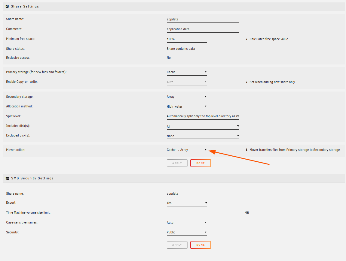

45 minutes ago, Etelari said:
I ended up changing the serverfiles location off of the cache and to the array directly like in my screen shot.
That will work but none of the screenshots show your share settings from appdata, go to the Shres and click on appdata.
I would strongly recommend that you let the appdata share on the cache and not kove it to the Array so that the Array can go into spindown.
Of course that depends if you want to do that but the appdata share should stay always on the cache and should not be moved to the Array.
Oh sorry about that.  Here is my appdata share.  Ill change it back. It was on the cache before and thats when I had that issue so if I put it back to cache, I'm scared I might lose my world again.   I will test it out and see

Just to update for anyone else who may have problems. The online port checker utilities do not show this port as open
As I've already explained... :D
I think you didn't read the post that I've linked correct, in the second paragraph it's explained why... :P
12 minutes ago, Matrix said:
And since I had rcon disabled the 8211 was going nowhere
Sorry but that is completely not true even if you've disabled RCON (which it is by default and the template also states that) the port was forwarded (the wrong port forward would have fixed that too btw).
However I've never seen such what you are described with the ports and is technically not possible by default.
16 minutes ago, Matrix said:
This is the problematic setting:
I would recommend that you change it to Array -> Cache and after that invoking the Mover but please be also aware that I would recommend that you first stop the entire Docker service since if the Mover detects files which are currently in use it won't move those files.
By changing this setting to Array -> Cache and invoking the Mover it will move all files in the appdata share back to the Cache and will ensure that it will stay on the cache (which in my opinion is the way to use the cache).
With that the Array will be able to sleep, if nothing else is reading or writing to the Array.
Also keep in mind if you have VMs running that you maybe also stop the VM service before invoking the Mover so that it can also move these files to the Cache.
After the Mover is finished you can start the Docker (and VM service) again and it should all work as it was before (after that you will be able to change the path to the game files in the Valheim template back to /mnt/cache/...).
Hope that all makes sense to you. ;)
Yup it does!  I will do this.  Thank you again for this help.

12 hours ago, ich777 said:
Are you sure?
What does the logs say?
Please don't change the ports, as you can see on the last 4 pages it is working in it's base configuration.
Such tools won't detect most game servers and they are useless for checking if the port is open since you are dealing with a game server and not a http/https server and nothing is responding to http/https requests.
No.
Without that little information I can't help, have you read that here:
The server needs a bit to be up and running and then you have to wait a bit in the server list itself.
Please start over with a fresh template/game files directory.
You were right on this one, thanks! I assumed that the port wasn't open because that website is how I've tested all other game servers I have. Sorry for not testing more, I just mainly came here to see if I was missing something. I appreciate the work on this!
I typed in my dynamic dns name followed by the port in palworld and it worked while tethered to my phone.
Edit: donation sent also!
