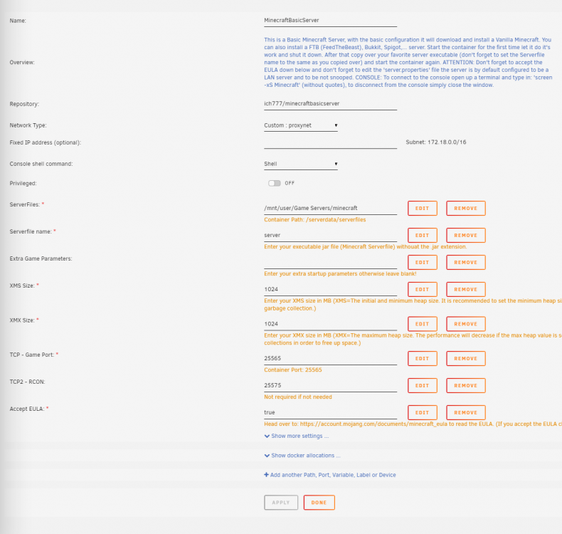

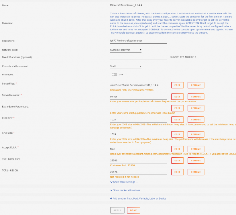

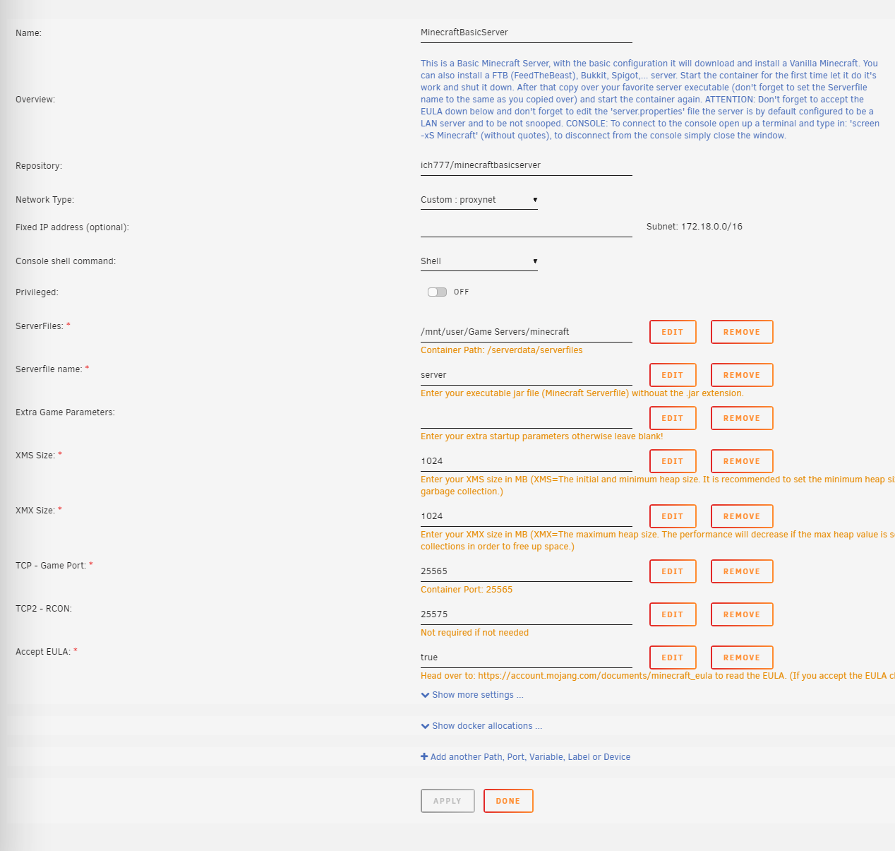

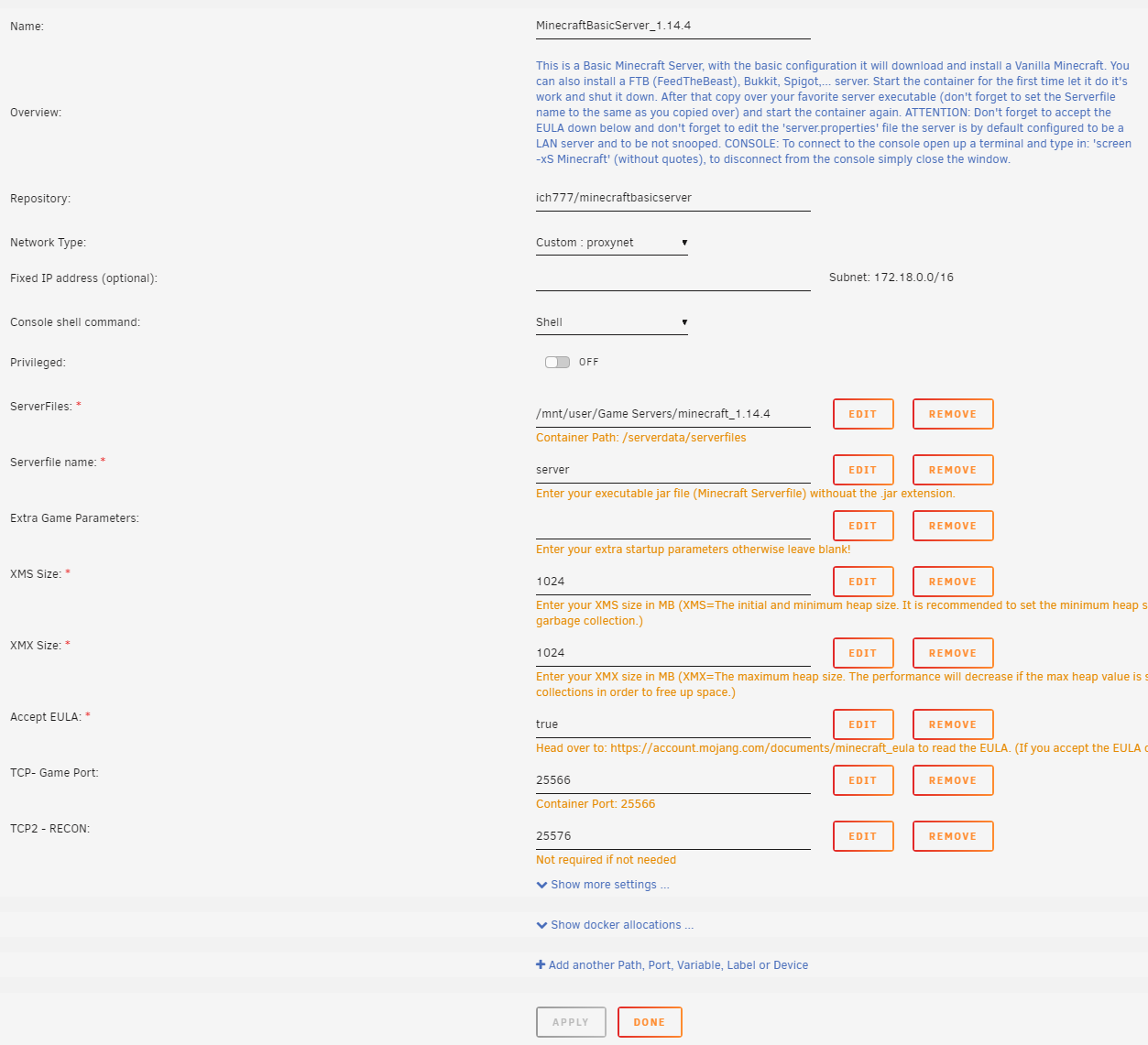

Was wondering if anyone could help me with being able to add a second Minecraft server. I'm a little stuck. I created a new container using the working Minecraft server as a template and changed up the port #s and with a new name. I then tried to add it to my DuckDNS, and LetsEncrypt as a new subdomain.
Container starts successfully in Unraid but when i go to the server files to upload the new server.jar it did not actually run or download any of the needed files. I was wondering where i might be going wrong with setting up the second docker. Original still works. Would greatly appreciate any guidance/advice! See attached below of settings i've got for the two containers.
