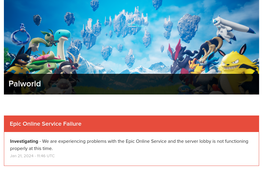

I'm also seeing this. I don't know if it's connect to this. They posted it in the official discord just over an hour ago
"Server Outage Notice:
As the number of concurrent players across all platforms exceeded 1.3 million, the Epic Online Service is currently experiencing outages due to an unusually high load worldwide.
This is causing connectivity issues with co-op and servers.
Singleplayer is unaffected by this server outage.
We are sorry for this inconvenience and we are working to recover stable operation as soon as possible.
Thank you for your patience"
