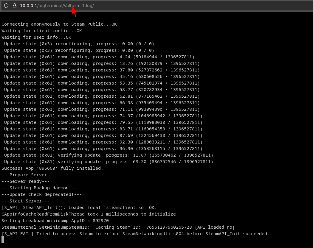

Fresh Valheim container, seems to be just going around in a loop?
I have used other containers by yourself- one i think which wanted credentials... could this now be breaking this container?
Steam Console Client (c) Valve Corporation - version 1705108307
-- type 'quit' to exit --
Loading Steam API...dlmopen steamservice.so failed: steamservice.so: cannot open shared object file: No such file or directory
OK
Connecting anonymously to Steam Public...OK
Waiting for client config...OK
Waiting for user info...OK
Success! App '896660' already up to date.
Is this the full log output?
No, you don‘t need your Steam credentials! They are only needed when the are not hidden away in the „Show more options…“ and marked wirth the red asterisk.
This usually means that the game is segfaulting.
On what hardware do you try to run the container?
Please also disable validation, this will do nothing in your case.

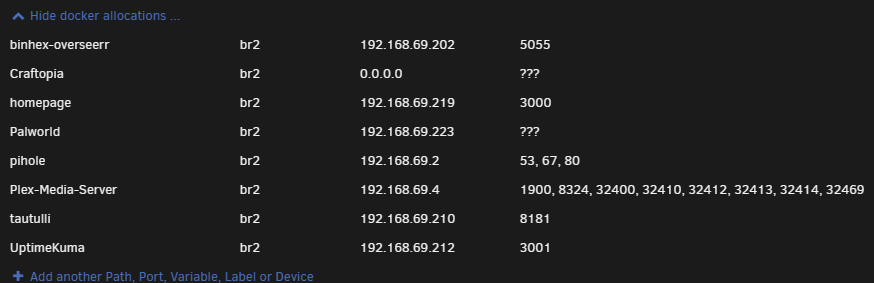

I have 8211 (set as default in docker config, port forwarded correctly like i have other working services. docker allocation shows it listening on it as well.
when I or anyone else tries to connect, it gets a network timeout. opnsense was only showing a PASS for outbound traffic via 8211 UDP. if I checked the info firewall logs it would show packets for IN from a known host(a friend, or me on wifi hotspot) and the packet is BLOCKED with IP:random port like 20304 > server dest 8211.
I agree, probably networking issue but I've done everything right.
Just to be sure, you've set it up like that:
As said, I only can tell you that is working fine over here... Maybe something is missconfigured, I really can't tell...
Please also double check the protocol, it's UDP only.
https://pastebin.com/GcB5qdsX
Put it in a pastebin, but i've reinstalled the container and it seems to just loop around.
I've looked over the log folder in \valheim\Steam\logs and can't see anything standing out
Hardware? On what Unraid version are you?
3 minutes ago, Rinny said:
[----] !!! Fatal Error: Steamcmd needs to be online to update.   Please confirm your network connection and try again.
There is your error.
1 minute ago, ich777 said:
Hardware?
Intel® Core™ i7-5820K CPU @ 3.30GHz
32GB of Ram, Docker img on a NVME Drive
maybe i need to up the max docker image size?
I‘m not sure if the 5820K supports all the necessary instructions to run the game.
6.12.6 :(
maybe time to upgrade hah
I'm really not sure, please give me a bit and check back in this post in a few minutes, will try to spin up Valheim on my server real quick and edit this post.

But my server is online. Tried the docker Network Type setting in Bridge and Host.
Hardware MSI x670-P, Ryzen 7950x, 64GB RAM running Unraid 6.12.6.
Update - Fixed. Created a custom network called unraid and allocated the Docker to that. That seems to allow download.

---Prepare Server---
---Server ready---
---Start Server---
setrlimit() failed with error 22 (Invalid argument)
- Max per-process value allowed is 0 (we wanted infinity).
sh: 1: xdg-user-dir: not found
dlopen failed trying to load:
steamclient.so
with error:
steamclient.so: cannot open shared object file: No such file or directory
[S_API] SteamAPI_Init(): Loaded '/serverdata/.steam/sdk64/steamclient.so' OK.  (First tried local 'steamclient.so')
CAppInfoCacheReadFromDiskThread took 2 milliseconds to initialize
Setting breakpad minidump AppID = 2394010
[S_API FAIL] Tried to access Steam interface SteamUser021 before SteamAPI_Init succeeded.
[S_API FAIL] Tried to access Steam interface SteamFriends017 before SteamAPI_Init succeeded.
[S_API FAIL] Tried to access Steam interface STEAMAPPS_INTERFACE_VERSION008 before SteamAPI_Init succeeded.
[S_API FAIL] Tried to access Steam interface SteamNetworkingUtils004 before SteamAPI_Init succeeded.
