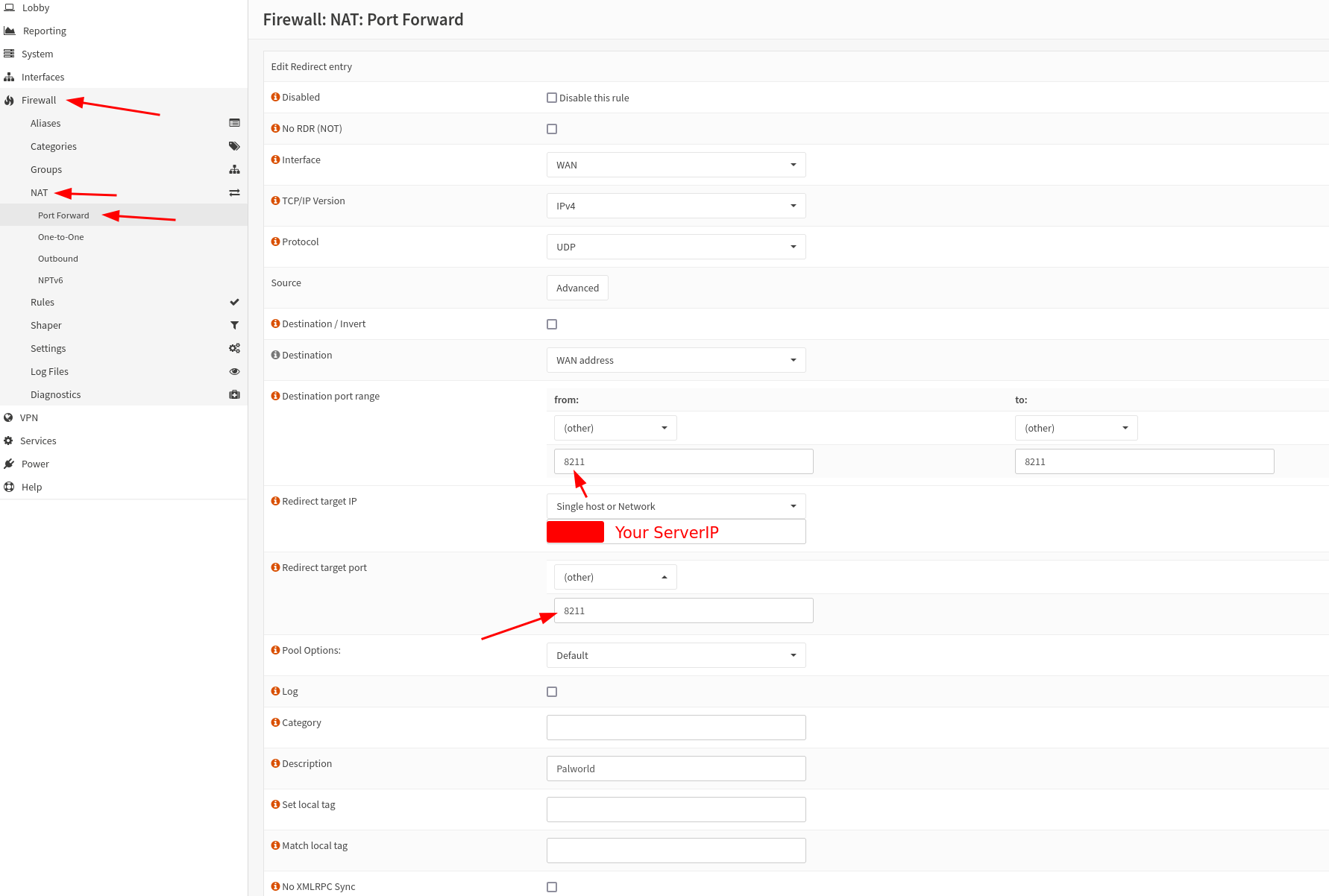

5 hours ago, ich777 said:
Just to be sure, you've set it up like that:
As said, I only can tell you that is working fine over here... Maybe something is missconfigured, I really can't tell...
Please also double check the protocol, it's UDP only.
I really appreciate you going above and beyond docker related support.
I tried multiple network options bridge, br0, host, etc. my opnsense forwarding it spot on.
For giggles I fired up an ubuntu 22.03 server VM, did the steamcmd fun and changed my port forward destination to it's IP and my friends can get in. I copied the same palsettings.ini file from the saved directory and everything.
I tried nc -u host port, and got success on the docker from a remote server. so I really don't know what's going on.

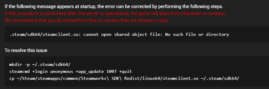

Quick question. It's really not the first time I see the error in steam container, in fact I think all of them as it and it never bothered anything. I'm just wondering, they are offering a fix for it in their faq (https://tech.palworldgame.com/dedicated-server-guide#qa)
Because it's a warning, not an error however this directions are that you've posted require the Steam client to be installed which is not in my container <- this would make no sense for a dedicated server.
If you look closely in the logs you would actually see that it finds the file where it should be:
[S_API] SteamAPI_Init(): Loaded '/serverdata/.steam/sdk64/steamclient.so' OK.  (First tried local 'steamclient.so')
The first warning is only displayed because it tries to load the steamclient.so from the directory where the executable is located and I think this is what you are referring to:
dlopen failed trying to load:
steamclient.so
with error:
steamclient.so: cannot open shared object file: No such file or directory
However as said above, one line after this it finds the steamclient.so where it should be and continues. ;)
Hope that answers your question. :)
Sorry but this seems to be a network issue where I can't help and have to figure out on your own.
The container is running just fine on my machine and people are able to connect just fine with my hostname and also with my public IP.
It is working for other people too and they have no issue connecting.
