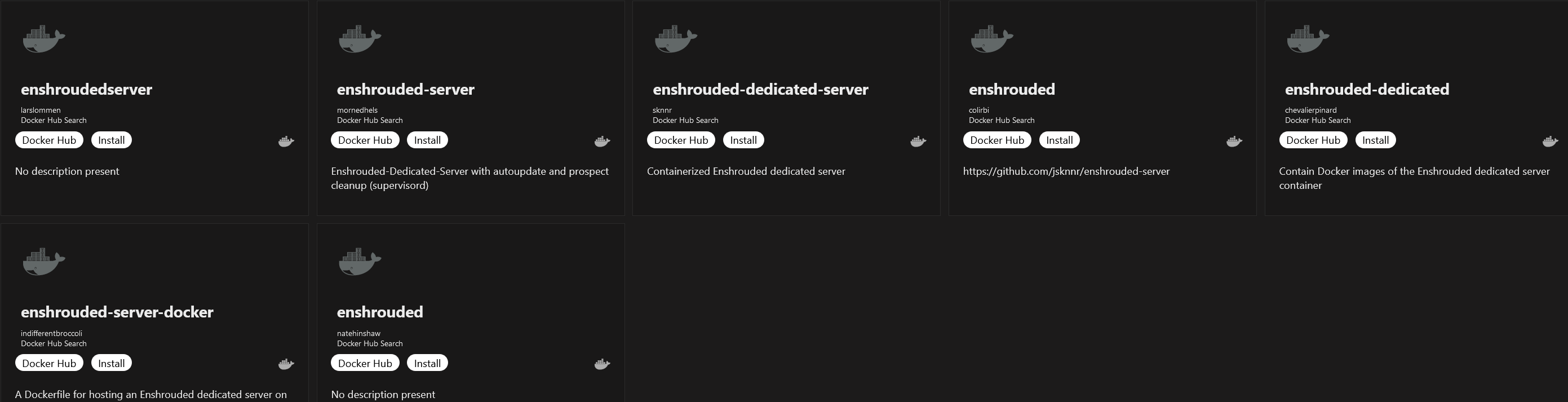

55 minutes ago, CoZ said:
There seems to be quite a few of them on Docker hub.  However, I wouldn't even know which one would be "best" and not sure the level of trust would be the same as an ich777 docker container lol
I'm trying one those but no joy in mudvill
Command executiondocker run
  -d
  --name='enshrouded-server'
  --net='br0'
  --ip='192.168.1.1.132'
  -e TZ="America/Los_Angeles"
  -e HOST_OS="Unraid"
  -e HOST_HOSTNAME="nas-mass"
  -e HOST_CONTAINERNAME="enshrouded-server"
  -e 'USER'='root'
  -e 'HOME'='/root'
  -e 'LANG'='en_US.UTF-8'
  -e 'LANGUAGE'='en_US:en'
  -e 'Community_Applications_Conversion'='true'
  -l net.unraid.docker.managed=dockerman 'mornedhels/enshrouded-server'
docker: Error response from daemon: invalid IPv4 address: 192.168.1.1.132.
See 'docker run --help'.
The command failed.
Your IP address is invalid you have X.X.X.X.X it should be X.X.X.X
