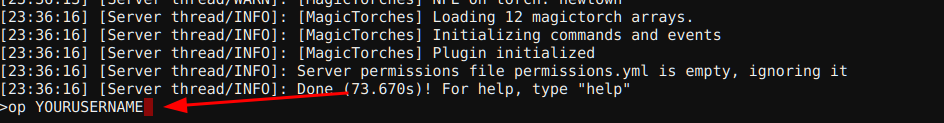

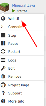

2 hours ago, davcollins said:
I'd like to be able to make basic changes to this server to begin and hopefully grow with it. I don't know the format or syntax to enter these variables in the docker template, they don't seem to be "taking" fully in the server.properties file, and I can't seem to elevate myself to an operator to change in game.
First you have to join you Minecraft server.
Then when in game open up the WebUI from the container:
And issue in the following terminal screens op YOURUSERNAME wher you have to replace YOURUSERNAME with your Minecraft username.
After you did that you can issue all your commands from in game eg:
/gamemode creative YOURUSERNAME
I think if you joined in survival once you are stuck in survival.
Thank You! I was able to elevate myself and change the world type.

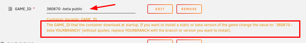

Hey ich so I think my issue with the PZ server was just a corrupted save file it appears.
out of curiosity in case I want to startup a build 42 version of the game, what game parameters would I have to put in to have it run build 42?
Edit: So it looks like build 42 isn't even supported for multiplayer yet so I'll be holding off on that until later on, but for futures sake, I was having a hard time trying to find documentation on how to update the game to an unstable or beta version. Is there a way to do it?
thank you
Edited by Tonborghini
This should do the trick:
(also mentioned in the description from GAME_ID)
But I'm not too sure how ProjectZomboid handles beta branches since every develop/team/studio handles that a bit differently, the best place to ask would be on their forums how to install a beta branch through SteamCMD.
