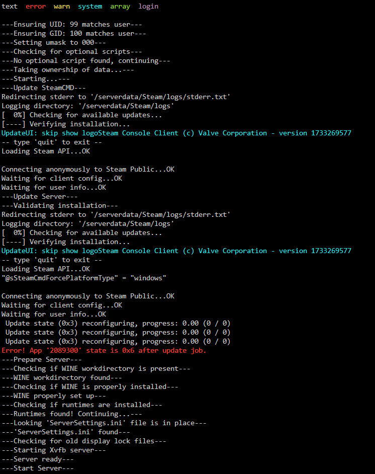

On 12/20/2024 at 1:14 PM, SOUPrayer said:
sorry for late reply. I tried that path and it shows same issue.20-PM-11-06-25_IS_floorp.thumb.png.30e9e22305f9d438429058f2741138e9.png
filesystem of cache is btrfs
appdata share has cache as primary, array (xfs) as secondary with Array -> cache mover rule
by the way, deleting Icarus and steamapps folder and starting the docker fixes this problem
I had this problem, deleting /array/user/appdata/palworld/steamapps/appmanifest_2394010.acf Solve the problem  (it was Palworld in my example)
Exactly, I would recommend that you delete the whole steamapps folder.
Maybe a recent SteamCMD update causes this issue, however, I was not able to reproduce this over here on my server.

7 minutes ago, EliteGroup said:
How to update Palworld?
  1. Stop the container
  2. Delete the "steamapps" folder inside your Palworld directory
  3. Start the container again
This should fix error 0x6, I assume a recent SteamCMD update causes this issues, because multiple game servers are affected.

My ASA dockers have stopped updating properly and im also getting the "error! app '2430930' state is 0x6 after update job." message and it fails to update to the latest version of the game.
Please see this post (three above yours) :
