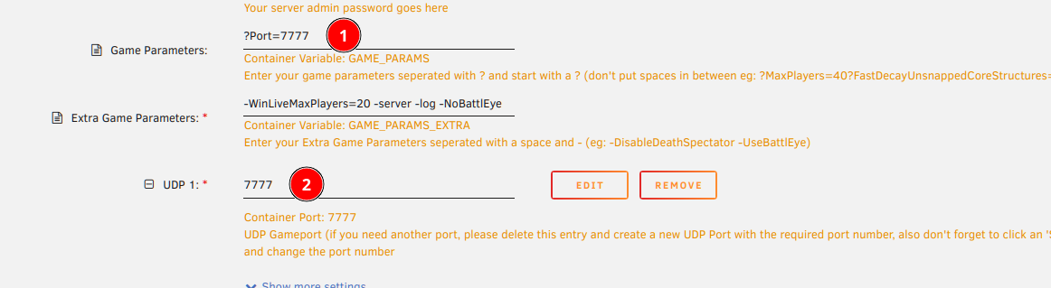

  1. The Game.ini file is not automatically generated inside the same folder as GameUserSettings.ini(Default Location is /mnt/user/appdata/YourArkContainter/ShooterGame/Saved/Config/WindowsServer). This file is pretty important if you want to fine-tune your server's settings. If the file is manually put there, the server will see it(After some tweaking which I will cover below), but it would be nice if it was automatically generated. I have read that sometimes this is just the Ark Server files being clunky but just thought I would bring it up.
  2. Port 7777 is the default port for the servers, but it seems like the UDP variable has to be deleted and readded with the different port number for it to actually update to the new port number. Could this be something I am doing wrong?
If you change 1 to something else than 7777 in the template you have to delete 2 and create a new port mapping with the exact same port number as 1 and choose UDP as protocol:

1 minute ago, Jwoff11 said:
For me being new to Unraid, why do you have to delete the container variable for it to apply correctly? Setting the variable to something different doesn't automatically change the port number on the start-up line? If it doesn't then why have the variable and just make sure it's in the startup line? Just trying to understand and learn more!
Because containers are isolated, by changing the port in the GAME_PARAMS variable you basically change the port inside the container and since the port forwards port 7777 from inside the container to 7777 outside the container that wont work and no, I won't recommend just changing the port in the port variable on the host to 7778 because this will not work for most game servers because on initial connection the server will send the specified port to the client (which is defined in the GAME_PARAMS variable) and if they don't match they can't handshake and the connection will be never be established <- this is done for security reasons if someone tries to hijack the connection.

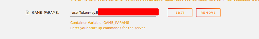

Getting the below error when trying to spin up an Eco server
Not quite sure how to fix this..
[08:45:59] Failed to start the server. Exception was Exception: Exception
Message:Authentication to Strange Cloud failed. No authentication methods were available. Provide valid credentials ('-username' and '-password' or '-userToken' or '-steamTicket') or use '-offline' to start server in offline mode.
Source:EcoServer
System.Exception: Authentication to Strange Cloud failed. No authentication methods were available. Provide valid credentials ('-username' and '-password' or '-userToken' or '-steamTicket') or use '-offline' to start server in offline mode.
  1. Go to: https://play.eco/account
  2. Log In
  3. At "Server Authentication" generate a Token
  4. Copy the Token to your clipboard
  5. Go to the Docker Template and at GAME_PARAMS enter:
    -userToken=<YOURTOKEN>
    (You of course have to replace <YOURTOKEN> with the token that you copied to the clipboard in Step 4)
  6. Click Apply
Your server should now start.
Good gravy baby, thank you! This was driving me nuts

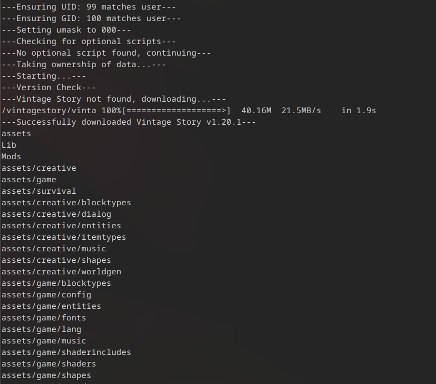

Issue with Vintage story after the 1.20 update. Existing and new containers spit this out over and over after restarting them. The new server files are downloaded because I can see the tar archive.
---Starting...---
---Version Check---
---Vintage Story not found, downloading...---
---Can't download Vintage Story v1.20.1, putting server into sleep mode!---
Update: I manually downloaded and transferred the 1.20 files...all good.
Edited by RS7588
Thanks for the report.
I will look into that!
EDIT: That's strange, I can't reproduce this over here... Of course this is a new installation but it seems everything is working:
However I will push a update to the container to maybe fix that in the future.
