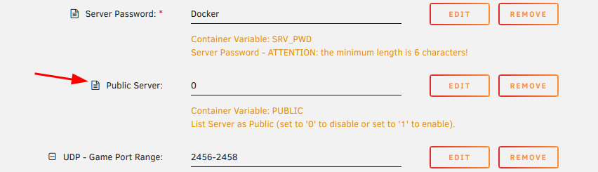

Please also make sure that you set public server to 0 in the Docker template:

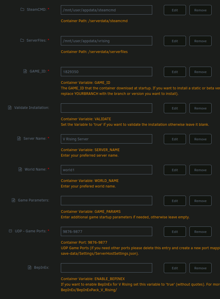

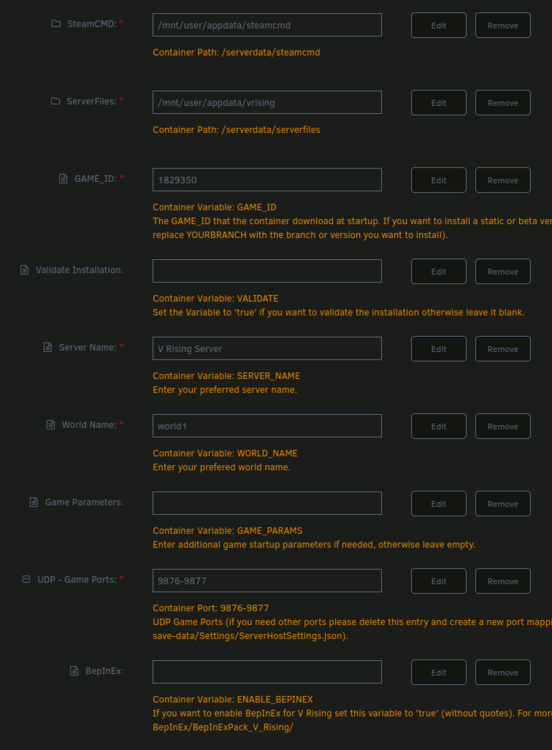

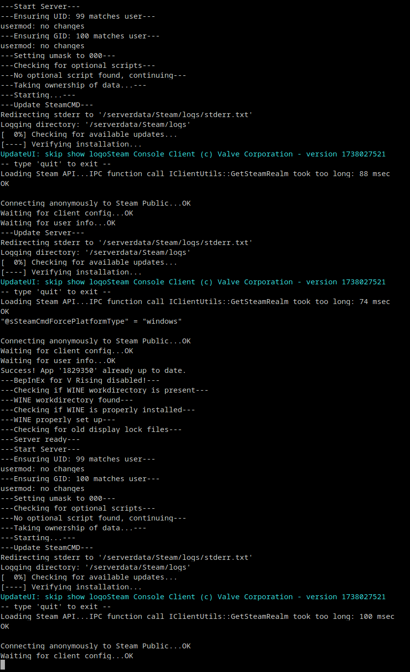

I am having issues with the V-Rising server, it keeps restarting.
Reading through this thread, I have attempted to use a new appdata folder, and went so far as deleting the container and images, downloading fresh from CA, and setting up with a new folder. Nothing seems to be changing the behavior. Container logs are not giving away any indication of an issue. I did notice that the newly created appdata folder is looking a little bare compared to my original one.
image.thumb.png.47c8d2d6b28bc7e71c9bf3118d383315.pngimage.png.4e3b8cf44e2be0b15854023d79b0f8e4.png
Please post the full log, this is only a part of the log, stop the container and then take a screenshot.

Sorry. log attached. It's complaing about no log file. Shouldn't the container be able to create that?
logs.txt

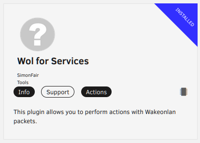

Maybe look into:
With that you can send a WoL to start/stop a container.
On what hardware are you trying to run the container, did you change anything in the Docker template, what path are you using in the Docker template.
Running on the Same x86 based Dell Server that the container has run on for a long time before. Unraid 7.0.0
I just tried it and it is working as expected, this is the log from a completely fresh installation:
vrising_log.txt

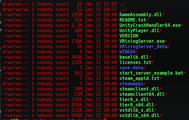

Please try to use the real path to the disk like /mnt/cache/appdata/... or /mnt/disk2/appdata/...
Can you also please be a bit more specific what this x86 Dell Server is?
V-Rising was updated about a year ago and if your CPU is missing certain instruction sets then it wont work or better crash instantly.
