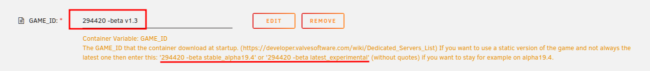

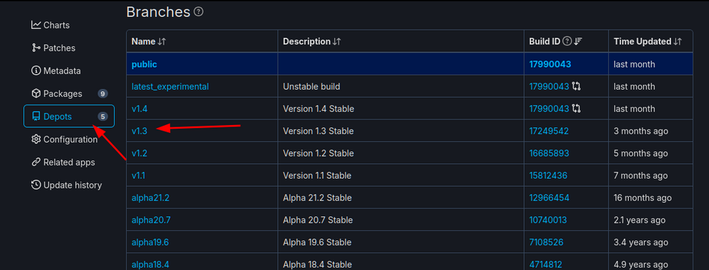

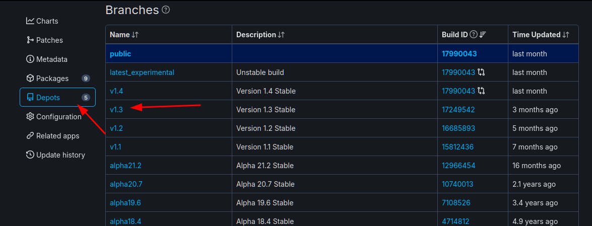

7 hours ago, Twitchy said:
I really don't know where you've get that from but @Mainfrezzer already posted what to do:
so to speak:2025-05-24_11-08.png
Please note that you also have to set VALIDATE to true when you switch branches.

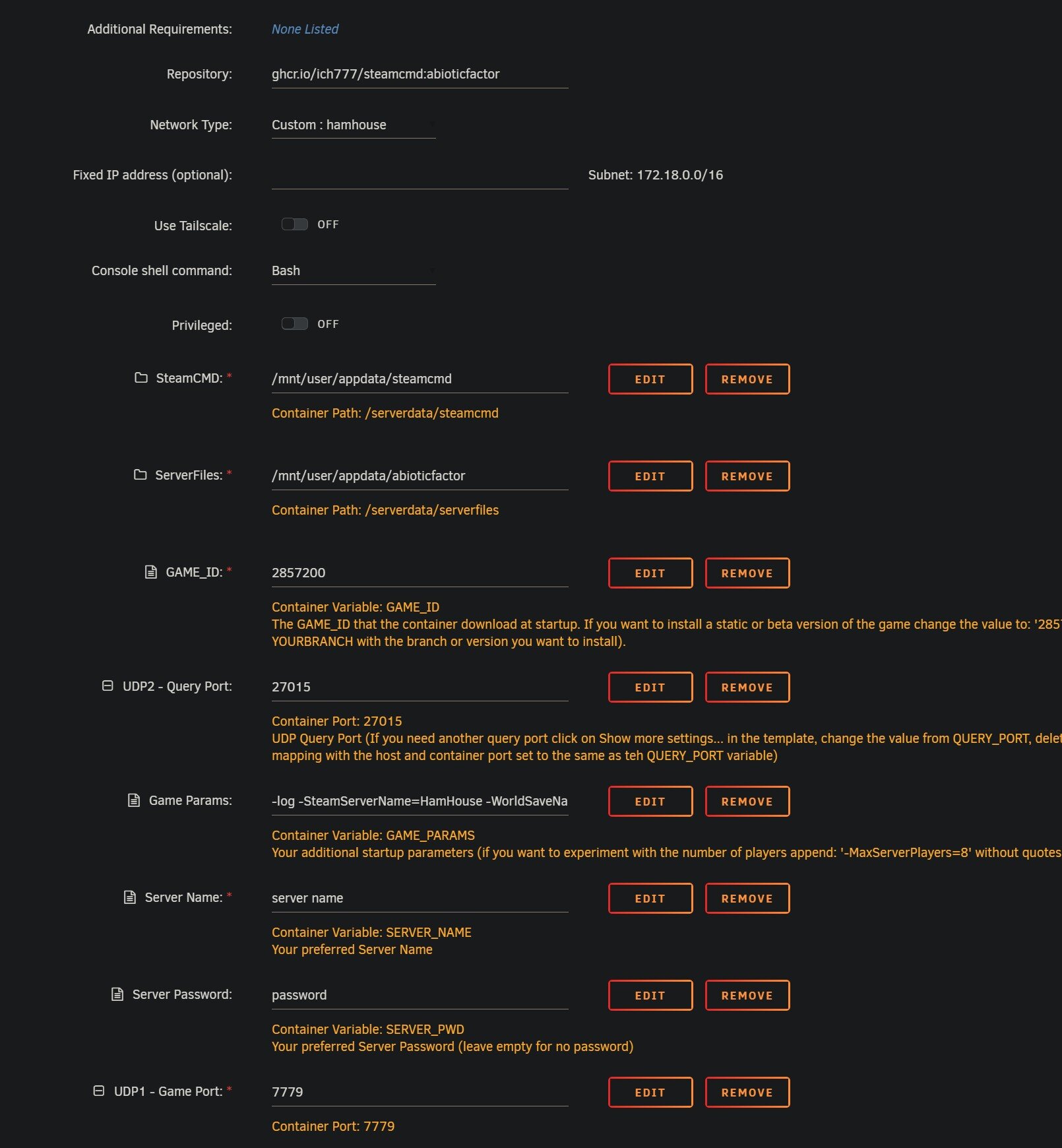

Noticed your not taking on any more requests for making gameserver containers. Big sad but I completely understand.
I was curious if anyone could help me spin up one for FOUNDRY on Unraid. I tried with ich777's image in github and set the gameid and all the parameters but it just spins up, says it downloaded the game files, then exits. Checked the app folder and there's no game files.
Anyone have any luck creating a FOUNDRY dedicated server container mind helping?
I've tried using this
https://github.com/ich777/docker-steamcmd-server
Images of unraid docker config attached
Container logs at the bottom
To be clear my toddler and work has me pretty sleep deprived so its very possible Im missing something obvious >.>
Logs-

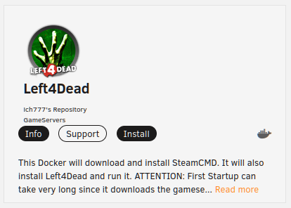

I'm having an issue with the Left4Dead 2 container.
It seems to me that it doesn't actually download any server files...
What I get is basically this:
14 hours ago, gagefox said:
Anyone know what could be going on?
I'll deprecate the container since it only gives troubles lately. Sorry for not having better news.
This is a known issue and it seems Valve wont fix the issue, sorry but this is another container that I have to deprecate.

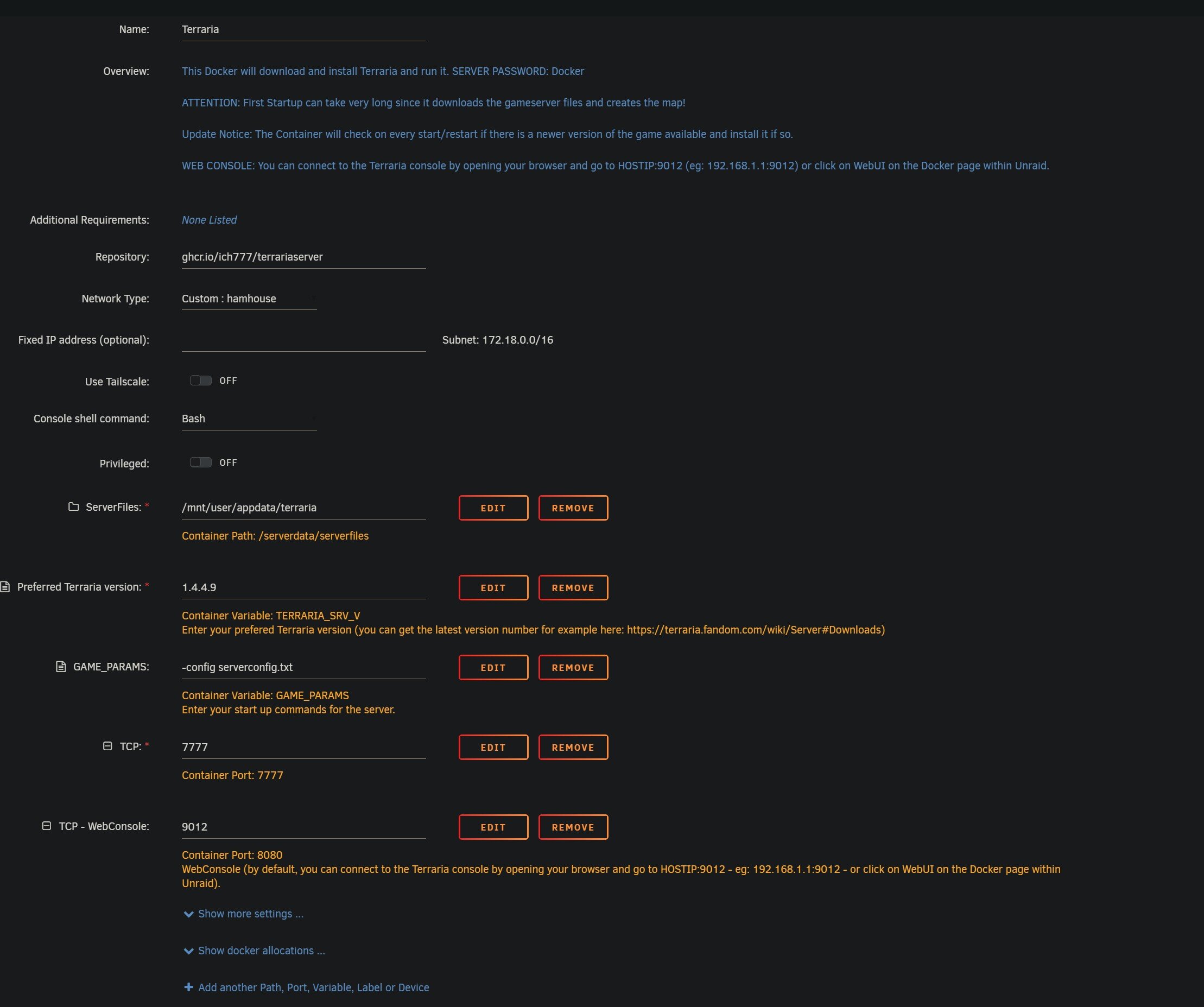

Hello Im having issues with the Terraria Server. Server runs and installs fine. When trying to connect to it, however, it says as per image and never connects. It just sits at this message. Logs show no anomalies, but I did change from port 7777 to 7779

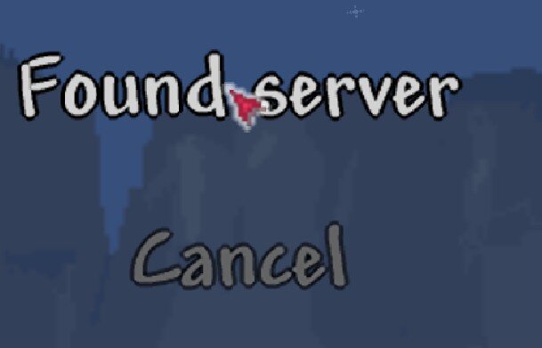

How did you change the port, a bit more information would be helpful and I don't know what your screenshot is.

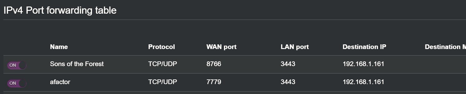

Hi I changed the port in the template. However, I have reverted back to the port 7777 and still find the same issue also with Abiotic. I feel it's a network issue. I have attached screenshots:
templates
router ports
unraid mappings
canyousee for port visibility
The original screenshot I posted is when you try to join the server.
Hope this helps clear the confusion
Edited by korefuji
Did you also change the port number in the server config file otherwise it won't work.
I did change the port in the config file. It might be a network issue, or i incorrectly mapped the port forwarding not sure about the latter but i can access other services on my other device
EDIT: I was able to fix as I assumed it was incorrect port forward mapping. Thanks
