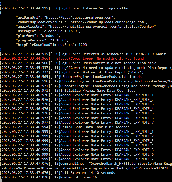

I stil cannot get my ASA conatiner to start if I try to use ANY mods. I have brands new container and image of the docker cont, the steamcmd and server files and newly downloaded mod files, all the config files are correct as well as command line, it just will not start up correctly.
Sorry but I can't support modding since this would be too much for me and, it was at least in the past, sometimes the case that broken/incompatible mods prevented the server start.
Maybe @Mainfrezzer can help.
Which modsystem are you trying to use? the build in one or AsaApi?
i belive its going to be AsaApi? as its done throught steam command in the command line/config files. it grabs listed mods and installs them first time you start the server after adding them then after it checks them for updates and loads them on server start if working correctly anyway, the stage mines gettin stuck at is after the update check and mod load.
Edited by Knight2339
3 minutes ago, Knight2339 said:
As i said previously the two mods where working before so I dont know why they would not now thats why I was asking incase something had changed on your side of things and I needed to re direct a folder path or something.
that not asaapi then, which mod ids are you trying to use?
must be the inbuilt one then, I took a stab at api because of the web address it shows on startup and it has api in it.image.png
as far as i know the mod id's are what curseforge refer too them as and the mod id's match up to the mods i intended to be using when it starts and the name pops up
something changed im just tryin to find out what it is
In no offence but nothing has changed in terms of the container.
The only things that could have changed are the game itself, since it will get updates sooner or later, or the mod got update or it got not updated and therefore it might be incompatible.
So to speak nothing changed in terms of the container and even if I push container updates these are usually only contain security updates.
I've had this happen. Try going to your mods folder (\ShooterGame\Binaries\Win64\ShooterGame\Mods) and deleting all the files to force the mods into a fresh install. That always fixed it for me.
