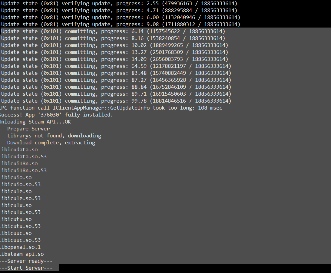

@ich777 I tried setting up an Ark-SE server this week from scratch and it just hangs my server. My cache drive that the docker is installed on maxes out and eventually Unraid is not accessible. I watched the docker log go through the download and then when it starts the server is when the usage on my cache ramps up.
Edit: I finally got back in to my server and this was the last bit of the log.
image.png Fin
Edited by rednick69
This seems perfectly fine, how much resources does the container consume?

1 hour ago, rednick69 said:
I'm not sure how to tell. The server becomes unresponsive after a couple minutes and I have to restart it. It could possibly be not enough memory. Do you know how much it takes to load the base game?
@ich777 I confirmed it was memory or lack there of. Thank you for your response. x
