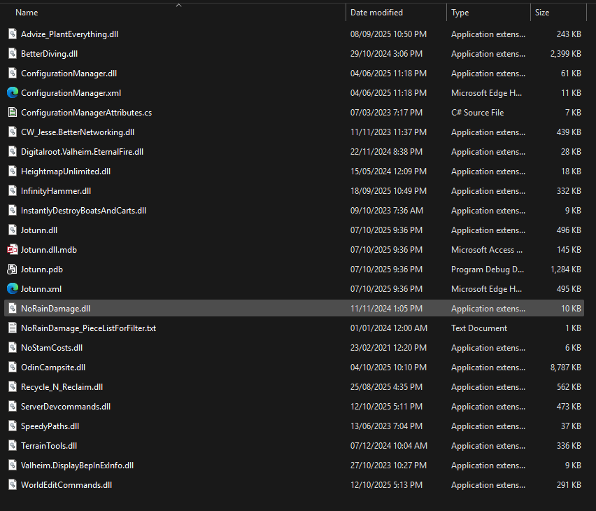

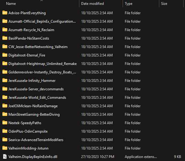

On 10/22/2025 at 6:24 PM, AussieSerenade said:
Hello @ich777 ,
Firstly Thanks for all your hard work, I am new to Unraid and Docker but have managed to get a V Rising and Necesse server up and runing with ease.
Im hoping you or the cummunity at large can help me with an issue I am having.
I have just setup a Valheim server container, and migrated all the data (world save, BepInEx Plugins, Plugin Settings ect) from my server that was running up until yesterday just fine in a Windows VM.
The container is loading as expected, however the mods are not loading as you can see from the BepInEx log here (2nd last line):
LogOutput
[Message: BepInEx] BepInEx 5.4.23.3 - valheim_server (10/22/2025 3:49:50 PM)
[Message: BepInEx] User is running BepInExPack Valheim version 5.4.2333 from Thunderstore
[Info : BepInEx] Running under Unity vUnknown (post-2017)
[Info : BepInEx] CLR runtime version: 4.0.30319.42000
[Info : BepInEx] Supports SRE: True
[Info : BepInEx] System platform: Bits64, Linux
[Message: BepInEx] Preloader started
[Info : BepInEx] Loaded 1 patcher method from [BepInEx.Preloader 5.4.23.3]
[Info : BepInEx] 1 patcher plugin loaded
[Info : BepInEx] Patching [UnityEngine.CoreModule] with [BepInEx.Chainloader]
[Message: BepInEx] Preloader finished
[Info : BepInEx] Detected Unity version: v6000.0.58f2
[Message: BepInEx] Chainloader ready
[Message: BepInEx] Chainloader started
[Info : BepInEx] 0 plugins to load
[Message: BepInEx] Chainloader startup complete
I have tried:
  • "Force Update" after deleting the file "BepInEx-5.4.2333" from the container.
  • Pasting the Plugins into the correct folder as they were in the windows version. (SceenShot Below)
  • Extracting the '*.dll' files and removing the sub folder structure. (SceenShot Below)
  • Removing the container and starting again
Extracted
Native
For now I will have the server active back on the VM (which Im hoping to retire) until I can (with your help) get the Docker container running with the mods loading.
Kind Regards
AussieSerenade
I have the same issue, did you find a solution?
In a discord someone said "bepinex had a major change around August of last year and all the docker containers required an update in what enviornment variables they set to enable it"
Edited by jamoky
