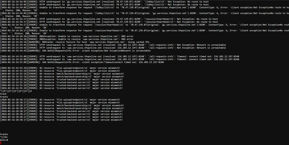

sadly, does not work for me. just error messages for me...
Is this the Log or the WebUI?
If it doesn't work anymore I can't do anything since they broke a lot in one of the last updates and since this is running through WINE this complicates things further.
Do you mean update for wreckfest or of some component?
Or is there an option with the console of the docker container to enter the console of the running cmd from wine?
Update for the dedicated server.
No, the container tries to open the console when you click on WebUI, however have you tried to enter commands in the console form the screenshot above. Maybe it works however, it was working back when I added that feature but over here I can't even get the container to work properly anymore.

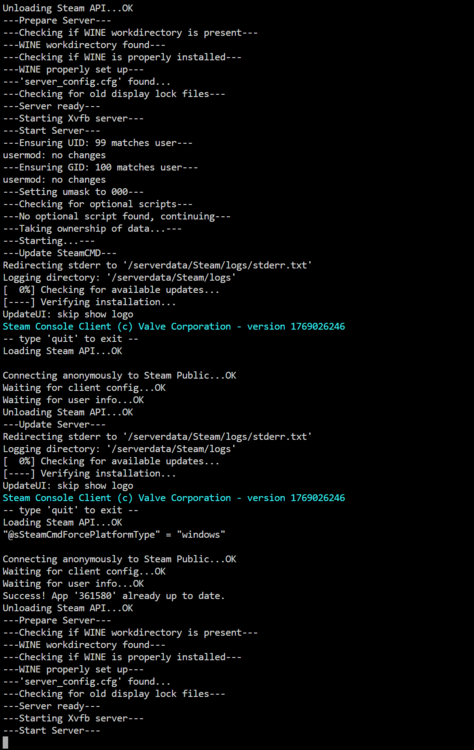

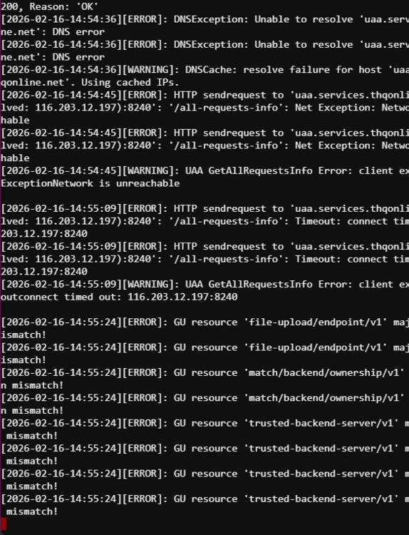

Thanks for trying. The first startup took forever. And it took several starts of the container until i could connect, but as far as i remember that happend on windows too.
If i can provide further information that could help, please let me know.
Here are two more screeshots, one form the logs of the container. And one with a bigger part of the webui window.
The container itself looks good to me. Exept for the Out/Input of the console...
If you don't have time, to support this old game any further just let me know.
Thank you for your efforts.
Yes, because the container downloads the game files on first start, that's pretty normal.
I still support the container but time is very limited. So to speak this will take some time.
However most of the times it should be enough to manage the server through the game or at least for now you have to do it that way since if you add your SteamID as the server owner you can do that when joining the game.
