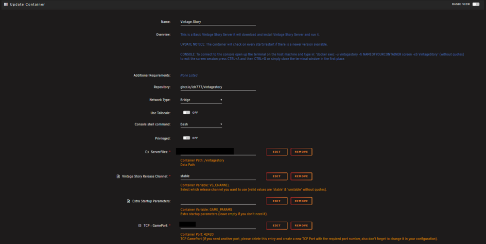

7 hours ago, oogasplada said:
I see this has been requested before and you said you would take a look at it but nothing more has been posted.
That's already possible by creating the Variable with the Key: STATIC_V and as the value you define the version that you want.
Newer templates should already have this variable, this is the description from the variable in the template:
If needed set a static version to prevent the container from updating (eg: '1.19.7' without quotes). Leave empty for automatic updates.
  • Replies 12.6k
  • Views 2.3m
Do I need to remove the "Vintage Story Release Channel" variable if I add that? I guess I have an old template.
No, just leave it as is.
BTW you don't need to hide anything in a template (except for passwords and sensitive variables), there is no value in doing that.
