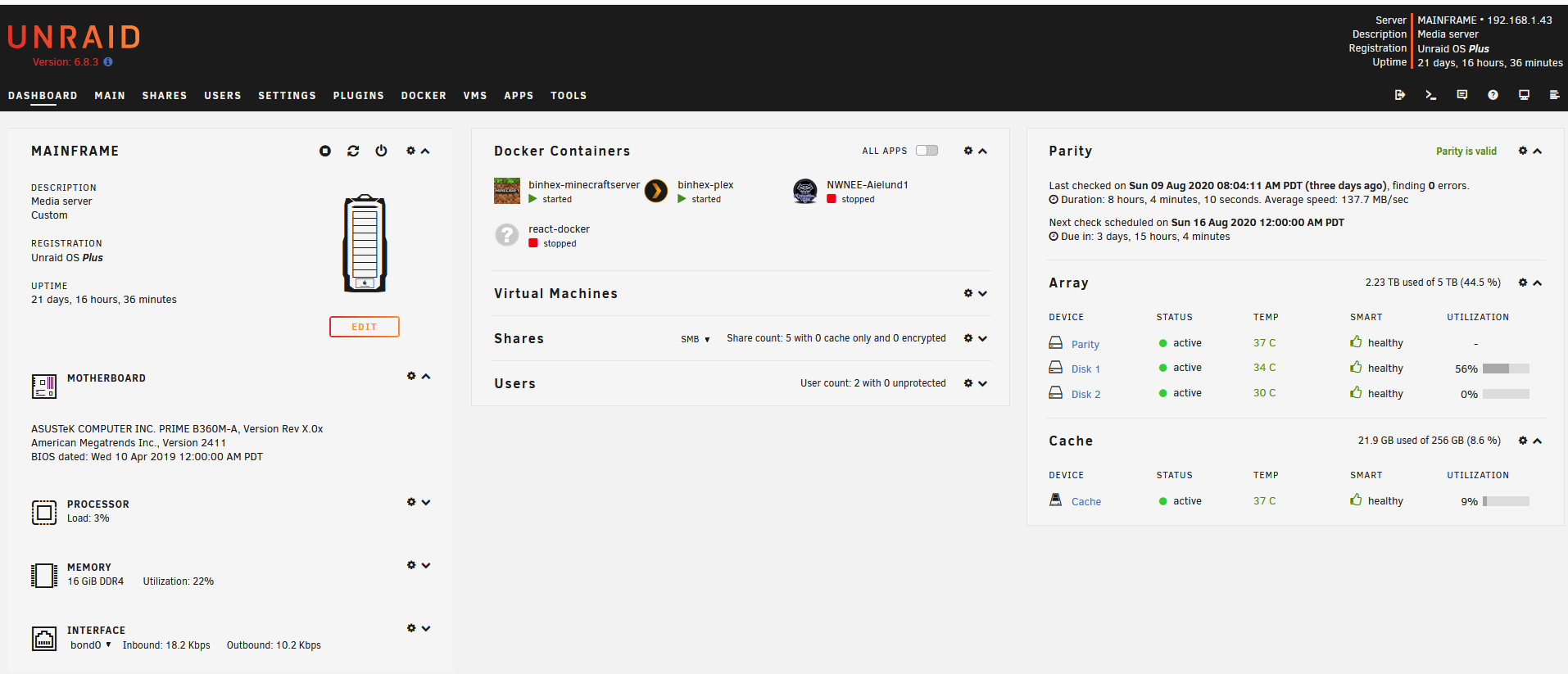

I'm using 6.8.3, and I have a 256gb nvme drive setup as the cache drive.

Is the path to the ServerDirectory /mnt/user/appdata/... or /mnt/cache/appdata/...

/mnt/cache/appdata/nwnee

Try to change ot to /mnt/user/appdata/nwnee

Now it's stuck in a loop trying to start up.

Can you edit your post and shorten the log output, it's always the same because it's looping.
Can you delete the whole container and also the folder created in your appdata?
I will try it on my 6.8.3 dev server if I can reproduce the error.
Container now fixed, I think they also made it necessary in a recent version to have the library 'libsndio6.1'.
Please update the container, but I would recommend that you delete it completely and also the created folder in the appdata directory and redownload it from the CA App.
I also attached a log from my dev machine that runs on 6.8.0 (I made a few empty lines after it says that no modules are found because I simply put the module in the folder and restarted the container).
Tested it with 'Contest Of Champions 0492':

Have you changed something in the template itself?
On which Unraid version are you? Have you installed a cache drive in your system? Can you try to change the 'ServerFiles' path to '/mnt/user/appdata/l4d2' (stop the container and delete the old folder for left4dead in the appdata directory befor doing that...)
