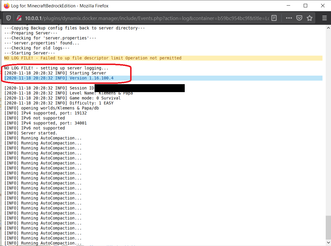

HI @ich777. We have really enjoyed getting back into Minecraft thanks to your excellent MincraftBedrockEdition docker. We owe you a big THANKS!
One small question:
I have Game Version set to "latest" so I think that means it should be on bedrock-server-1.16.100.04. But it is still loading a previous version (bedrock-server-1.16.40).
Is it possible for us to update to the latest server ourselves or do we need to wait for a docker update from you?
Many thanks!
One small question:
Many thanks!
Just restart the container, it should update itself.
My containers update the application on each start/restart of the container itself (I take have a differnt approach to the updates than most container developers).
EDIT: I checked it on my Unraid box and the container updated itself:
That did it!!! Thanks so much!
