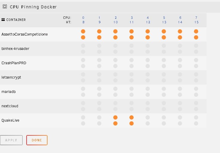

"How many cores have you assigned to the ACC Server docker?" ----- ALL - 8 CPU and 8 Threads.

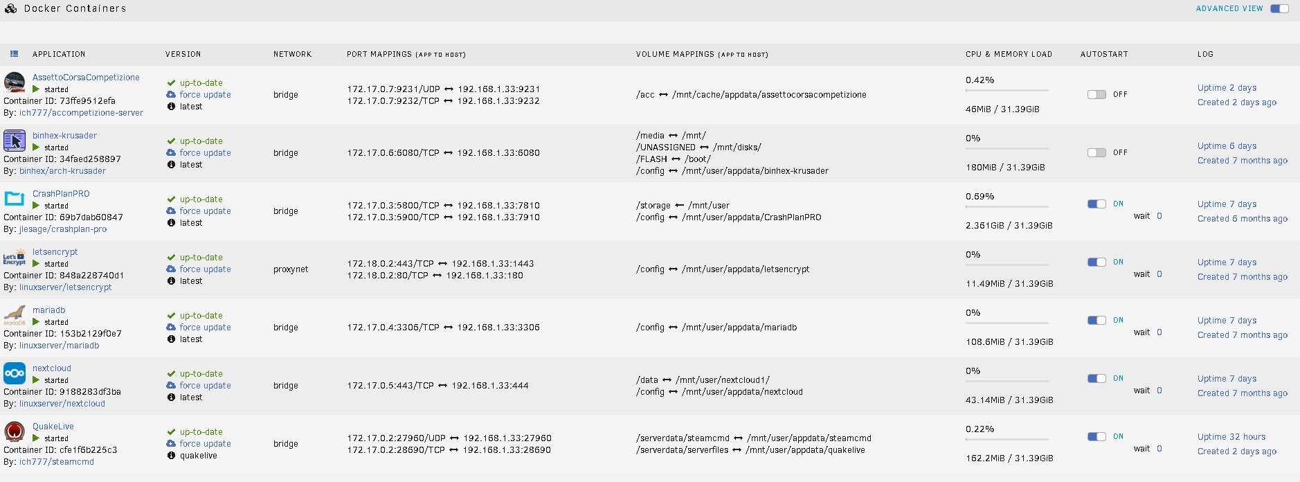

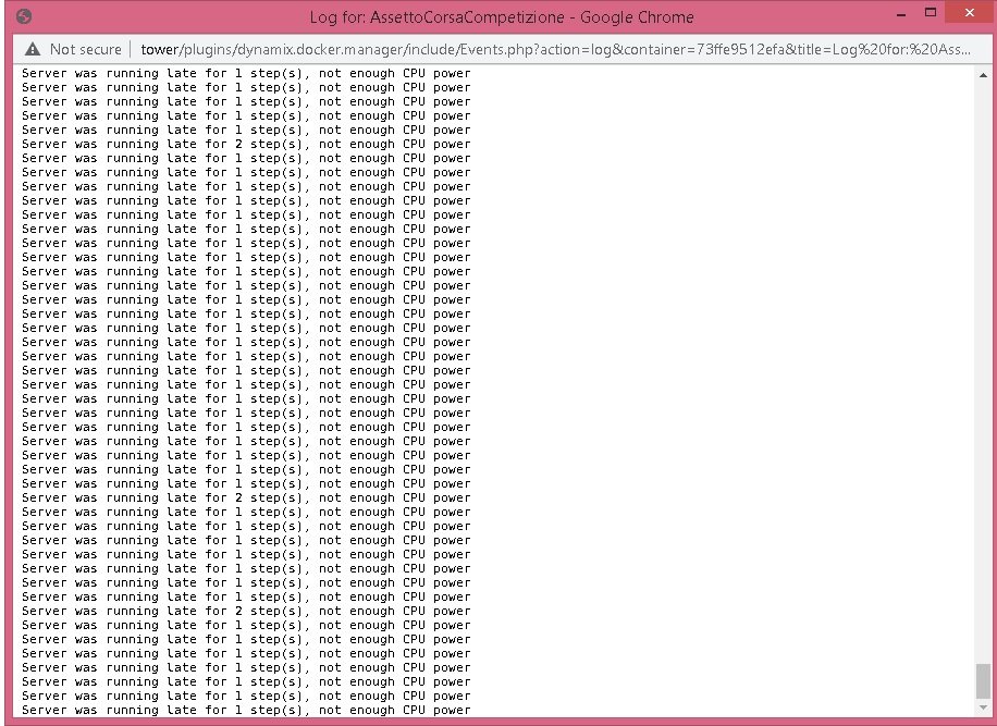

I would recommend you to not pin any cores if you want to use all cores...

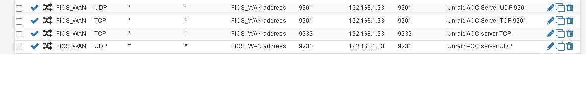

What are these other two entries? 9232 and 9231?
You can also forward TCP and UDP at once in pfsense instead of making two different forwardings...
That was my initial setting (no pinning) before I posted my issue but Nelinski advised assigning the cores, unless I did it incorrectly.
9232 and 9231 are working ports in the win 10 server version I am running and since i was not getting tcp communication on the unraid I added those in too.
I was thinking that about the tcp and udp together rule.  ty

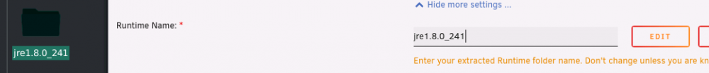

7 hours ago, GyroDragona said:
I am running Paper on both containers but it seems paper is going to be cutting of Java 8 support and moving to the next LTS version of Java 11
I don't know if it would break something if I upgrade it in general so that the container always pulls Java 11 (jDownloader would completely break if I do that - also uses this runtime).
But of course you could do this:
Download the version of java that you want to use for (Linux 64bit!)
Got to your Minecraft folder in your appdata directory and open the runtime folder and delte this folder: jre1.8.0_241
Extract the downloaded into the runtime folder
Go to your template, click on 'Show more settings' and change 'Runtime Name' from 'basicjre' to the exact folder name that lives in your runtime folder
The server should then use the new java version, below is an example but for jre1.8.0_241 just as an example.

As soon as I change "Runtime Name" it breaks the server. Even if I change it back to "basicjre" It will refuse to fully boot anymore even when it is the only change that is made to a already working server. I can't seem to figure out why. I'm doing it with a fresh Docker setup.
logs.txt
latest.log
The logs and screenshot are after I changed the setting back.
