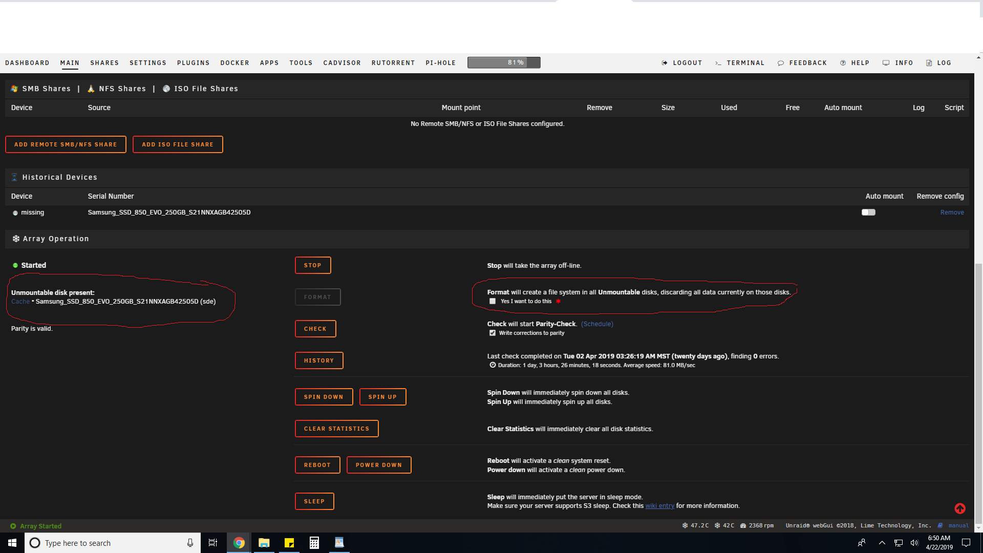

Please confirm if that is correct. I already have CA/Appdata Back running once a week so I should be good there when it comes to restoring my appdata correct. Now I took the server offline and unmounted my cache drive and then remounted it. When I start the array up I get this do I check the format box and format???
If you have all the data you need from cache you can format, if not see here for some possible ways to recover.
Thank you for your help I am back up and running.
