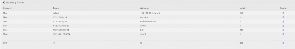

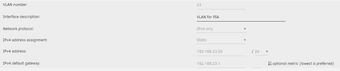

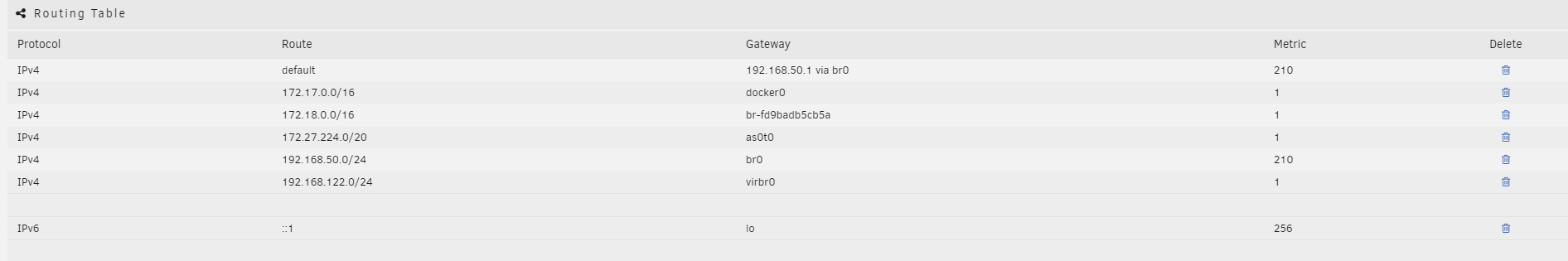

Do I need to have settings on my router too? I thought setting it up via unRAID this way it did all the routing through unRAID and it doesn't require specific hardware? Something still isn't working. Here's some screenshots of the setup.
But the tunnel doesn't start up in the VM and I can't ping anything.
Route info
VLAN info
