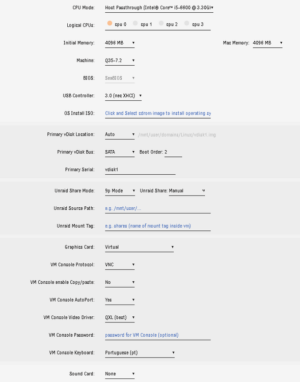

Hello!
Sorry to reach this grave topic, but i need one help.
I want to install chromeOS flex or fydeOS, but i'm struggling to boot with this.
I don't understand why is so complicated to boot something on VM's with Unraid.
I have this configuration above on my VM:

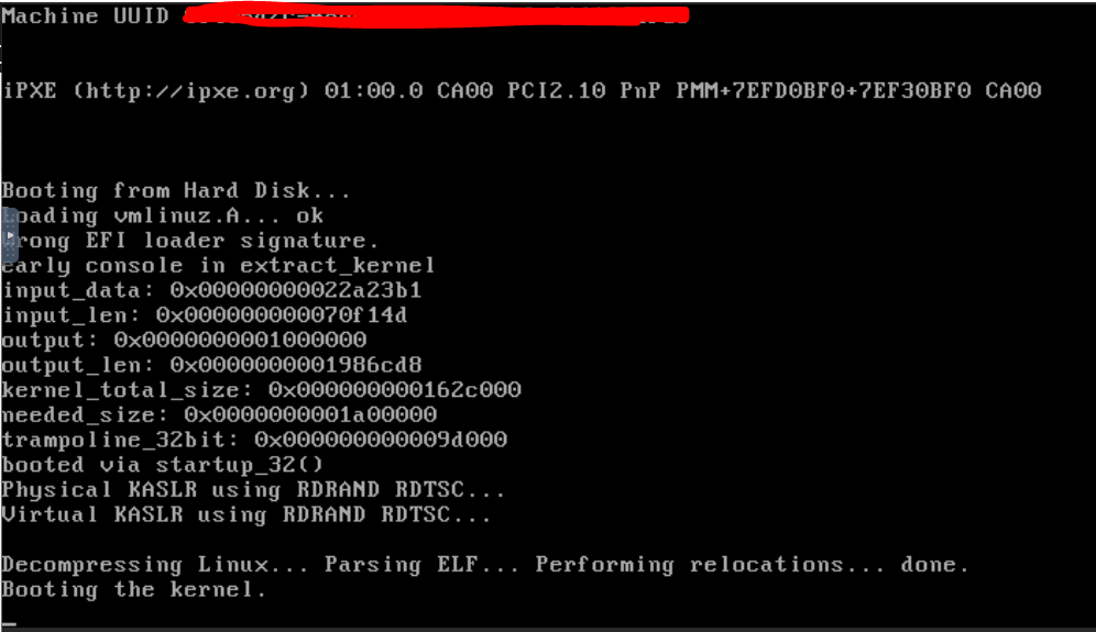

When i boot from that USB that i created with Balena, i'm stuck on with this image:
I already tried ChromeOS, and changed all the possible configs and the result os always the same.
I already changed Machine from Q to i, Bios type, usb controller primary vdisk bus etc.
I just want to boot FydeOS from my USB and install it on a 10GB partition. After this remove usb drive, and boot from disk and start using.
What's the problem with this?!
P.S.- If i removed the usb drive and connect to my laptop, i can boot without any problems.

Can you paste here some images from VM configuration.
I already tried this, but without success, and i think something i missing from my side.
Thanks in advanced.
