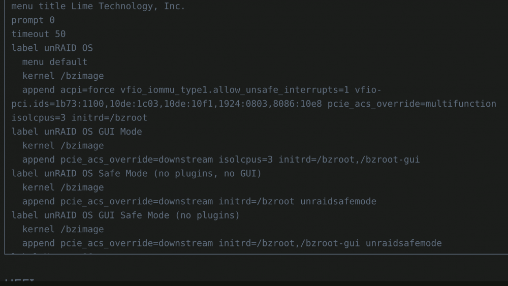

You didn’t put in the unsafe interrupts correctly. I’m your example you have appended repeated after it (remove) and in the syslog it doesn’t even show up.
Im attaching an image of mine with some other stuff in it you don’t need to worry about for reference.

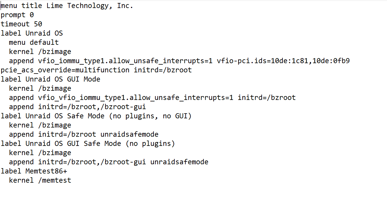

Attached below is what I have now; is this correct? Where it says pcie_acs_override=multifunction is on the same line as the interrupts, just with a space between them (notepad shifted it down a line for this screenshot).
Edited by Redline9000
It looks like that has worked, the VM now starts :D
Is there any other part of that file that I need to change? I've noticed the IOMMU groups have changed location but all appears to be working oka
if you don't have issues with iommu groups and passthrough, then you don't need the multifunction text. otherwise you should be good to go!
