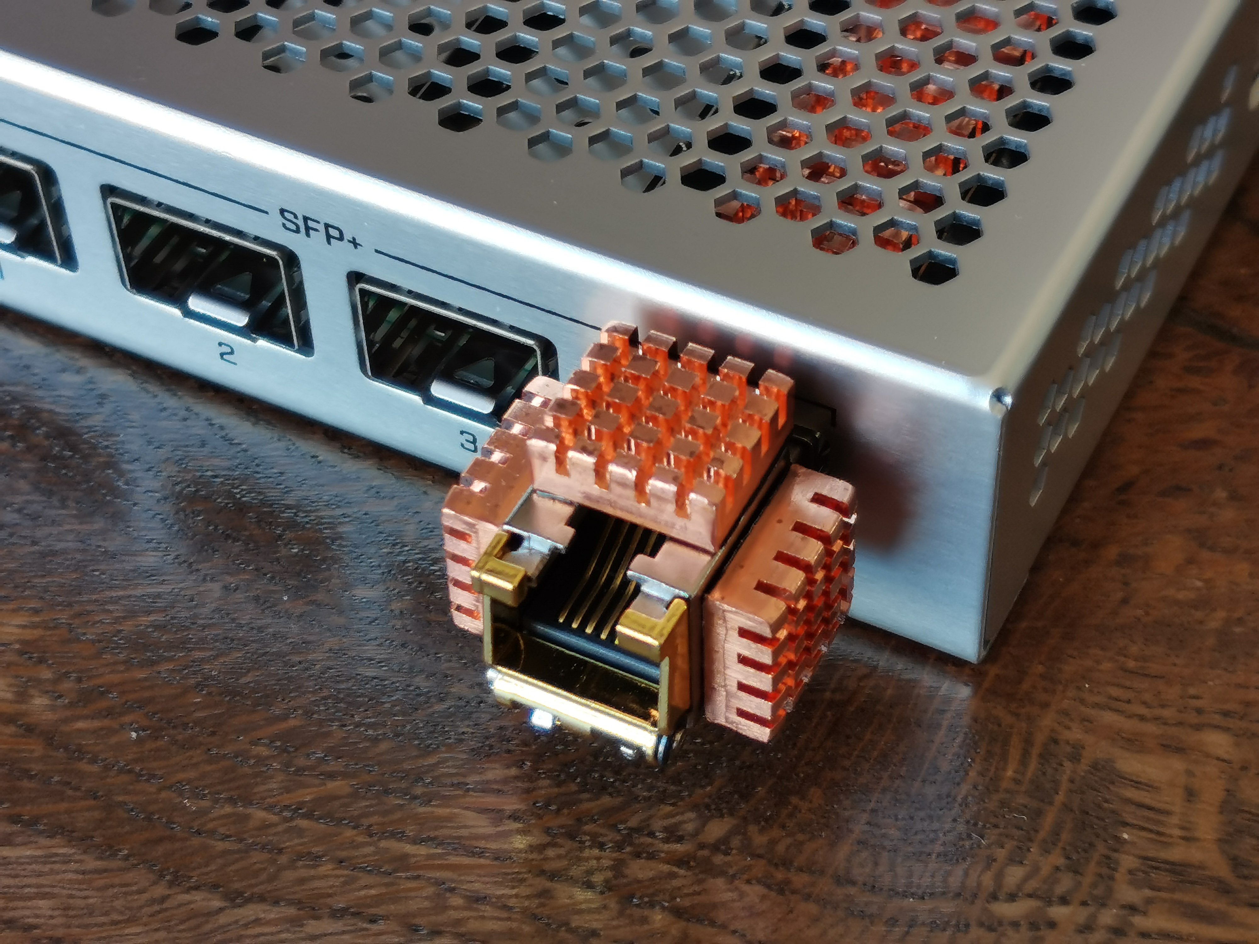

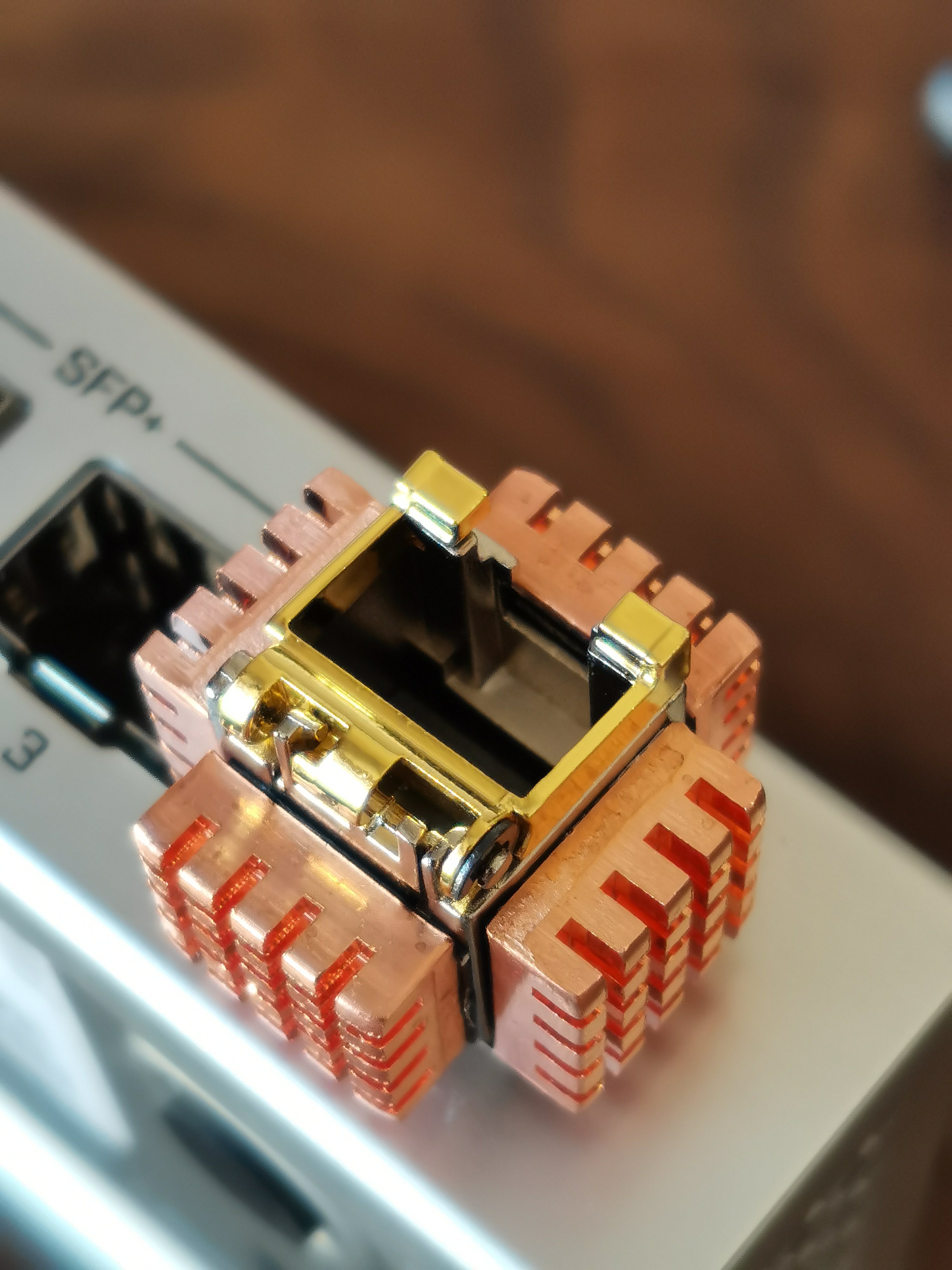

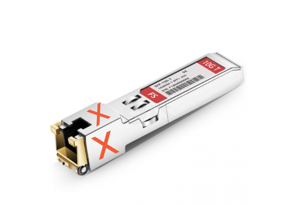

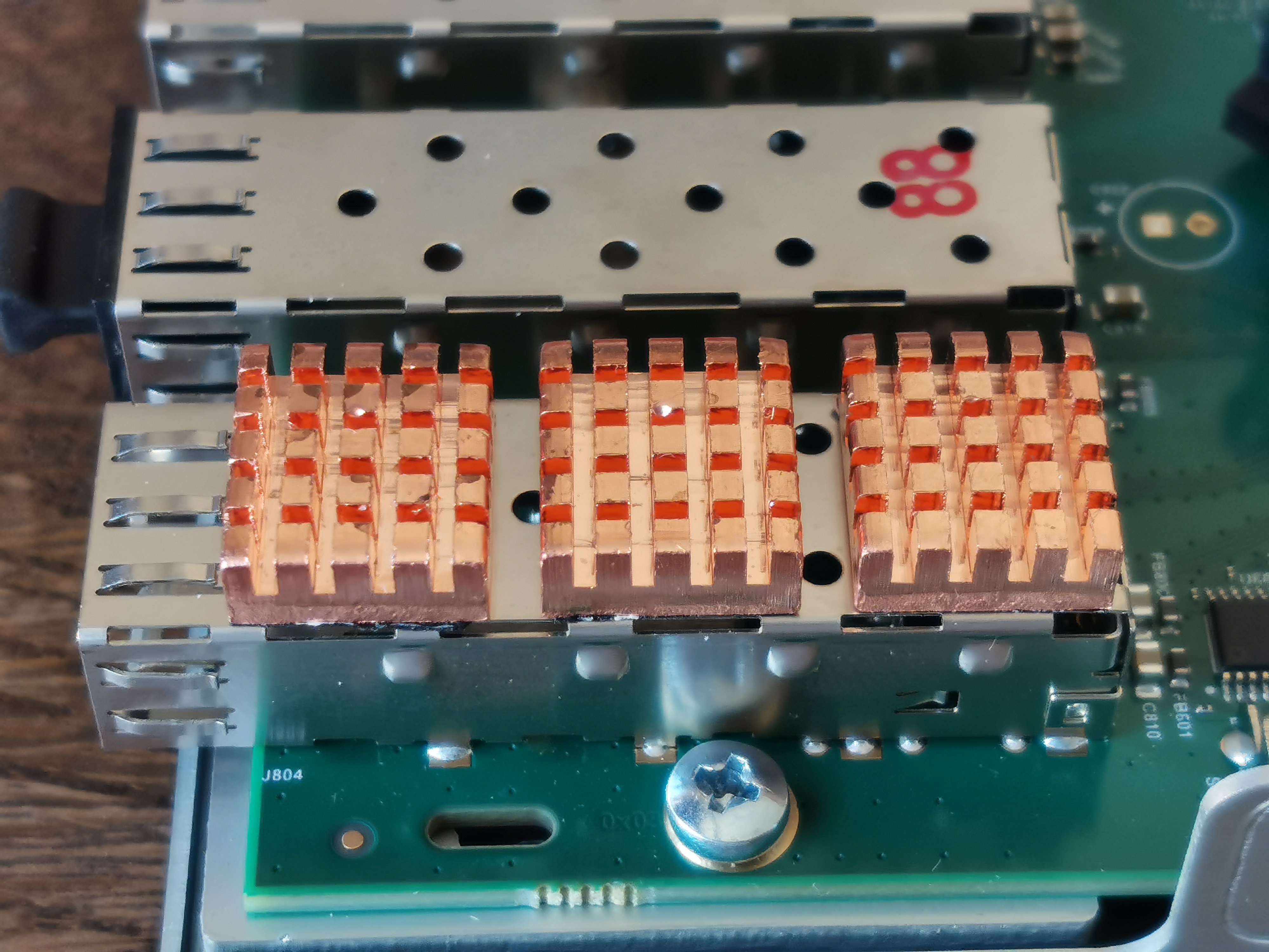

March 29, 20206 yr Author 5 hours ago, uldise said: have you some link on this? amazon has a few https://www.amazon.com/Heatsink-Cooling-Stepper-Regulators-Raspberry/dp/B07V9XDJNF/ref=sr_1_4?keywords=heat+sink+kit&qid=1585487921&s=electronics&sr=1-4 https://www.amazon.com/gp/product/B082RWXFR2/ref=ppx_yo_dt_b_asin_title_o00_s00?ie=UTF8&psc=1 the flat area on my 10gbe rj45 transceiver is 15mmx13mm on top and 15mmx12mm on the side so I looked for kits that wold have something to fit there.. Shortly after posting that update, I rethought about which kit I bought, cancelled the 7 dollar one and went for the 16 dollar 100 piece kit because.... well, "sheltering in place" is going to become "put heat sinks on everything to fight boredom."
March 29, 20206 yr 1 hour ago, 1812 said: the flat area on my 10gbe rj45 transceiver is 15mmx13mm on top and 15mmx12mm interesting, where do you plan to fit them?

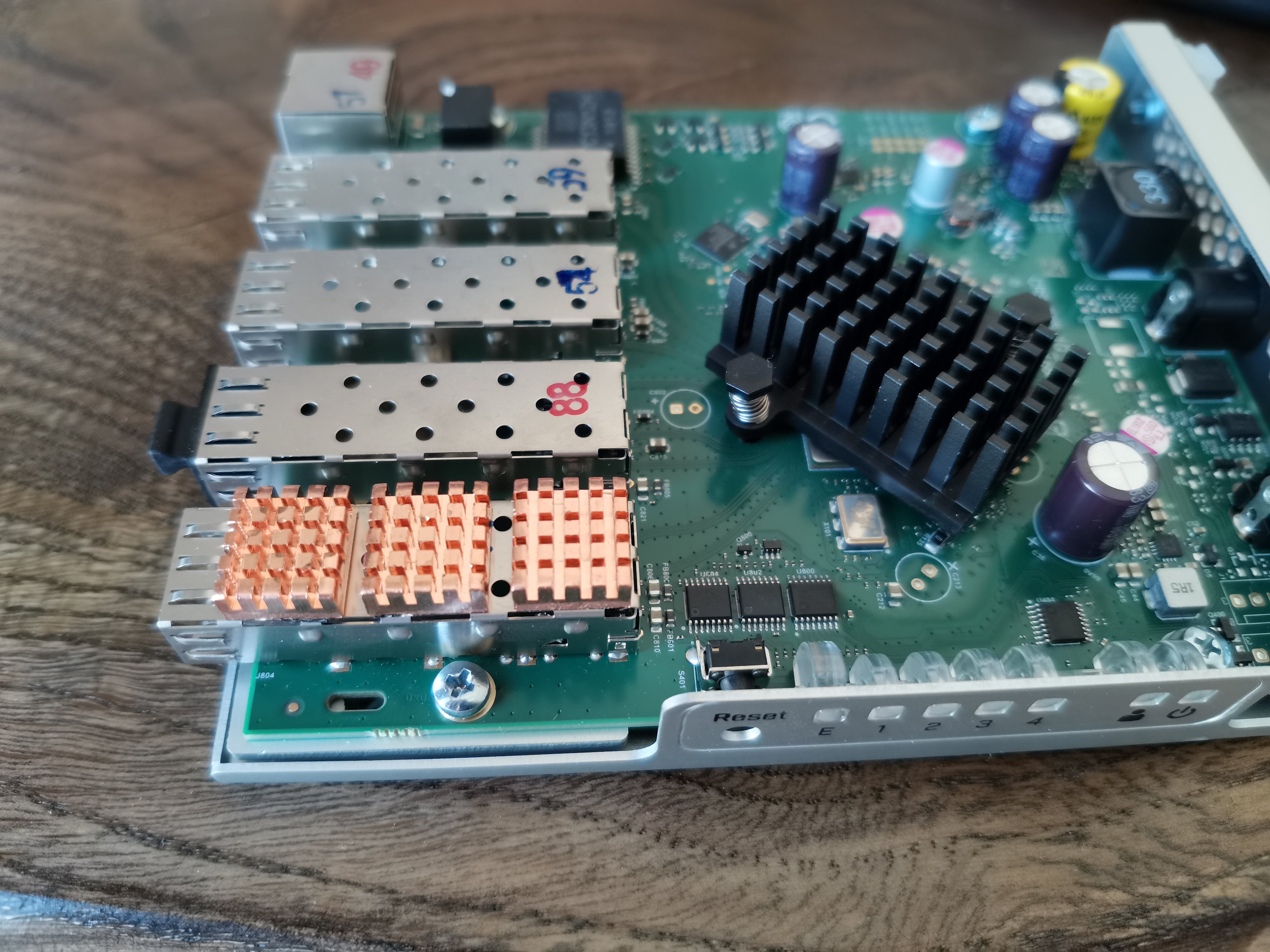

March 29, 20206 yr Author 1 hour ago, uldise said: interesting, where do you plan to fit them? I'll just stick them on the top and on the side (x marked in the pic below). they are operating within spec range, though towards the top end. Worst case I'm just making them more "Mad Max" themed in appearance. Best case I might get some longevity that I would have otherwise lost. If I have space in the switch I may add some to the sfp+ ports as well, as shown in the second picture denoted by a circle. too much? maybe, but also trying to keep myself busy and I don't see how it could hurt.
March 29, 20206 yr 22 minutes ago, 1812 said: too much? maybe, but also trying to keep myself busy and I don't see how it could hurt. i'm asking cos i'm using Active DACs with Mellanox PCIe card in my server - i changed 1M to 2M Active DAC recently, and right after a few minutes of work, port started flapping.. i resolved it by adding one more fan inside a case to low directly to PCIe zone. i'm wondering, maybe additional heat-sinks on ports would help a bit more..
March 29, 20206 yr Author 28 minutes ago, uldise said: i'm asking cos i'm using Active DACs with Mellanox PCIe card in my server - i changed 1M to 2M Active DAC recently, and right after a few minutes of work, port started flapping.. i resolved it by adding one more fan inside a case to low directly to PCIe zone. i'm wondering, maybe additional heat-sinks on ports would help a bit more.. its a 10 dollar try it and find out! If it stopped after the fan, then heat would appear to be an issue.

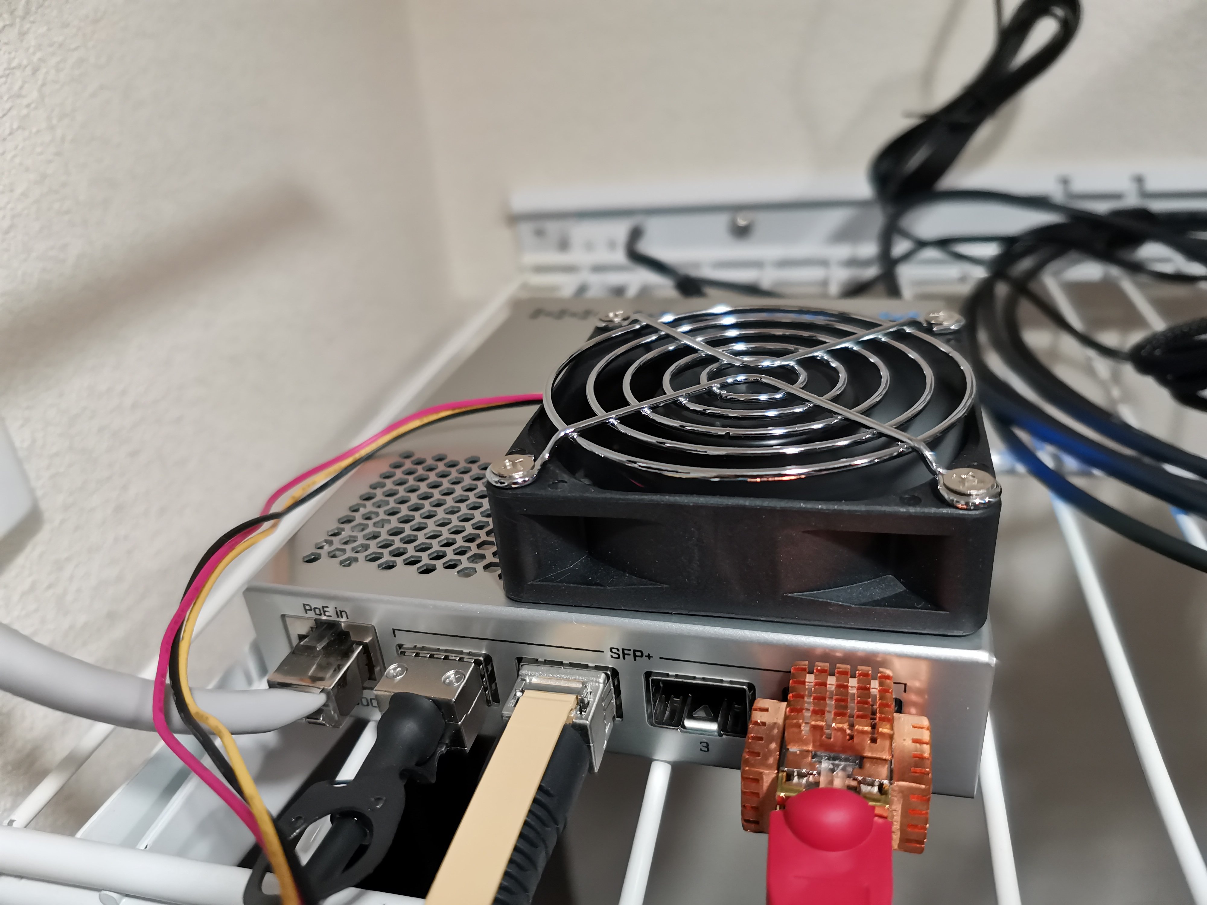

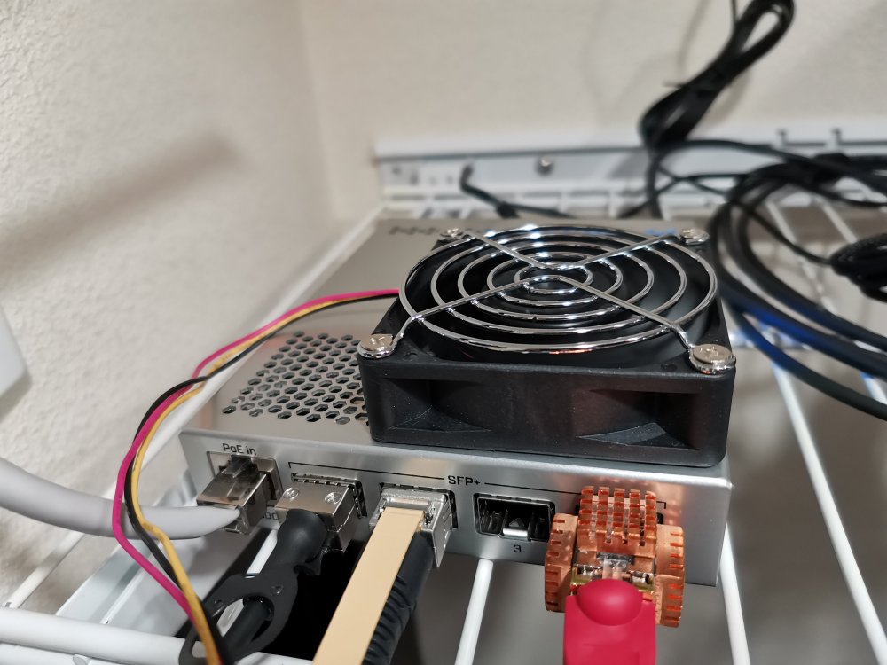

July 16, 20206 yr Hello everyone, Had temrerature issues with CRS305-1G-4S+IN and Mikrotik S+RJ10 transciever, so I also decided to add copper heatsinks as you were talking here. With such heatsinks temperature of S+RJ10 transciever droped from 85C to 80C only. So I have ended adding 5V USB-powered silent fan at the top of the switch and temperature is now 63C. If not using optic fiber, fan is only good solution for 10G speeds with CRS305-1G-4S+IN. Edited July 16, 20206 yr by syrup
July 16, 20206 yr Nice mod, I use one of these in my server cabinet, use all the ports and have no temperature issues and that is due to using fibre?
July 16, 20206 yr Yes, SFP DAC cable or fiber transceivers use 3-4 times less power. If you need RJ45 10G connection then transceiver will go to ~90C temperature and you need active cooling. https://wiki.mikrotik.com/wiki/S%2BRJ10_general_guidance
July 16, 20206 yr 8 minutes ago, syrup said: Yes, SFP DAC cable or fiber transceivers use 3-4 times less power. If you need RJ45 10G connection then transceiver will go to ~90C temperature and you need active cooling. https://wiki.mikrotik.com/wiki/S%2BRJ10_general_guidance Thanks for the tip!!

May 9, 20233 yr My hottest port is at 85° so I wanted to try a fan. These fit over the grill nicely but they slowly got louder and louder. Dual 40mm USB Fan I tried adding a pot and ran them as slow as I could but they still had a whine. USB Fan Governor I got this Noctua fan and so far I can not hear it and so far all the ports are 20-40° with the pot on the lowest setting. Noctua NF-A8 5V PWM Edited May 9, 20233 yr by Tanquen
