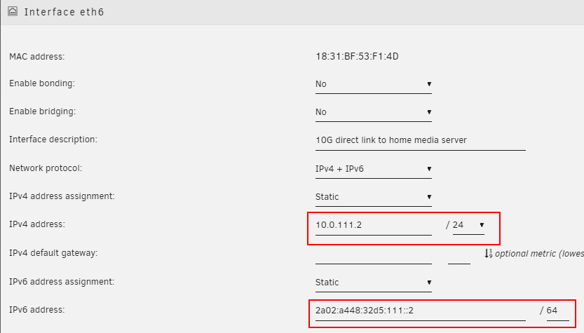

This is my test server
It has a bonded interface with 4 members (eth0/1/2/3). It has two currently unused gigabit interfaces (eth4/5) and a direct 10G interface (eth6) for server to server backups.

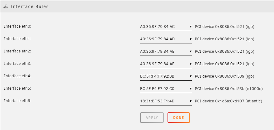

17 hours ago, Marshalleq said:
1 - Assign any interface to any user chosen network designation in the system e.g. ETH0/1/2
Already possible.

Again, eth0 is the management interface. This interface requires a default route otherwise the system is unable to communicate with the outside world and things like system upgrades and plugin/docker installations aren't possible.
You can use "Network Rules" to change the interface assigned to eth0 (or any other interface for that matter).
