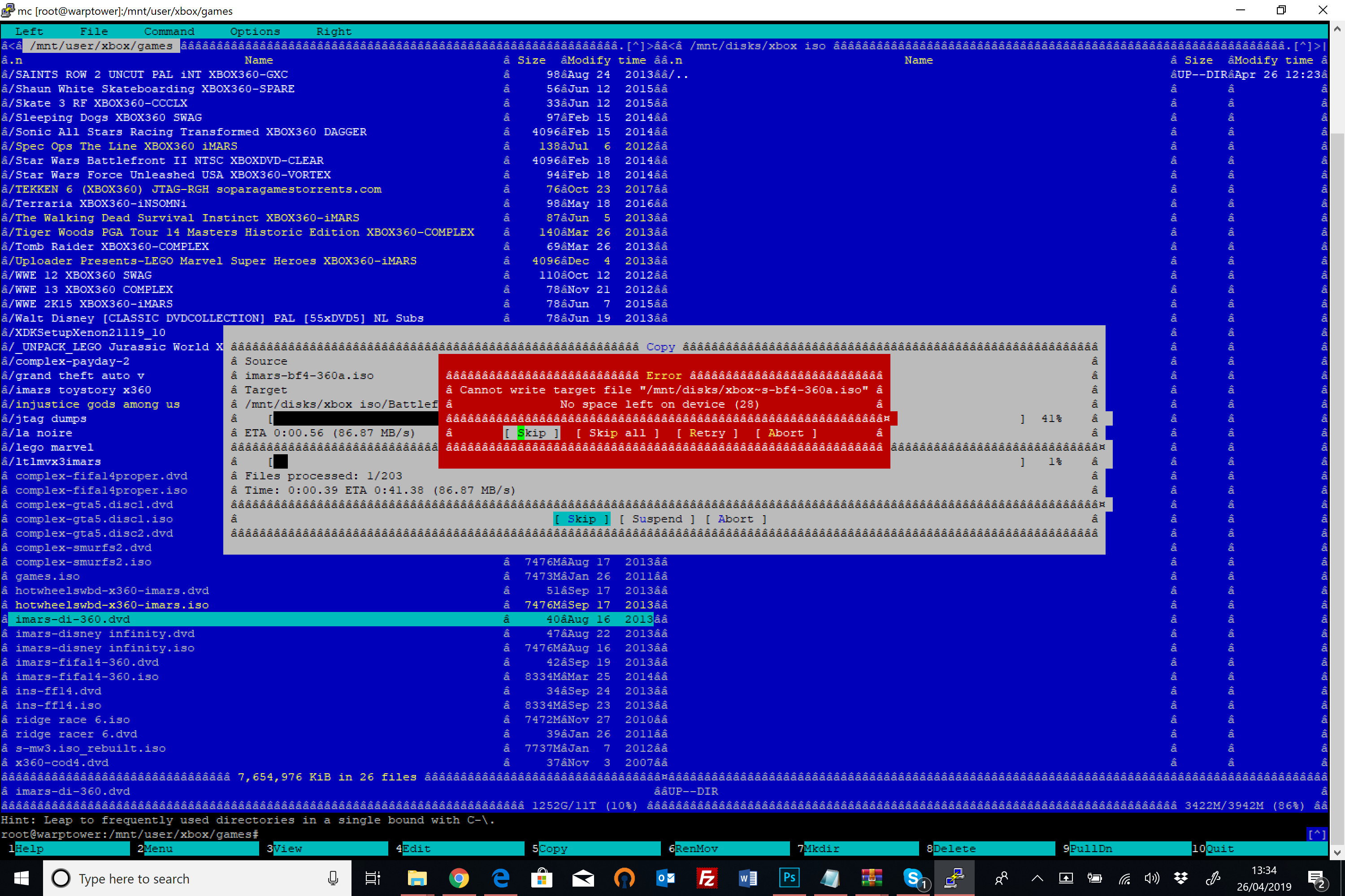

I am copying lots of 5-7gb files from my server to an unassigned device, im using MC to do it but its getting to 41% on every file and saying not enought space on device (28), i googled a bit and from what i can make out the files are being passed through a tmp directory on the flash drive and this is what is filling up ?..how can i fix this ?

I lterally googled "mc no space left on device (28)"

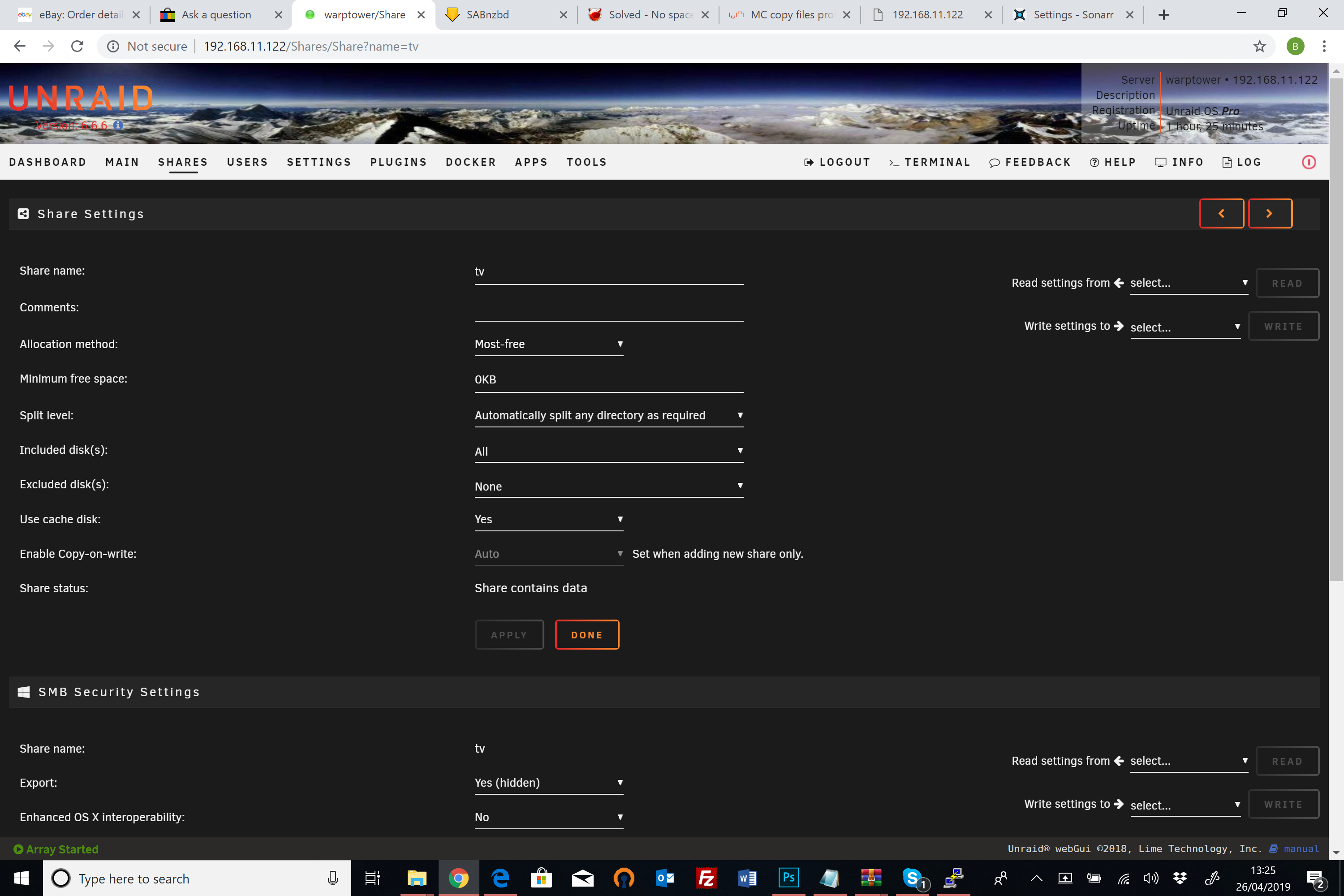

no, its set to 'yes', just checked it, i assume you are talking about the TV share ?

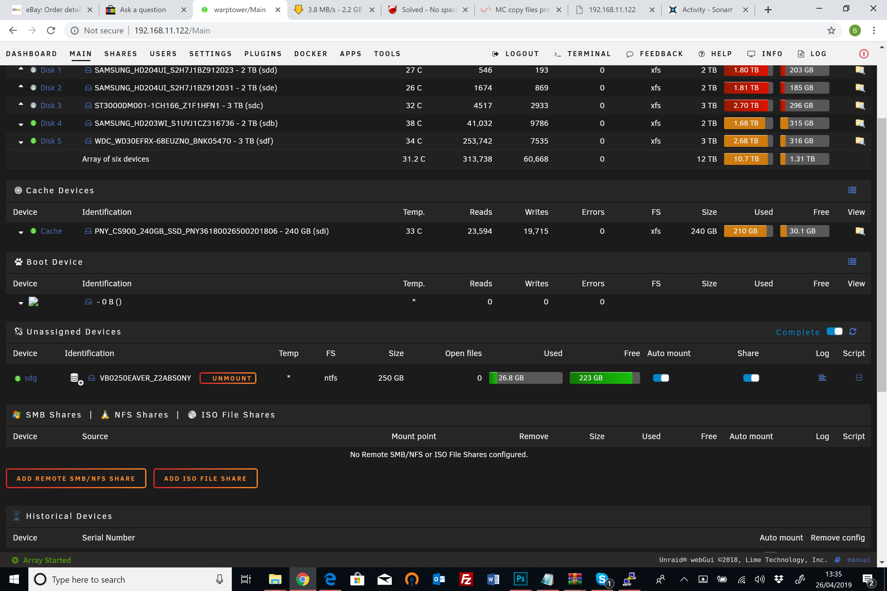

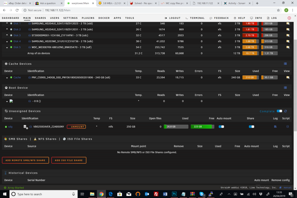

so as you can see, unassigned device is present with loads of space, i have deleted some files from the cache, the TV share was set to use cache 'yes', just tried to copy files again and it has stopped at 41% with same error
The diagnostics you posted showed no Unassigned drive mounted.
You might want to go to a console prompt and type the ‘df’ command.   The Unassigned drive should show up there as a mounted device with a path starting with /mnt/disks.   If it does not then any attempt to write to it will result in writes to RAM regardless of what the GUI is saying.
I was talking about the downloads share, since that is what is filling your syslog with messages about cache full.
And filling RAM would be a good explanation of why it says that path is full.
Well that seems to have sorted everything. I wondered why I was getting write speeds of 124mbs.
