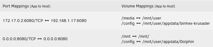

Hello
My USB disk is mounted under /mnt, but it does not appear with Krusader, while it displays with Dolphin
Where is the problem ?
Thanks for your help

What path mapping do you have set for the Krusader docker?   That is likely to be where the problem lies.   You might want to compare it to that set up for the Dolphin docker you says is acting as expected?
Hello
Here are the port mapping, they have been positioned by default
Louis
Hello
I found
I added the path: /mnt <-> /mnt /
