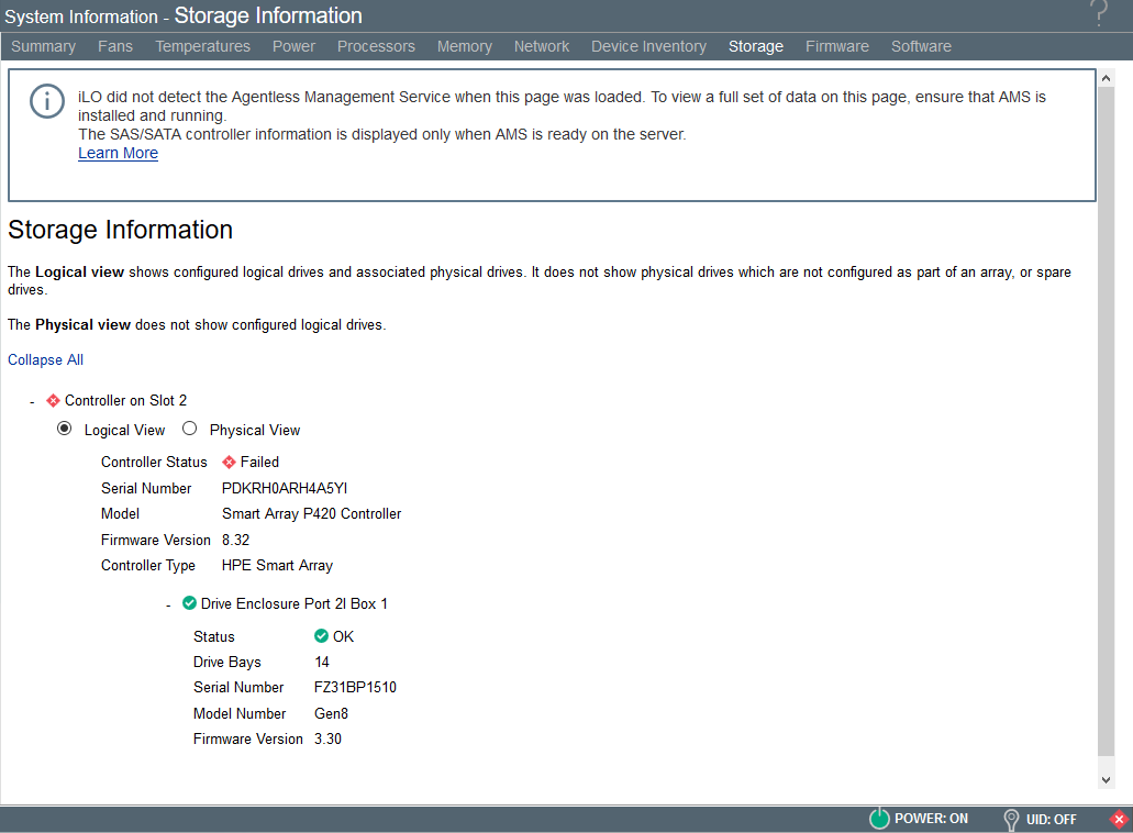

I have seen something fishy in iLO's health log already.
See this bit and the screenshot:
BIOS/Hardware Health section reveals this:
1108 <CRITICAL> PCI Bus 04/29/2019 20:35 <INIT UPDATE: 04/29/2019 20:35> <COUNT: 1> Uncorrectable PCI Express Error (Slot 2, Bus 0, Device 3, Function 0, Error status 0x00000000)
1107 <CRITICAL> System Error 04/29/2019 20:35 <INIT UPDATE: 04/29/2019 20:35> <COUNT: 1> Unrecoverable System Error (NMI) has occurred. System Firmware will log additional details in a separate IML entry if possible
1106 <CAUTION> POST Message 04/29/2019 20:34 <INIT UPDATE: 04/29/2019 20:34> <COUNT: 1> POST Error: 1805-Slot X Drive Array - Cache Module Super-Cap is not installed; IMPORTANT: Unsupported Configuration: Cache Module cache functionality is limited. Action: Install the Super-Cap to remove these limitations.
Storage section:
tower-diagnostics-20190429-2048.zip

You’re cache is missing a battery or is faulty.

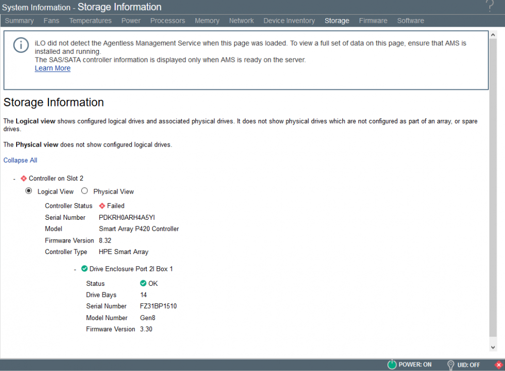

I have good and bad news.
Bad news: Can't run the P420 without cache module apparently. (Source)
(Smart Storage Administrator in iLO returns a fatal error stating P420 is disabled due to the unattached cache module.)
Good news: With unRAID fully booted the server is MUCH less noisy without the cache module. (sweet sweet 32-54% fan spin!!! Wouldn't mind less during practically no load at all other than an idling unRAID with the P420 disabled even, but I'll take it over 100% any day of the week!) So since the P420 is disabled right now at the very least, I now know that the card needs addressing and there isn't really anything else getting in the way.
Unless I'm missing something here and there's a trick to get the P420 to behave and have it ignore that it's designed for caching use. :P
Update time...
Good news: The super cap had been in there all this time - just not connected. So I plugged it into the P420 cache module and lo and behold it now remains activated, still not working though, because...
Bad news: the fans spin at 100% again, just like before.
I'm also still getting this error in unRAID:
Tower emhttpd: device /dev/sdb problem getting id
As for cooling settings, it's set to Optimal which is the smallest setting. Found it in BIOS, forgot that I had long set it to that.
HBA card H220 solved my issues all around. It's a shame you can't put a nice card like the P420 to good use, but that's what it is.
Happy I got it working and am now in well supported territory rather than sketchy hacking around to be frank. :)
