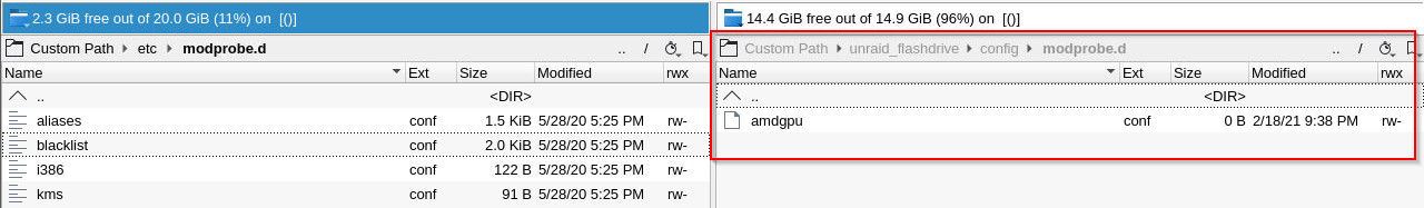

January 4, 20215 yr Seems that in the 6.9.0 beta35 release they have included amdgpu drivers. Check Quote New in this release: GPU Driver Integration Unraid OS now includes selected in-tree GPU drivers: ast (Aspeed), i915 (Intel), amdgpu and radeon (AMD). These drivers are blacklisted by default via 'conf' files in /etc/modprobe.d: Then take a look at this thread https://forums.unraid.net/bug-reports/prereleases/unraid-os-version-690-rc2-available-r1192/page/4/?tab=comments There is someone that asks if it supports 3200g/3400g Quote Asked on reddit as well With the integration of the amdgpu drivers, does that now allow the use of amd igpu's from chips like 3200g and 3400g to be used in docker containers for transcoding, same as intel igpu's? Quote Yes, subject, of course, to the containers' ability to make use of them. You mention transcoding, but AMD GPUs aren't currently officially supported by Plex - see the blue box on this page: https://support.plex.tv/articles/115002178853-using-hardware-accelerated-streaming/ Hope this helps, I can't test it for now.
February 24, 20215 yr Hi everyone! In the last few days I switched from Athlon 220 GE to Ryzen 3400G. The AMD GPU drivers and hardware Transcoding are huge topics in my "to do" list, so here I am. Here below the configuration steps: GPU Driver Integration --> un-blacklisted AMD drivers: root@JimmyHTPC:~# ls -la /dev/dri/ total 0 drwxr-xr-x 3 root root 100 Feb 22 22:14 ./ drwxr-xr-x 16 root root 3460 Feb 23 14:10 ../ drwxr-xr-x 2 root root 80 Feb 22 22:14 by-path/ crw-rw---- 1 root video 226, 0 Feb 22 22:14 card0 crw-rw---- 1 root video 226, 128 Feb 22 22:14 renderD128 Following the tips in Got HW Transcoding to work with libva/vaapi on Raden APU (Ryzen 7 4700U) I have deployed the custom version "mauimauer/plex:jan2021-v2". Container libva drivers for AMD GPUs plus related shared libraries: # cd /usr/lib/plexmediaserver/lib # ls -la total 50996 drwxr-xr-x 1 root root 1660 Feb 21 00:13 . drwxr-xr-x 1 root root 364 Feb 21 00:13 .. drwxr-xr-x 1 root root 108 Feb 21 00:13 dri -rw-r--r-- 1 root root 4361312 Feb 17 17:30 libavcodec.so.58 -rw-r--r-- 1 root root 6057904 Feb 17 17:30 libavfilter.so.7 -rw-r--r-- 1 root root 5516920 Feb 17 17:30 libavformat.so.58 -rw-r--r-- 1 root root 523320 Feb 17 17:30 libavutil.so.56 -rw-r--r-- 1 root root 7696 Feb 17 17:30 libboost_atomic.so -rw-r--r-- 1 root root 67456 Feb 17 17:30 libboost_chrono.so -rw-r--r-- 1 root root 70848 Feb 17 17:30 libboost_date_time.so -rw-r--r-- 1 root root 137456 Feb 17 17:30 libboost_filesystem.so -rw-r--r-- 1 root root 310784 Feb 17 17:30 libboost_iostreams.so -rw-r--r-- 1 root root 1727272 Feb 17 17:30 libboost_locale.so -rw-r--r-- 1 root root 650976 Feb 17 17:30 libboost_program_options.so -rw-r--r-- 1 root root 62976 Feb 17 17:30 libboost_random.so -rw-r--r-- 1 root root 1029672 Feb 17 17:30 libboost_regex.so -rw-r--r-- 1 root root 7312 Feb 17 17:30 libboost_system.so -rw-r--r-- 1 root root 230336 Feb 17 17:30 libboost_thread.so -rw-r--r-- 1 root root 40400 Feb 17 17:30 libboost_timer.so -rw-r--r-- 1 root root 2830544 Feb 17 17:30 libcrypto.so.1.1 -rw-r--r-- 1 root root 421480 Feb 17 17:30 libcurl.so -rw-r--r-- 1 root root 43544 Jan 26 17:58 libdrm_amdgpu.so.1 -rw-r--r-- 1 root root 137472 Feb 17 17:30 libdrm_intel.so.1 -rw-r--r-- 1 root root 76408 Feb 17 17:30 libdrm.so.2 -rw-r--r-- 1 root root 83264 Feb 17 17:30 libexslt.so.0 -rw-r--r-- 1 root root 140496 Feb 17 17:30 libfmt.so.4 -rw-r--r-- 1 root root 7384216 Feb 17 17:30 libfreeimage.so -rw-r--r-- 1 root root 156104 Feb 17 17:30 libgmock.so -rw-r--r-- 1 root root 500856 Feb 17 17:30 libgtest.so -rw-r--r-- 1 root root 96064 Feb 17 17:30 libhdhomerun.so -rw-r--r-- 1 root root 1236696 Feb 17 17:30 libidn2.so -rw-r--r-- 1 root root 1132544 Feb 17 17:30 libigdgmm.so.plex -rw-r--r-- 1 root root 62800 Feb 17 17:30 libminiupnpc.so.17 -rw-r--r-- 1 root root 2592224 Feb 17 17:30 libopencv_core.so.3.1 -rw-r--r-- 1 root root 2754360 Feb 17 17:30 libopencv_imgproc.so.3.1 -rw-r--r-- 1 root root 41696 Feb 17 17:30 libpciaccess.so.0 -rw-r--r-- 1 root root 1667024 Feb 17 17:30 libpion.so -rw-r--r-- 1 root root 2034976 Feb 17 17:30 libpython2.7.so.1.0 -rw-r--r-- 1 root root 368208 Feb 17 17:30 libsoci_core.so -rw-r--r-- 1 root root 98176 Feb 17 17:30 libsoci_sqlite3.so -rw-r--r-- 1 root root 1402592 Feb 17 17:30 libsqlite3.so -rw-r--r-- 1 root root 587064 Feb 17 17:30 libssl.so.1.1 -rw-r--r-- 1 root root 1272424 Feb 17 17:30 libstdc++.so.6 -rw-r--r-- 1 root root 149920 Feb 17 17:30 libswresample.so.3 -rw-r--r-- 1 root root 829824 Feb 17 17:30 libswscale.so.5 -rw-r--r-- 1 root root 1257936 Feb 17 17:30 libtag.so.1 -rw-r--r-- 1 root root 93816 Feb 17 17:30 libusb-1.0.so.0 -rw-r--r-- 1 root root 12376 Feb 17 17:30 libva-drm.so.2 -rw-r--r-- 1 root root 161992 Feb 17 17:30 libva.so.2 -rw-r--r-- 1 root root 1430800 Feb 17 17:30 libxml2.so.2 -rw-r--r-- 1 root root 260240 Feb 17 17:30 libxslt.so.1 -rw-r--r-- 1 root root 920 Feb 17 18:26 plexmediaserver.default -rwxr-xr-x 1 root root 6711 Feb 17 18:26 plexmediaserver.init -rw-r--r-- 1 root root 1709 Feb 17 18:26 plexmediaserver.service # ls -la dri/ total 53600 drwxr-xr-x 1 root root 108 Feb 21 00:13 . drwxr-xr-x 1 root root 1660 Feb 21 00:13 .. -rw-r--r-- 1 root root 7852504 Feb 17 17:30 i965_drv_video.so -rw-r--r-- 1 root root 36357472 Feb 17 17:30 iHD_drv_video.so -rw-r--r-- 1 root root 10668448 Jan 26 17:58 radeonsi_drv_video.so As far as I understand it's all ready to go for HW transconding... but it's not working though: Here below my Plex logs: Plex_HWTranscoding.txt From a noob perspective the issue should be here: Feb 24, 2021 12:07:10.916 [0x14f43b5fa700] DEBUG - [Transcode] Codecs: testing h264_nvenc (encoder) Feb 24, 2021 12:07:10.918 [0x14f43b5fa700] DEBUG - [Transcode] Codecs: hardware transcoding: testing API nvenc Feb 24, 2021 12:07:10.928 [0x14f43b5fa700] ERROR - [Transcode] [FFMPEG] - Cannot load libcuda.so.1 Feb 24, 2021 12:07:10.928 [0x14f43b5fa700] ERROR - [Transcode] [FFMPEG] - Could not dynamically load CUDA Feb 24, 2021 12:07:10.928 [0x14f43b5fa700] DEBUG - [Transcode] Codecs: hardware transcoding: opening hw device failed - probably not supported by this system, error: Unknown error occurred Feb 24, 2021 12:07:10.929 [0x14f43b5fa700] DEBUG - [Transcode] Codecs: testing hevc (decoder) with hwdevice vaapi Feb 24, 2021 12:07:10.929 [0x14f43b5fa700] DEBUG - [Transcode] Codecs: hardware transcoding: testing API vaapi Feb 24, 2021 12:07:10.954 [0x14f43b5fa700] ERROR - [Transcode] [FFMPEG] - libva: dlopen of /usr/lib/plexmediaserver/lib/dri/radeonsi_drv_video.so failed: /usr/lib/plexmediaserver/lib/libstdc++.so.6: version `GLIBCXX_3.4.26' not found (required by /lib/x86_64-linux-gnu/libLLVM-11.so.1) Feb 24, 2021 12:07:10.954 [0x14f43b5fa700] ERROR - [Transcode] [FFMPEG] - Failed to initialise VAAPI connection: -1 (unknown libva error). Feb 24, 2021 12:07:10.954 [0x14f43b5fa700] DEBUG - [Transcode] Codecs: hardware transcoding: opening hw device failed - probably not supported by this system, error: Input/output error Thanks in advance! Gianmarco Edited February 24, 20215 yr by jimmy898 incomplete post

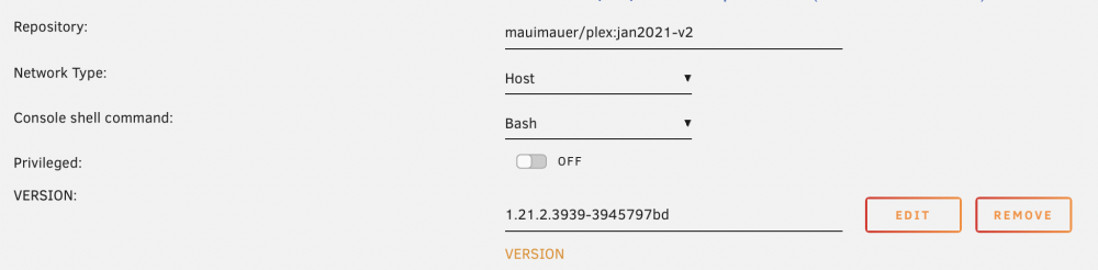

February 24, 20215 yr 2 hours ago, jimmy898 said: mauimauer/plex:jan2021-v2 Post your container settings.

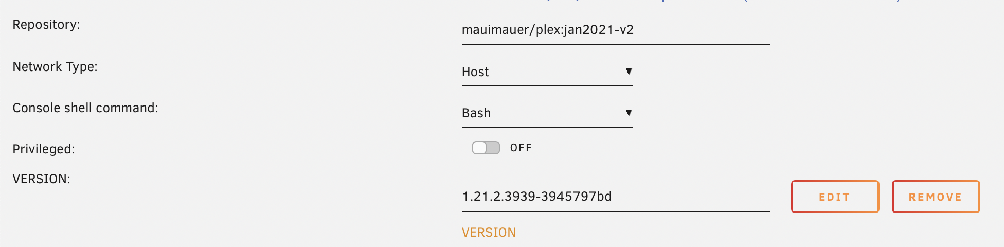

February 26, 20215 yr 18 hours ago, jimmy898 said: Here below my template: Which version of the Plex application is the container downloading? Don't use the latest. Try it with version: 1.21.2.3939-3945797bd because more recent ones are broken.

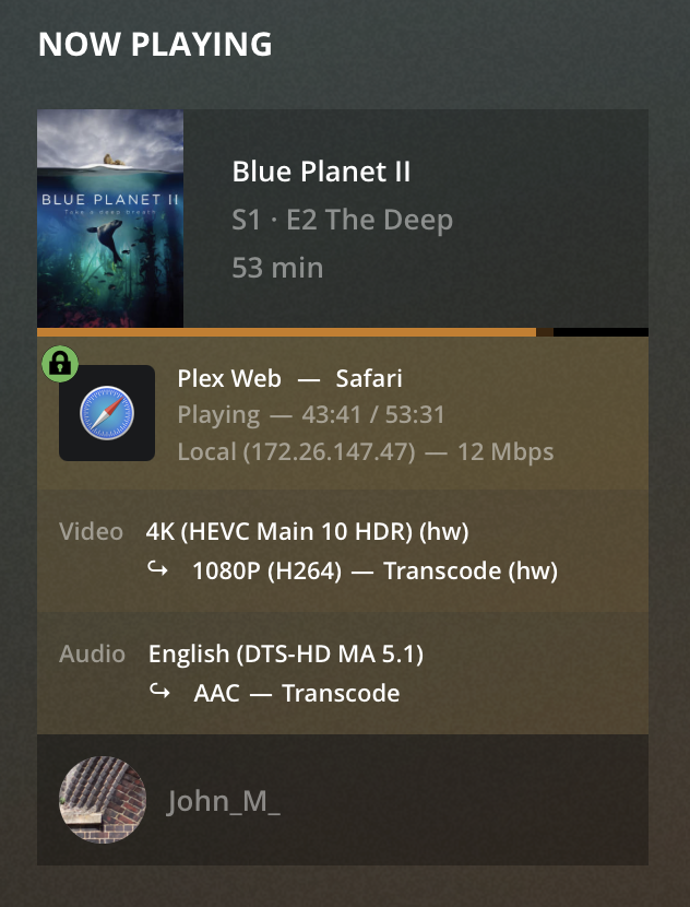

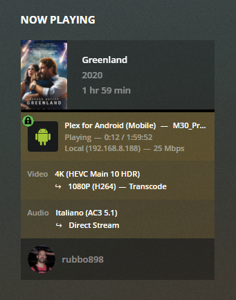

February 26, 20215 yr Here's what I see on the Dashboard when transcoding: which shows that it's using both hardware decoding and encoding. It works fine for all type of media, except this particular type (4K HDR). If you enable HDR Tone Mapping in Transcoder Settings it forces software transcoding but the colours are rich. If you disable HDR Tone Mapping it allows hardware transcoding but the colours are weak and washed out. I don't have much HDR material at the moment, anyway.
February 26, 20215 yr 6 hours ago, John_M said: Which version of the Plex application is the container downloading? Don't use the latest. Try it with version: 1.21.2.3939-3945797bd because more recent ones are broken. 6 hours ago, John_M said: Here's what I see on the Dashboard when transcoding: 1.21.2.3939-3945797bd which shows that it's using both hardware decoding and encoding. It works fine for all type of media, except this particular type (4K HDR). If you enable HDR Tone Mapping in Transcoder Settings it forces software transcoding but the colours are rich. If you disable HDR Tone Mapping it allows hardware transcoding but the colours are weak and washed out. I don't have much HDR material at the moment, anyway. That's it, 1.21.2.3939-3945797bd version is the key! Thank @John_M Double checking Got HW Transcoding to work with libva/vaapi on Raden APU (Ryzen 7 4700U) I'm feeling an idiot, last 2 messages state the very same point. I will stay with this version hoping for future (maybe official) full HW transconding support from Plex Team.
April 11, 20215 yr On 2/26/2021 at 10:20 AM, jimmy898 said: I will stay with this version Although support hasn't been added by the Plex devs yet, you can switch back to the lastest version of the application and the latest version of mauimauer's container now. The only thing that doesn't work is HDR tonemapping. https://forums.plex.tv/t/got-hw-transcoding-to-work-with-libva-vaapi-on-raden-apu-ryzen-7-4700u/676546/38
