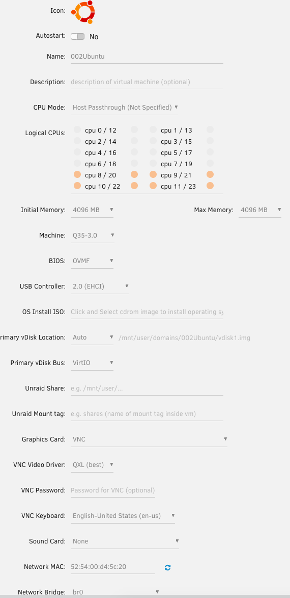

The Ubuntu Desktop I am setting up are very slow and laggy. It`s like its running from a CD-ROM or a corrupt video driver. I think I have allocated enough resourses wit 4GB RAM and 4 cores/8 threads running on Xeon Silver 4116.
I hope anyone can help.
Cheers
Frode

What drive is the vdisk located on?    Do you have a cache drive?     Running VMs with the OS vdisk on a drive in a parity protected array is often slow because of the relatively slow write performance on Unraid.

I run 4 ssd`s in Raid10. Domains is on the cache drive as well as the vdisk file. Is the default vnc driver ok to run?
Strange. Only 32 GB used on the cache, 3 VM`s is more than 100GB alone. The 3 different VM`s vdisk`s name is the same "vdisk1.img".

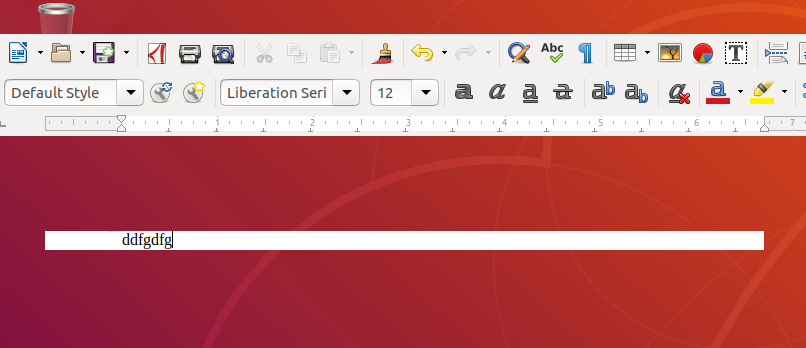

Can it be on the graphic card setup. Not able to format a standard web page, not even after 30 sec. When I start LibreOffice, it starts quit ok, but not able to format the screen, see attached file.
// Frode

Anyone have an idea why Ubuntu is so laggy?
Changing resolution made it much better.
