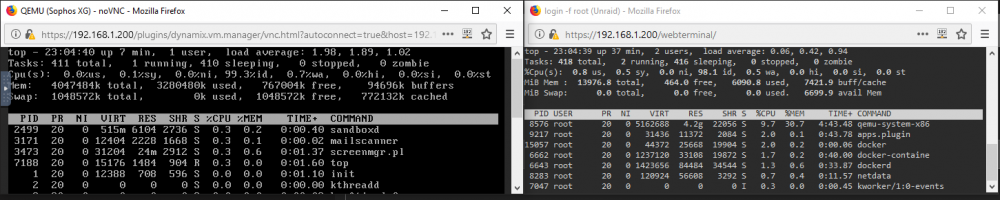

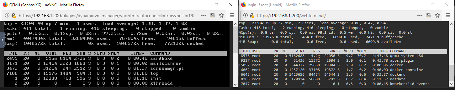

qemu when the host is idle (i have tried with sophos XG, pfsense and opnsense) consumes 10% of CPU, while it should be much lower.
Left Sophos XG // Right Unraid. There is no other VM running while testing
I know this is not normal because with proxmox the overhead is much lower and it uses qemu as well.
Is there a  way to fix this? any help is welcome

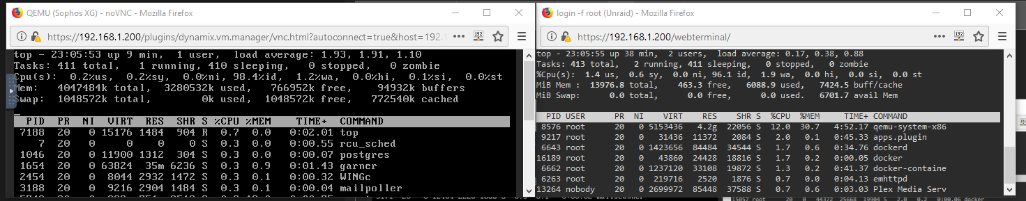

On load is hard to compare because load is not stable and both screens doesn't update at the same time, but as far as I can tell the behaviour is even worst, the overhead is higher.
