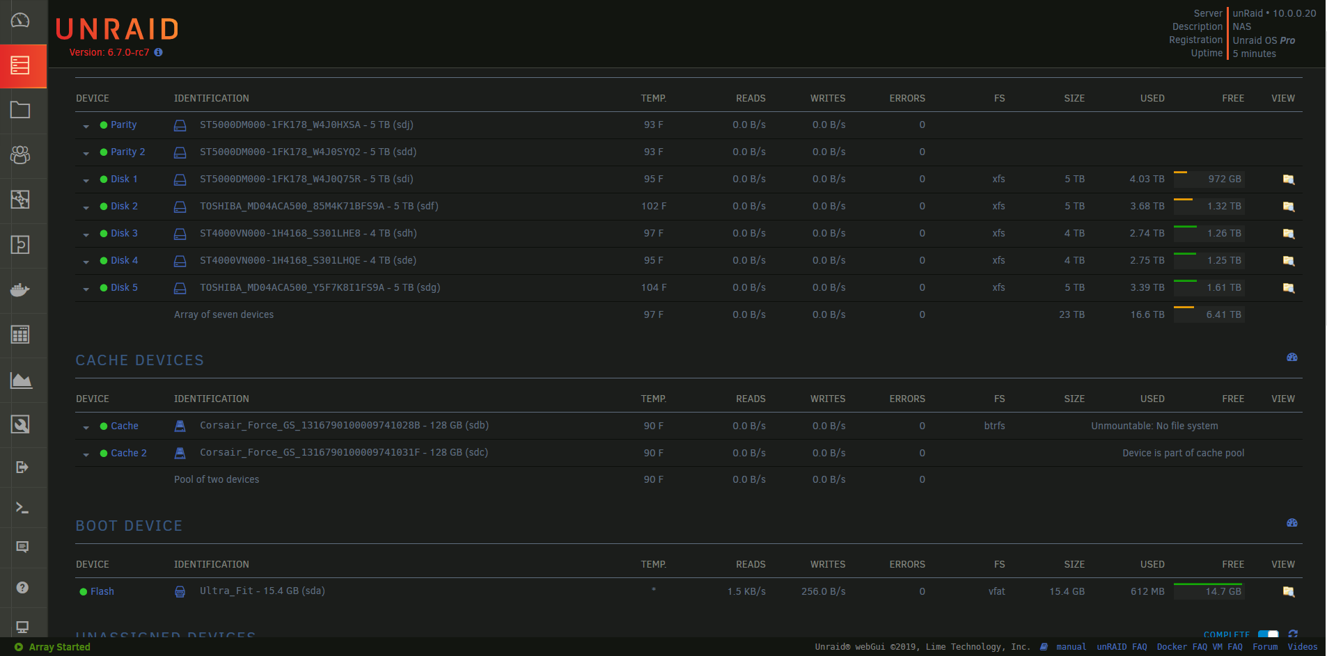

Trying to add 2 more SSDs to my Cache drive

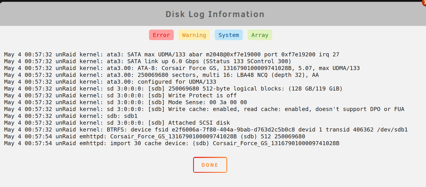

I for some reason thought I could just plug and play 2 more SSDs into my cache pool for storage. I was able to get them installed and mounted, however it didnt go as planned, one of my original SSDs is now saying its unmountable with with no file system present, while the other still says its apart of a pool still. I even tried unplugging the 2 new drives to see if I could boot it up as before, but that didnt help. Can anyone take a look at my logs and see if there is something I did wrong?

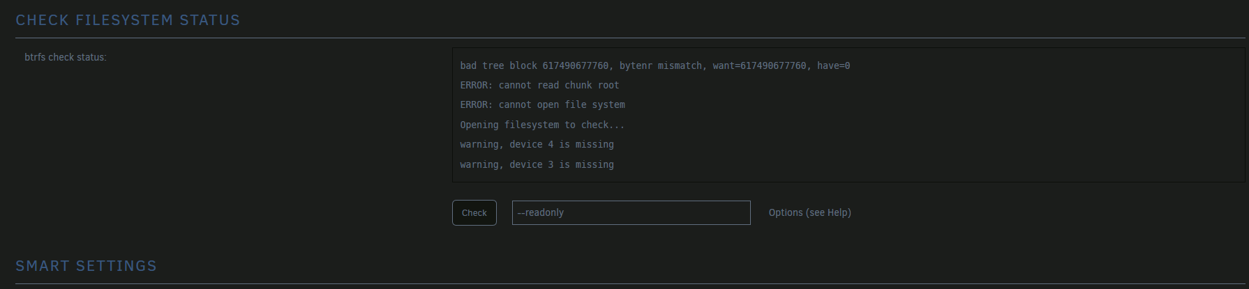

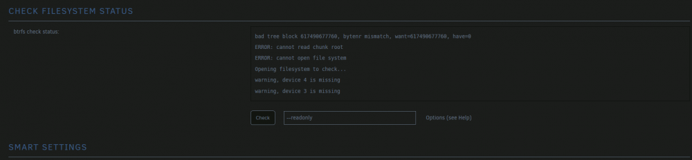

Not quite sure what happened here, but it looks like all 4 devices where already part of a pool at boot time but only two were assigned, so you re-assigned the missing two and they were detected as new and so wiped, and a 4 device pool can't mount with only two working devices, you might try the options below but have some doubts they will work for this situation:
https://forums.unraid.net/topic/46802-faq-for-unraid-v6/?do=findComment&comment=543490

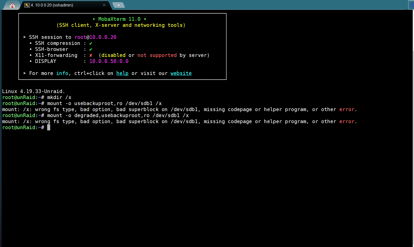

"mount: /x: wrong fs type, bad option, bad superblock on /dev/sdb1, missing codepage or helper program, or other error."
Any ideas?

Not really, you can try #btrfs on IRC or their mailing list for more help, since the filesystem was wiped on two devices I suspect the only way would be to manually recreate the missing superblocks.
