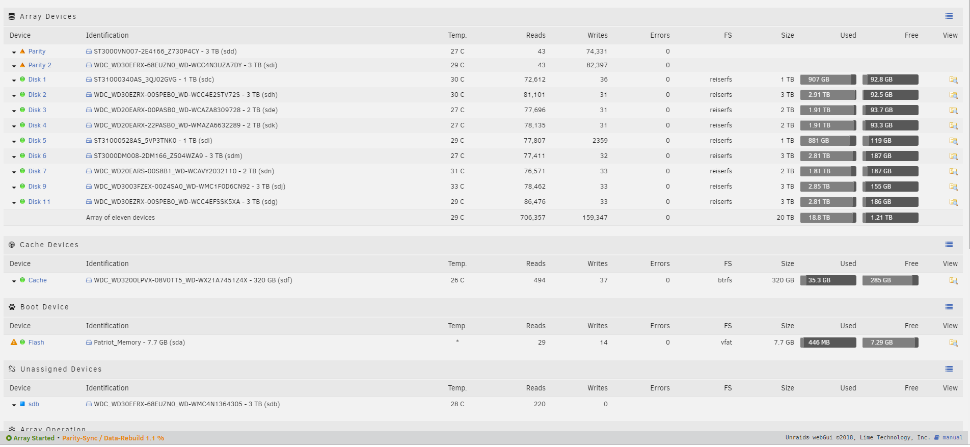

I started the copy and left it. 16 hours later it had copied 1% of the old parity drive to the new one. I checked the syslog and there were a bunch of errors.  Thinking I might not have put the new drive in it's slot firmly enough I tried to stop the copy but the system didn't respond at all to that request. Finally I just shutdown the machine and reseated the drive.  When I brought it back up it had both 3TB parity drives in their original spot and the 1TB data drive unassigned. At this point I was quite nervous about the whole thing. I decide to try something else. I have in the array a 3TB unassigned spare drive for emergencies. I decided to rebuild the missing 1TB drive onto that, so I assigned that drive to the slot (didn't do anything with the parity or the new 4TB drive I had installed) and started a rebuild. It got to about 90% before I went to bed. When I woke up the machine was unresponsive. I checked the monitor connected to it and found a Kernel panic and out of memory error. I have 4GB of RAM in the machine. I know it's not much compared to some builds but it's always been enough. I have rebuild drives in the past and rebuild parity in the past and that has always been enough memory. During the rebuild the memory usage I saw never rose above 30%.
After the kernel panic I had no choice but to reboot the machine and it came back up with just the one data drive missing (the previous 1TB one). Freaking out at this point I figured I'd just return my system to the way it was before I started on this misadventure. I shutdown the machine took out the 4TB drive (which was to be the new parity drive) and put back the 1TB data drive (that had no issue other than it was one of my smallest drives). I booted up the machine, as I expected since I unassigned the 1TB data drive, it showed up as missing. When I reassigned the 1TB drive back into it's spot it wanted to rebuild it. Considering the problems with the last rebuild and knowing the data on the drive was fine I didn't want to do that. I took a gamble, I used the New Config tool to accept all the data drives as good (I had completed a parity check just a week prior so I was confident the data was good) knowing I would have to rebuild the two parity drives. I did that.  All data drives were back in their places and parity was rebuilding. The two parity drives were rebuilding at an okay pace, the cpu was maxed but the memory usage was not so I had hopes it would work. The estimate was 11 hours so I went to bed again. The next morning (this morning) it was still running, memory usage was fine. I left the house to run some errands and hoped to come back to a good (if crowded) array. I came back to an unresponsive (page not found) system and this on the monitor:

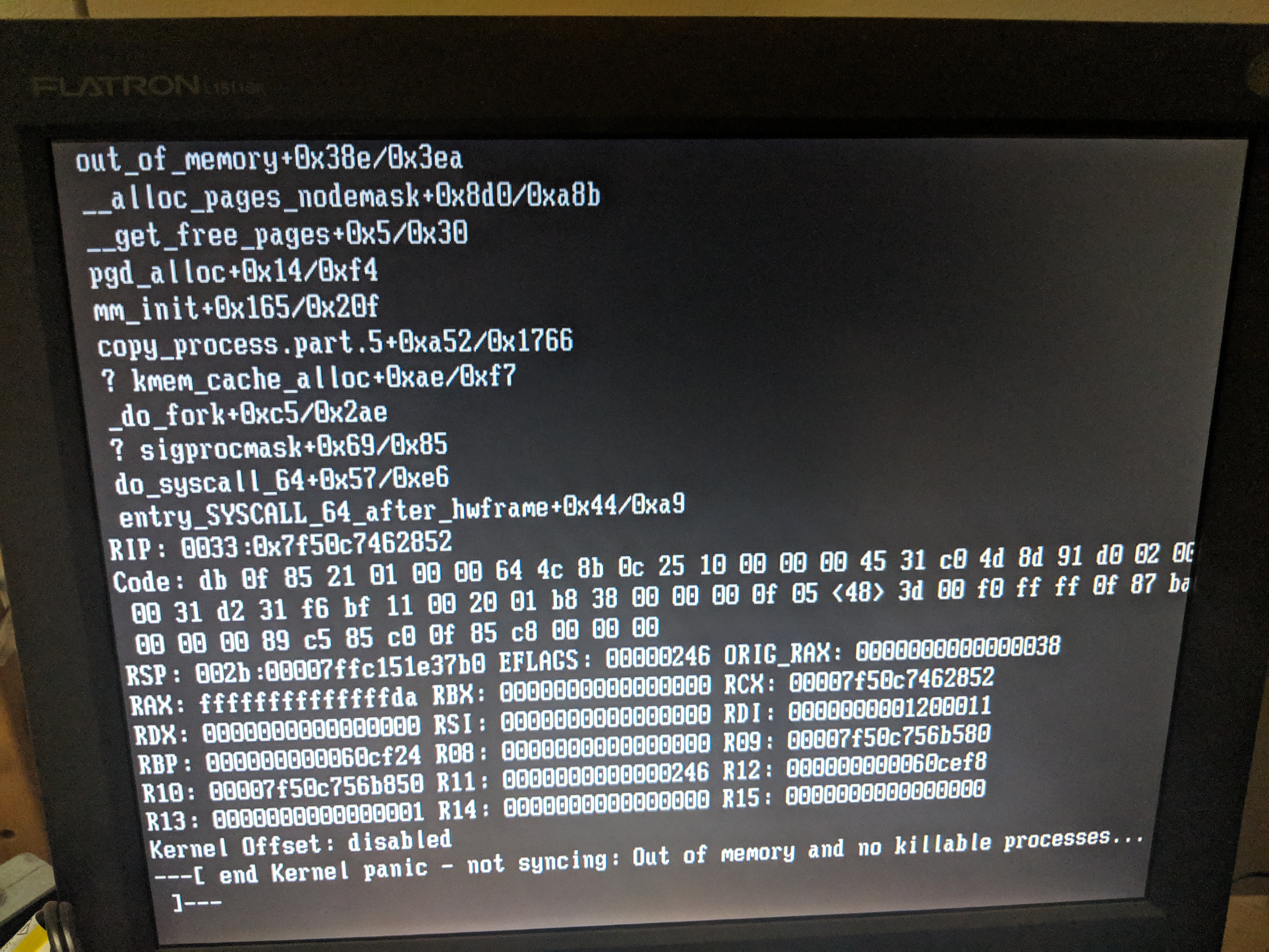

Unless I am missing something it feels like at the end of a disk rebuild or parity rebuild there is something that makes a huge memory grab? I have ordered 2x8GB sticks for my machine, it's the most it can handle, but I have a scary thought that it might not help.

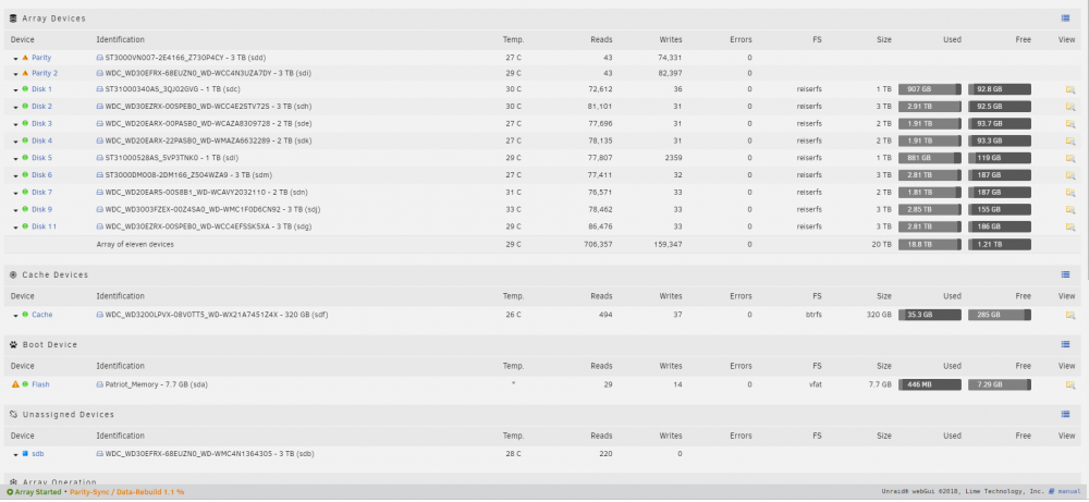

I think where you are now looks hopeful. The screenshot is showing all disks mounted and mostly full. You should consider getting your disks converted from ReiserFS after you get things square and have some extra capacity.
DIsk7 needs to be replaced as it has quite a few pending sectors. Possibly this is causing some of your problems. No idea what might be causing the OOM though, rebuilding shouldn't really consume any memory.
Since your diagnostics are after the reboot can't see what might have led up to the dump. See this sticky for some ideas on how you might get us more information from before the (next) crash:

Curious why this isn't the disk you intended to replace. You should see SMART warnings for that disk on the Dashboard. You shouldn't ignore these. All bits of all disks must be reliably read in order to reliably rebuild a disk.

You only have 4GB RAM, but very few plugins, no dockers or VMs, so I don't understand what is causing the OOM.

Back to the problem at hand.  Does anyone have a thorough understanding of the parity or drive rebuild process? I have watched the parity rebuild run just fine for 8 of the estimated 11 hours without issue. The OOM problem does not happen at the beginning of the rebuild, it does not happen at the middle of the rebuild. Something changes near or at the end of the process, maybe a different service is called, or a calculation is run at or near the end of the rebuild that causes this OOM error.

Shouldn't be anything sufficiently different at the end vs earlier to cause OOM. The parity calculation is very simple and doesn't change throughout.
