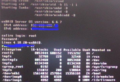

If you try the ‘df’ command from the console does it show that there is a device mounted at /boot (I.e. the flash drive).    If not that could explain your symptoms as it means that the later stages of the booting process where the USB stick gets mounted is not completing correctly as that is required to complete starting the system.
Edited by itimpi
My guess is that something went wrong that by mistake I initiated a couple of days a go the update to 6.6.7 but forgot about it.... and now that server rebooted I got myself a bit of pickle... maybe
There is no /boot (as you might have seen). What might be the best way to go?
Wait! you might be right... please see the attached image
That in itself should not cause an issue.    However it is possible that somehow the USB stick did not get updated correctly (which is why I asked about the output of the ‘df’ command.

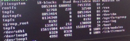

Okay I am upgrading again to the 6.6.7 version again as the 6.6.6 gave me the same issues. I use USB 2.0 and use the legacy mode as SuperMicro is giving me some weird shell function with UEFI mode. UNRAID is written correctly. I see no messages that worry me. Altough, when provided the choice how to boot I am unable to use the tab to switch modes.
In the image below there are the 'df' command test. It would seem that booting went fine, but I should admit that there were instances where loading went too fast for me to follow. Still I have to same issues... suggestions?
