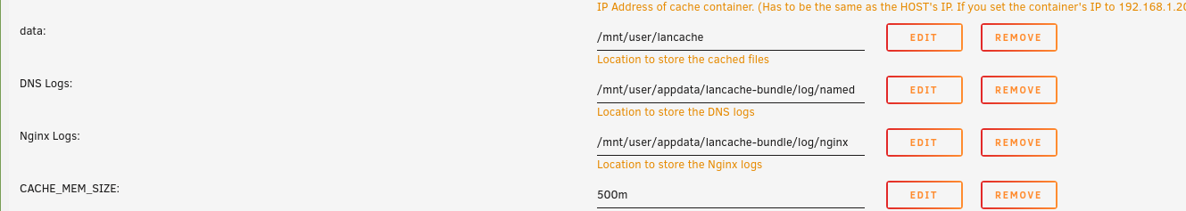

I've pushed a decent update to the lancache-bundle which should now fix most of the issues that people were having.
However, you will need to update the template a bit. Either make these changes yourself:
  1. Add the Nginx Logs volume.
  2. Modify the "data:" volume to point internally to `/data/cache` (The container will not work without this modification)
imageproxy.php?img=&key=e5eec7c5c933ca161472457308_Screenshotfrom2020-02-2620-47-18.thumb.png.bffcb70c63b1b79d33f35d862b85023a.png
...or remove the container and start fresh from the template found here: https://github.com/Josh5/unraid-docker-templates

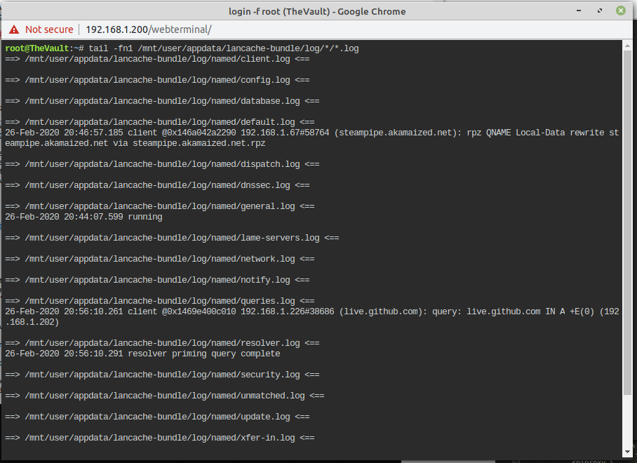

Finally, once you do have it running and would like to see if it is working, open a terminal on your Unraid server and run:
tail -fn1 /mnt/user/appdata/lancache-bundle/log/*/*.log
