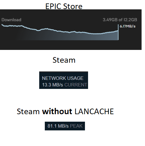

I am having speed issues too. I have a symetrical gig connection to my ISP and my download speeds on steam are 60mb/s before I installed LanCache. After the install I am getting 2-15mb/s tops. Once LANCACHE has it cached it works perfectly (80-90MB/s). So right now I have a love hate relationship with it. I LOVE it once it has the files cached but I HATE how much it slows down my first download ^_^;
I am running this docker on unRAID with the following specs:
CPU: Intel® Xeon® CPU E3-1240 v5 @ 3.50GHz
HVM: Enabled
IOMMU: Enabled
Cache: 128 KiB, 128 KiB, 1024 KiB, 8192 KiB
Memory: 64 GiB DDR4 (max. installable capacity 64 GiB)
Network: bond0: fault-tolerance (active-backup), mtu 1500
 eth0: 1000 Mbps, full duplex, mtu 1500
Kernel: Linux 4.19.98-Unraid x86_64
OpenSSL: 1.1.1d
PS: I have a dual SFP+ NIC that I plan on installing bonded and my primary switch is fiber only 10g but unless I can figure out this issue, there is no point in installing it.
HVM: Enabled
IOMMU: Enabled
OpenSSL: 1.1.1d
I am experiencing this same issue.
