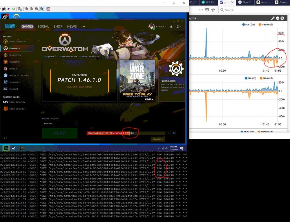

Ok, It appears that it might be working, just some of the configs might not be setup the way the devs want them to.  I don't know why your log lines are truncated, but when comparing SteamCacheBundle to lancache-bundle, I found that 200 = HIT and 206 = MISS
10.10.10.100 - - [25/Mar/2020:20:27:47 -0600] "GET /tpr/ovw/data/c1/25/c125c5ac589f3ccbdbd632d5249b7878 HTTP/1.1" 206 7540 "-" "-"
10.10.10.100 - - [25/Mar/2020:20:27:50 -0600] "GET /na/patches/wot_1.7.1.1844_na/wot_1.7.1.20228_1.7.1.20220_client.wgpkg HTTP/1.1" 206 16777216 "-" "wdsa::Torrents/libtorrent 1.1.9.0"
Now, what makes even less sense.. is this attached picture.  In the upper left, I am updating Overwatch on a computer that is on WiFi (which is crappy in my house, so the 1.5MB/s isn't part of the issue), in the upper right is the bandwidth monitoring on my firewall showing pretty much NO internet traffic, which means it is all being pulled from the lancache-bundle docker, and at the bottom is the lancache-bundle log showing 206, or misses.
So, I don't know where to go from here.  It appears to be working, so that might be good.  Logs appear to be useless other than seeing that computers are actually talking to it.  I'll play with it some more, but I'm not sure how to help you fix it.
I do have one group of requests though, if you could install vim, make bash the default, and install bash-completion, I would appreciate it and it would make troubleshooting a lot easier for me.
James
