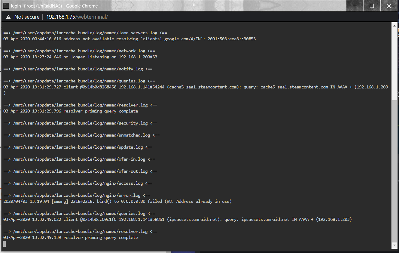

On 2/28/2020 at 3:12 PM, Josh.5 said:
Open a terminal on unraid.
Run :
tail -fn1 /mnt/user/appdata/lancache-bundle/log/*/*.log
i tried running your command connected to host i get this spamming
2020/04/03 00:25:11 [emerg] 2234#2234: bind() to 0.0.0.0:80 failed (98: Address already in use)
2020/04/03 00:25:11 [emerg] 2234#2234: still could not bind()
2020/04/03 00:25:14 [emerg] 2236#2236: bind() to 0.0.0.0:80 failed (98: Address already in use)
but anything else just doesn't work unless i use a different IP then my server which it says not to do

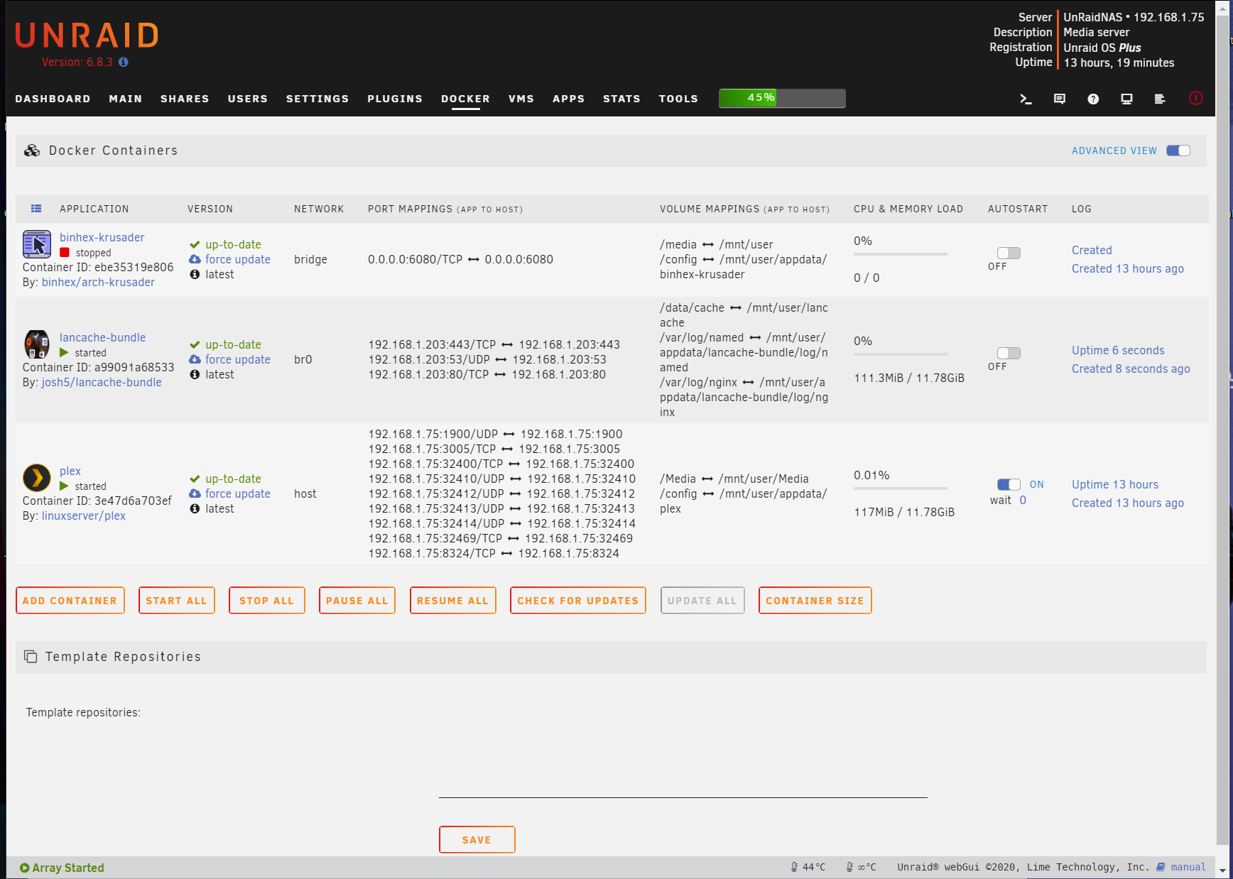

All of your dockers need to have a different IP address than the server.

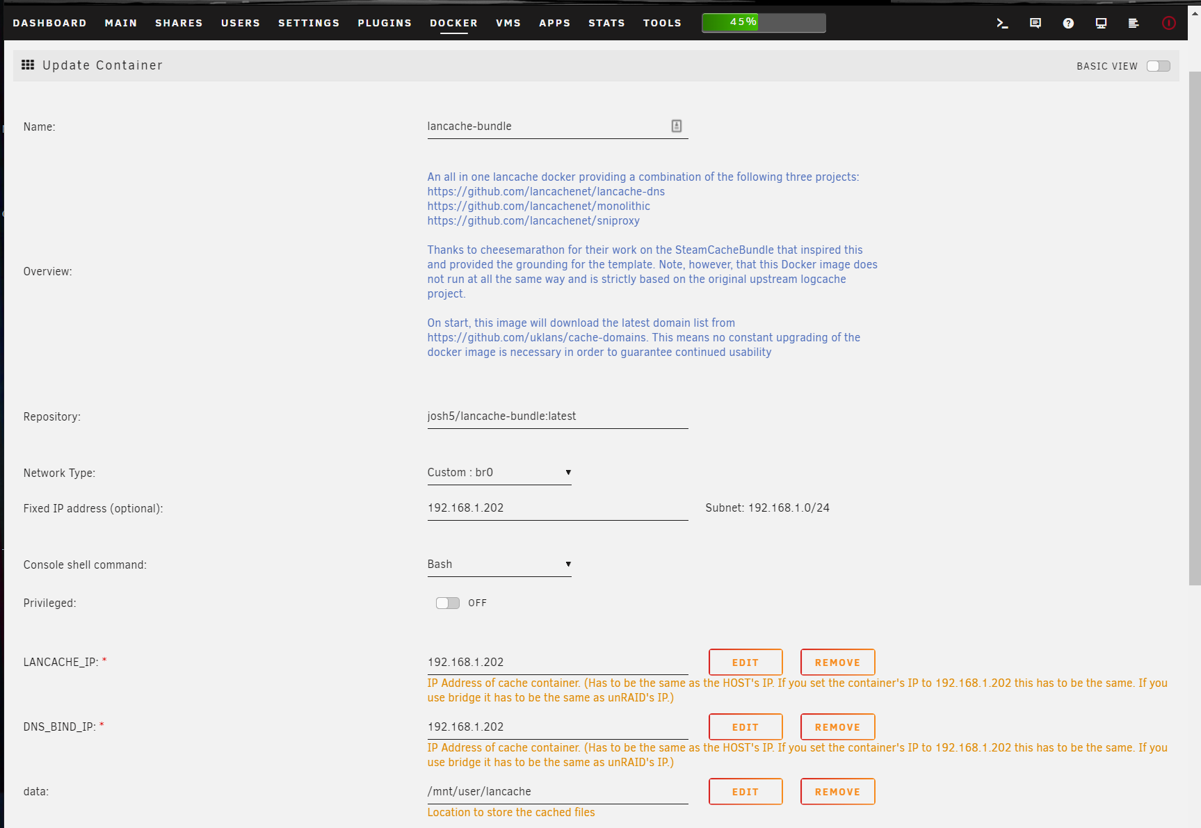

So I thought i had it working but it didn't work - Is there a good tutorial for setting this up for unraid? I assume there is something that i overlooked?
my plex is on the same ip as the server anything i set to host uses the same 192.168.1.75 ip.
but i change lan cache to a ip that nothing else is using 192.168.1.203 and changed my windows dns to 192.168.1.203 and tried downloading a different game and nothing worked but heres the error i get now
and the last is when i tried downloading with origin which i never really use so it shouldn't be cached in anyway
ok i think i fix it i ran
ipconfig /flushdns
in on my windows pc

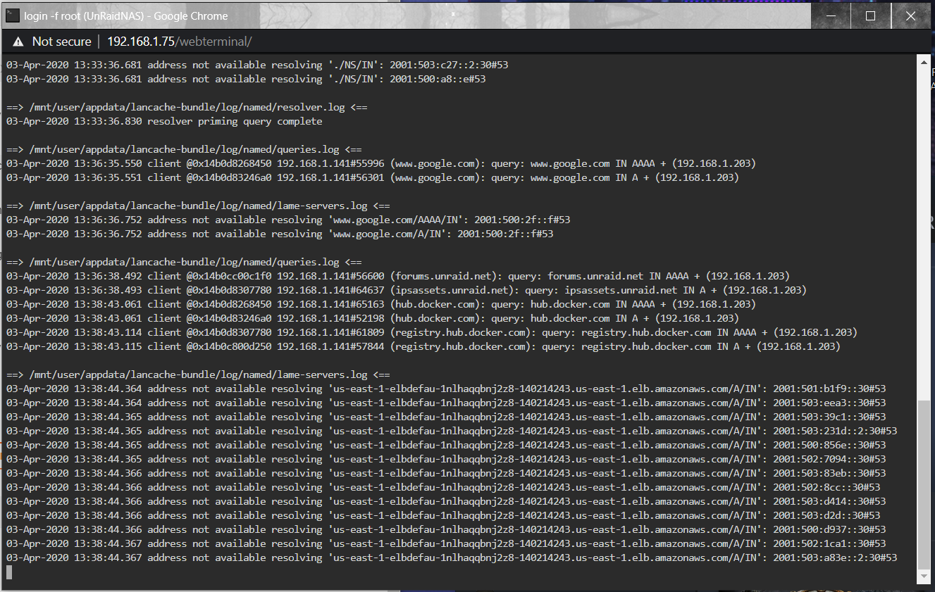

edit: well it started making files in the cache but doesn't seem to use them to speed up my download i had this working a week or two ago and the speeds where insanely fast. my internet is only 2mb/s
unless this is a problem
==> /mnt/user/appdata/lancache-bundle/log/named/resolver.log <==
03-Apr-2020 14:07:00.983 DNS format error from 205.251.192.245#53 resolving pocket.realms.minecraft.net/AAAA for client 192.168.1.205#63097: Name minecraft.net (SOA) not subdomain of zone realms.minecraft.net -- invalid response
==> /mnt/user/appdata/lancache-bundle/log/named/security.log <==
==> /mnt/user/appdata/lancache-bundle/log/named/unmatched.log <==
==> /mnt/user/appdata/lancache-bundle/log/named/update.log <==
==> /mnt/user/appdata/lancache-bundle/log/named/xfer-in.log <==
==> /mnt/user/appdata/lancache-bundle/log/named/xfer-out.log <==
==> /mnt/user/appdata/lancache-bundle/log/nginx/access.log <==
192.168.1.141 - - [03/Apr/2020:13:53:35 -0500] "GET /depot/105601/chunk/06becadb92a5fcca2529c0b93687c2a0c6d0d610 HTTP/1.1" 200 794544 "-" "Valve/Steam HTTP Client 1.0"
==> /mnt/user/appdata/lancache-bundle/log/nginx/error.log <==
2020/04/03 13:19:04 [emerg] 2218#2218: bind() to 0.0.0.0:80 failed (98: Address already in use)
==> /mnt/user/appdata/lancache-bundle/log/named/queries.log <==
03-Apr-2020 14:14:44.894 client @0x154b982ea860 192.168.1.205#51075 (v20.events.data.microsoft.com): query: v20.events.data.microsoft.com IN AAAA + (192.168.1.202)
03-Apr-2020 14:14:44.895 client @0x154b98293b00 192.168.1.205#50262 (v20.events.data.microsoft.com): query: v20.events.data.microsoft.com IN A + (192.168.1.202)

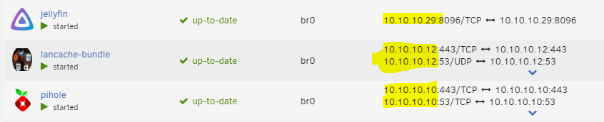

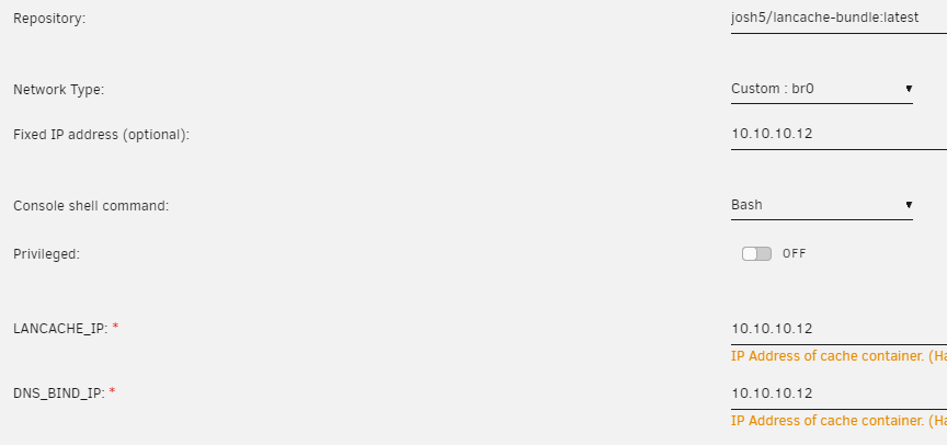

Not correct actually.
As long as the ports & layer protocols are different and non of the containers are using things like net_admin, then all of them can use the same IP.
However in the case of a DNS lookup, technically, you just need the relevant DNS ports, however generally speaking its better to dedicate it to its own IP to help segment ports off, and prevent issues with potential port scans on a DNS IP from uncovering other services.
In the example screenshot given, as there are two containers trying to use DNS/53 (a typically dual protocol TCP/UDP service), then yes, separate IP's is recommended.
Edited by boomam
Well, if you want to go to your unRaid docker page every time you want to access the web interface of a docker (or memorize a bunch of random ports), knock yourself out.  But, your browser defaults to port 80 or 443 (https), so every docker sharing your host IP will need a different port for the web interface.
Edit:  Ah.. I get it.. you got me.. you are just trolling..
