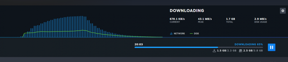

Hey dan91, just setup my first unraid and its working like a charm, however on first download from Blizzard & Origin is extremely slow <1Mpbs & 4Mbps respectively on my 1Gb line. On steam I can get up to ~75Mbps (depending on game) on first download and then cache maxes out my 1Gbp lan connection getting 117Mbps.
Will adding more IPs address improve the first download rate from Blizzard & Origin? I tried before moving to unraid on a virtual machine with different slice sizes which helped improve it slightly but never tried with additional IP address and only ever got it to 4Mbps on Blizzard.
Any help would be greatly appreciated.
I'm running a single dedicated IP address on my lancache-bundle at this time and also have a 1Gbps internet connection and seem to have hit a download limit of around 20Mbps through the lancache-bundle server.  But, with that said, when I test network equipment within a 1Gbps network, I look for ~950Mbps throughput, so a 1Gbps network should get better than 117Mbps, that would be a limitation to your lancache-bundle hardware, most likely.
From what I understand, adding the additional IP addresses should improve your download performance.  I'd say give it a shot and report back.
Hey jzawacki, thanks for the reply. My apologies messing the stats up here. Downloading on steam I can get ~75MB/s and then once cached 117MB/s. Currently downloading Battlefield 5 @ 5.74MB/s but averages at ~3MB/s and COD MW @ 881.02KB/s
So Origin and Blizzard are extremely slow. Bypassing lancache gets me to ~30MB/s +> I think I added extra IPs as per Dan's post but doesn't seem to be helping too much.
Edited by Xploit61
Hi Xploit with a single IP for blizzard i get about 1-3 MB/s on initial download with the amount of IP's from my initial post I mostly max out my download speed 8MB/s.
If you remove all the extra IP's and just try 1 extra IP does your cache still work? (basically are the extra IP's functioning correctly) Can you see them in ip addr on the command prompt on unraid and are you using HOST mode for the docker container?
Are you downloading to spinning disks or an SSD? If spinning are you able to swap to an SSD just for testing the blizzard download? You may be hitting a limitation on disk access times which may be why increasing your slice size helped. (How you get more througput from one large file than loads of small ones)

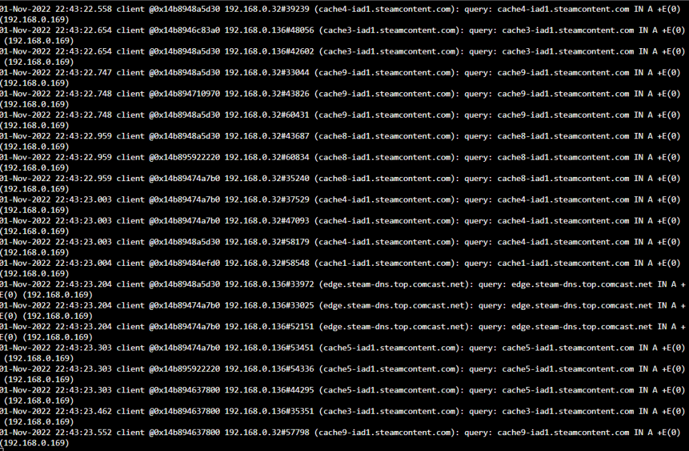

Hi All
Hope everyone is well.
Finally took the time to get lancache docker running.
I can see all the dns calls in the log for steam, epic and my web traffic etc with the way i have it setup
no files in the cache folder, tried various games with a few providers, i see the data in the log for the cache urls its accessing, such as
29-Apr-2020 20:33:27.494 client @0x15358023cda0 192.168.1.1#52049 (steamcdn-a.akamaihd.net): query: steamcdn-a.akamaihd.net IN A + (192.168.1.69)
29-Apr-2020 20:20:05.233 client @0x1533e024b530 192.168.1.1#52049 (cache26-lhr1.steamcontent.com): query: cache26-lhr1.steamcontent.com IN A + (192.168.1.69)
29-Apr-2020 20:20:04.834 client @0x1533e02116f0 192.168.1.1#52049 (lancache.steamcontent.com): query: lancache.steamcontent.com IN A + (192.168.1.69)
But no files, only things i see in the docker log that look like are errors are
Epic now says trouble connecting not sure if thats related
proxy_next_upstream error timeout http_404;
proxy_cache_use_stale error timeout invalid_header updating http_500 http_502 http_503 http_504;
There is also something odd when i search for the above domain in the docker log
~.*£££.*?#WARNING:Originhasbeenseendownloadinghttpsclientdownloadsonorigin-a.akamaihd.net.Asolutionshouldbeinplacetoforwardhttpstotheoriginserver(egsniproxy) origin;
~.*£££.*?origin-a.akamaihd.net origin;
I am out of ideas to be honest.

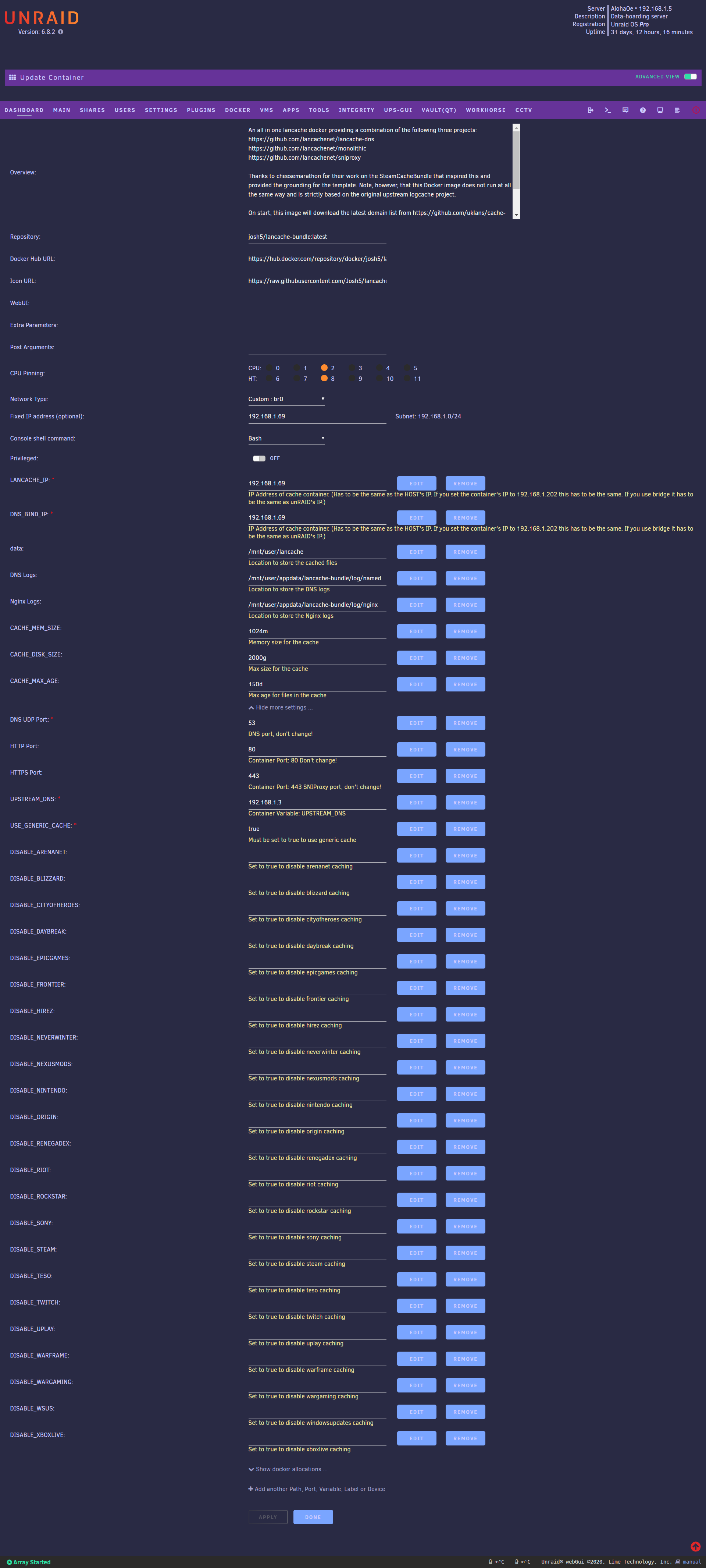

Did you set you secondary dns when you changed it
Also edit the lancache bundle and post a picture of what it looks like
Thanks James, i have the outbound working now with the secondary dns
Nothing in the cache still and sure here you go

If anyone could help with the issues I'm having with lancache that would be brilliant.
Whenever I download a game it starts fine at my internet speed for either a few seconds or a few minutes and then it slows down until it gets to bytes a second and then it completely stops.
It's adding files to my cache all the time it's working before completely dying.
Any help on how to debug this would be greatly appreciated.
Have install the lancache-bundle this evening, DNS is working fine.
When we try and download a game on Steam, all cpu cores go straight to 100% on unraid and nothing actually downloads.
The cache directory is empty and steam says downloading with no progress. Cancelling the download, the cpu goes back to idle.
Hello,
I have the lancache docker running on unraid and a pihole on a raspberrypi.
The Pihole works as dhcp server and has the lancache as upstream dns.
If i download a game it doesnt get cached, i see logs filling, i see that in ressource monitor the steam.exe/origin.exe (tested with these both) downloads from my lancache ip adress but its not caching.
nslookup steamcontent.com gives me the ip from the lancache aswell.
I tried skipping the pihole and setting the dns directly to the lancache ip but that doesnt work either.
The cache folder just stays empty.
Hope you can help me
