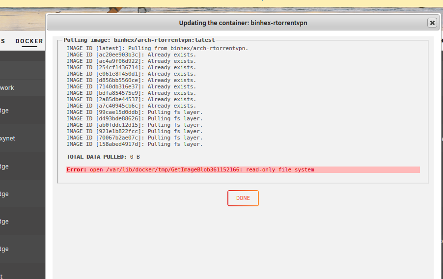

I have the same problem. I think it happened when the log space was full. I couldn't update any dockers with an error message  "open /var/lib/docker/tmp/getimageblob 361152166: read-only file system"
Post diagnostics your screen shot shows that the docker.img is read only, not that the log is full

60 Gig is insane for the size of a docker.img  Vast majority of users only require 20Gig Max (assuming that everything is configured correctly),
But either way, the docker.img is getting write errors.  Because the system is in the process of shutting down, its hard to tell exactly where its being stored, (whether on the cache or disk3), but either way your initial trouble shooting is to
disable the docker service, delete the image file, re-enable the service, then hit Apps, Previous Apps, and check off everything you had installed.
