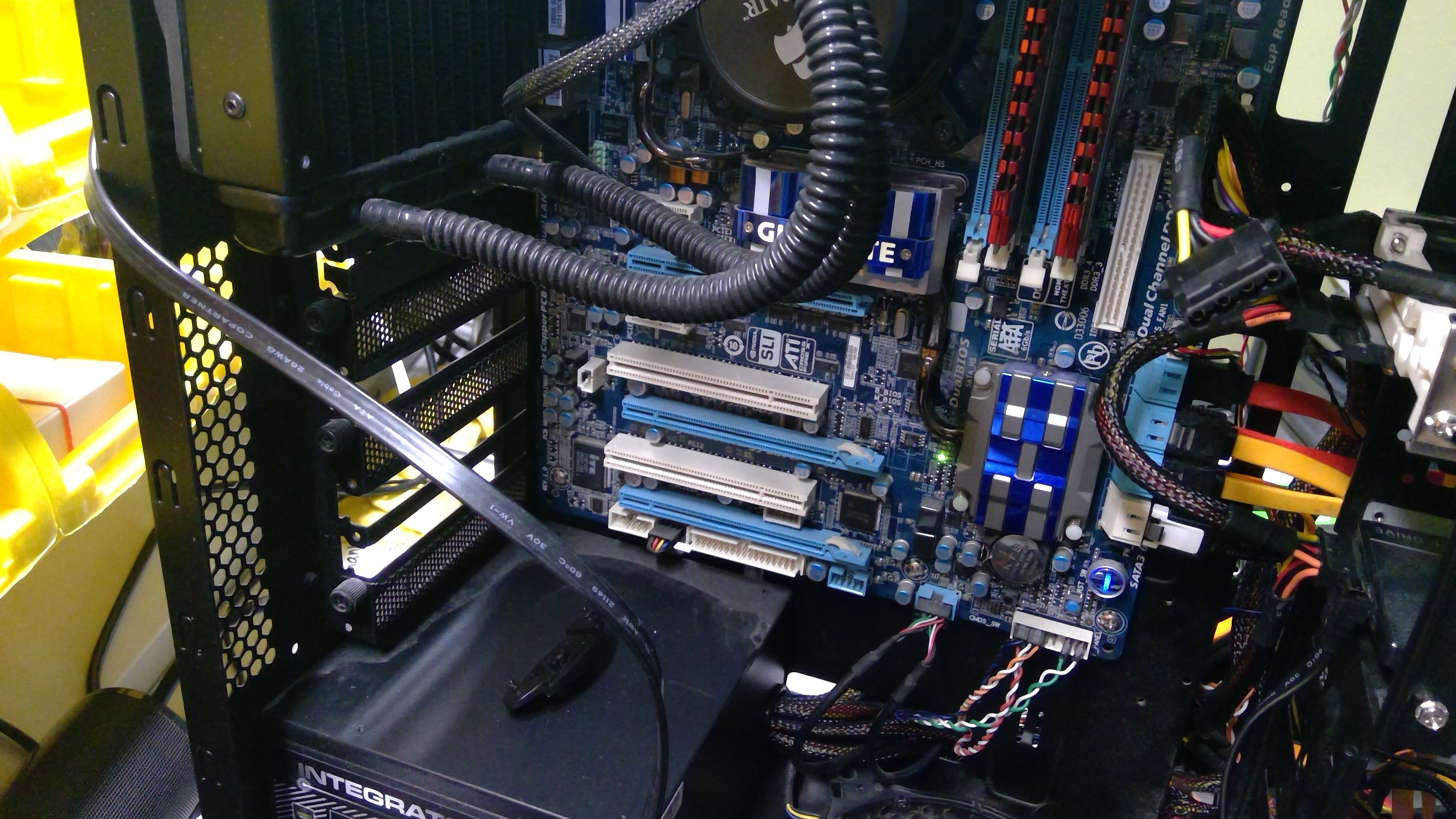

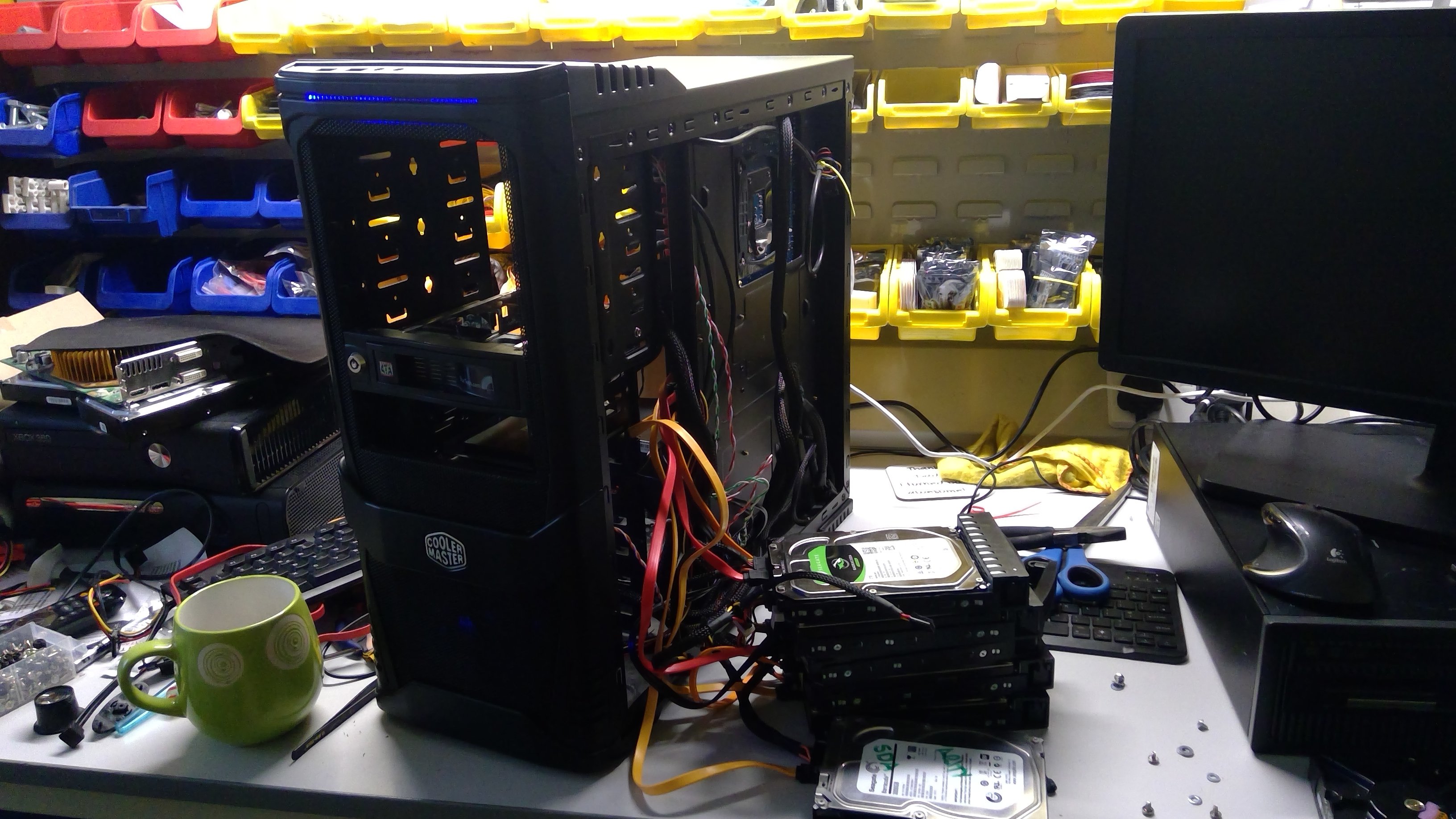

So, probably not the best way to fix things...as it is in the pictures, i have all the drives connected up to 7 SATA ports, leaving one free, possibly faulty, i dont know yet...the disk is rebuilding again and will take 5 hours, now, once it is rebuilt again, i want to test the free SATA port without it going via the enclosure, if i do this and the disk again becomes not installed and i put it back to the port it rebuilt on, will it start a data rebuild all over again ? i think that the problem may be with the enclosure i bought, i got it from ebay and i have a feeling that slot 4 is the issue as i could not get a disk to detect in it or if it did, it would be in an error state.
