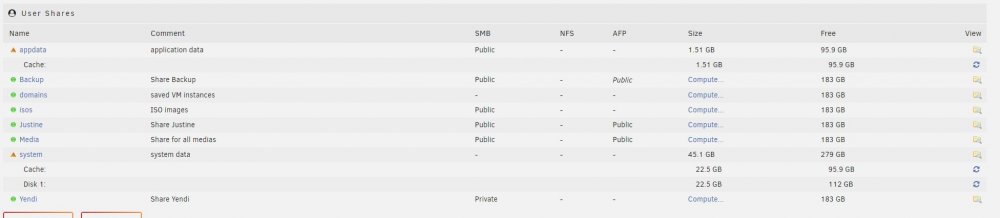

Right now my settings are:
appdata: use cache ONLY
domain : use cache NO
system: use cache NO

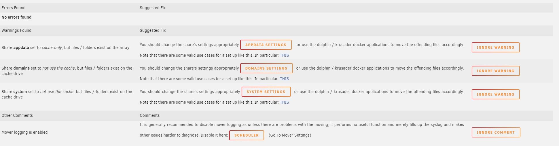

I installed "fix common problem" and the result is attached.

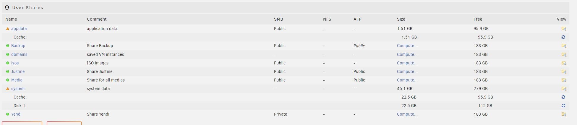

but when I start the mover the system share does not move at all. Strange thing, both cache and array usage for system is 22.5GB as it was a copy of the data.
What I have in cache for system:
/mnt/cache/system/docker/docker.img and /mnt/cache/system/libvirt/libvirt.img
