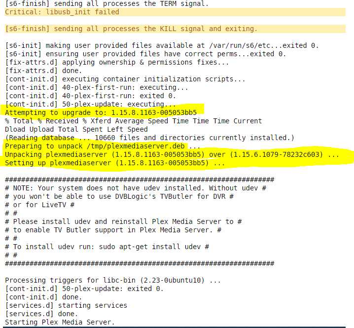

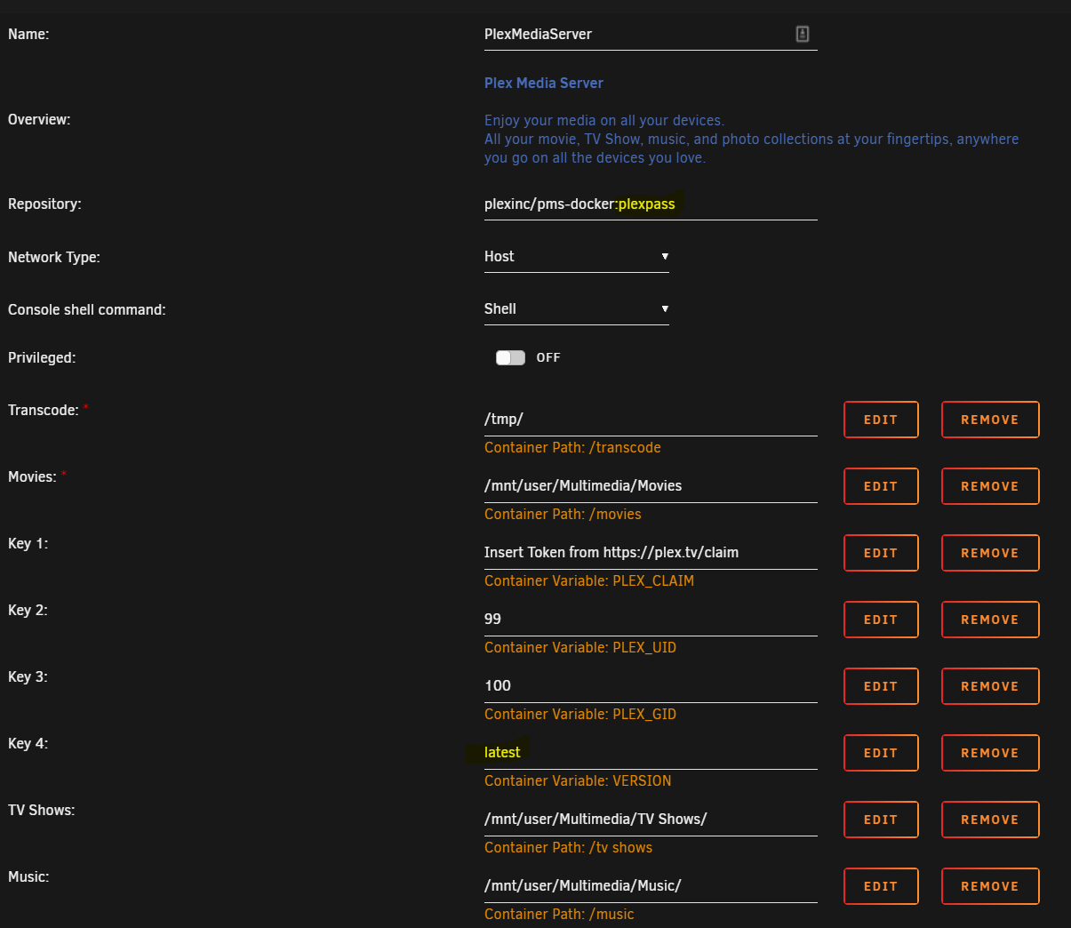

Very easy, just add :plexpass behind your repo. When a new beta is released, all you need to do is restart your docker.
This is on my last reboot of the docker I did:
That's using the Plex docker created and controlled by plex, I notice that you have not got a claimed plex code or is that just for the screenshots? I ask as I didn't think it would update to the plex pass version without that and it was a so and so to get it in there in the first place.
Edited by MMW
Correct, I am using Plex's docker as it updates with just a reboot as soon as new versions are pushed, no having to wait for Dev to update their template. And to be honest, I was running on the plexpass version without having the claim code for weeks now, no issues. However, now that you pointed it out, I added it in 🙂 not an issue for me at least since I have had a lifetime Plex pass for years now. Maybe that's why I had no issues since my account is already linked with a lifetime pass. Either way, give it a shot.
You mentioned it was "so so" to get the Plex version installed? I found it extremely easy using Squid's Community Applications plugin.

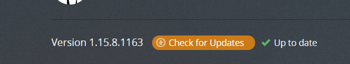

super ... i was a way from the system for sometime now and just got back ... added the PlexPass ( i also have had plexpass for years) and it updated with out a problem .. thanks so much .. i though it was something i forget to add
 I see that you could see all this in A LOG file .. where and how did you get this ?? i would like to look at what my setup says. and i see another question .. ( sorry ) another question what is "udev"

It's the docker log itself. You can get to this on the dockers tab in unraid, the status button furthest to the right. Will say a summary, something like last exitcode 0, or something (if you are in advanced mode). If in regular mode, it says "log". Click on that.
