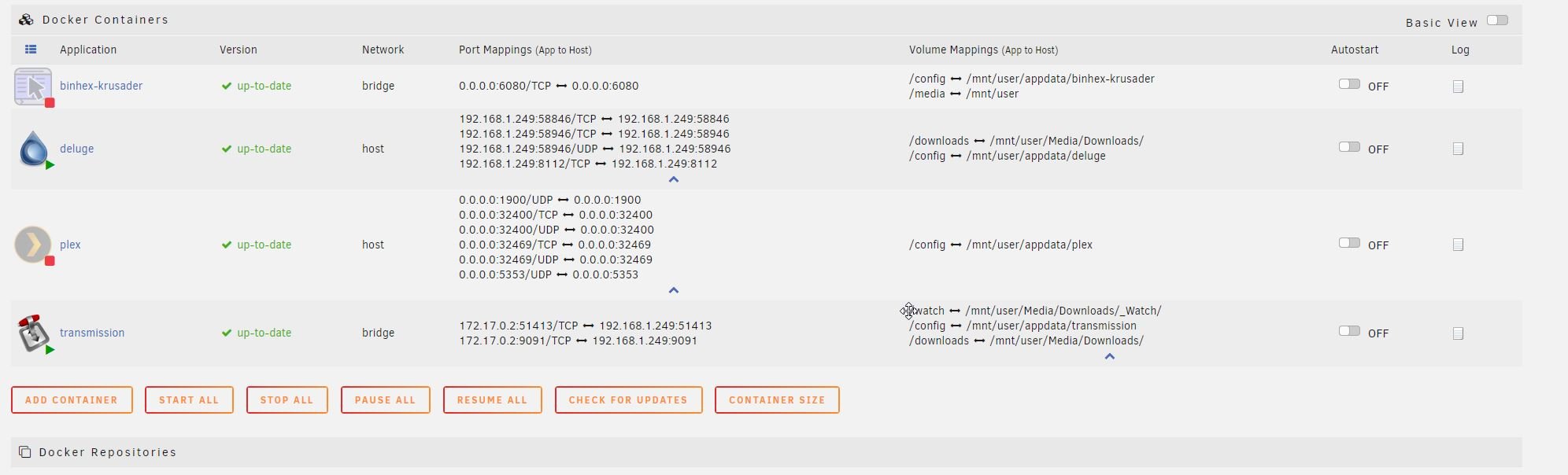

On every download client that I tried, I am unable to download anything. Everytime I have writing issues:
  • Transmission: No space left on device (/downloads/XXXXX.mkv)
  • Deluge: Permission denied: /root/Downloads/XXXXXXX.mkv
  • Qbittorent: can't even access it, 401 error
Here is my mappings
672694320_2019-05-0811_16_20-unRAID_Docker.thumb.jpg.1f82c5e560a02e17533d0c316e4d4b53.jpg
I start to think that I have permission issues somewhere, I ran "Docker Safe New Perms" with no error, no error as well with "Fix Common Problems" cause I have 150Gb+ free.
I don't have anything on docker so I am ok to start from scratch here. Should I completely reset Docker ? (is it even possible without reinstalling unRAID?)
What can I do here? cause I'm stuck for 3 days now.
Thanks for your help !

Your array disks are very full. You should consider adding storage. Other than that I'm not sure what your issue was, but some of your shares aren't configured properly.
Your system and domains shares aren't on cache where they belong. In fact I'm not sure what is even in your domains share since you don't seem to have VMs enabled.
  1. Disable Dockers and delete the docker image.
  2. Set system and domains shares to cache-prefer.
  3. Run Mover and let it complete.
  4. Enable Dockers and turn on log rotation.
  5. Reinstall your dockers using the Previous Apps feature on the Apps page.

The Previous Apps feature on the Apps page will reinstall your dockers exactly as they were before.
@trurlall done! As you said it retained all variables of the apps, great!
