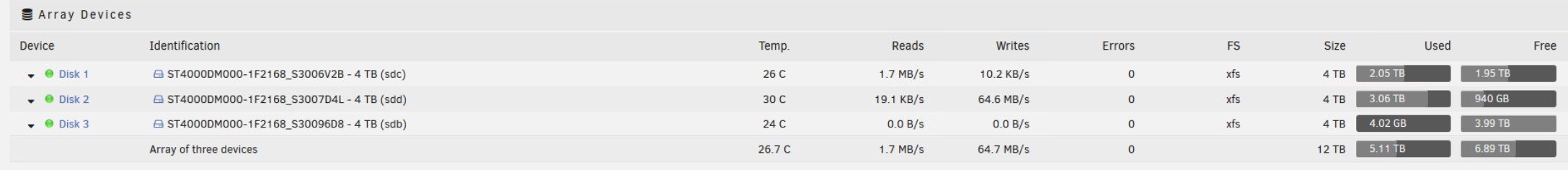

I'm a new UnRAID user and I've stumbled into an issue that I can't seem to figure out.  I just created a new array with 3 data disks (parity will be added later) and setup a share.  When I copy data over to the share, UnRAID will only write data to 2 of the data disks and not the third.
I feel like I have a solid understanding of split levels and the allocation methods, and I'm confident they aren't at play here.  To be positive, I've also adjusted them to split level 1 and most-free, but it had no effect.  I've also tried excluding the two working disks in an attempt to force writes to the third, but it seems to go ignored.
The hard drive in question just came out of a working system, and I also did a full pre-clear on it (which passed) so I'm pretty confident it is good.
I'm not sure what else I can try or what other information I can provide, so I'm hoping someone can help me out here.  Diagnostics and a screenshot attached.
Thanks in advance.

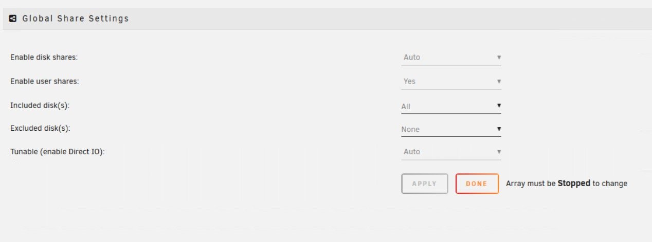

Go to Settings - Global Share Settings and post a screenshot.
You seem to have quite restrictive split levels on your shares.  Since Split Level wins if there is conventions with Allocation method for selecting a disk can you give examples of the path for some shares that are not going to the disks you expect?
@trurl Attached is the screenshot you requested.

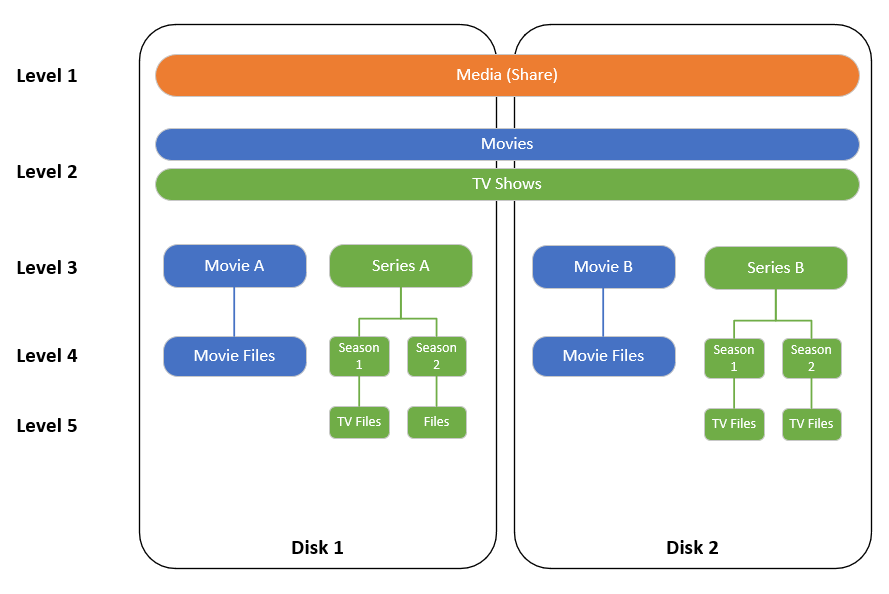

Since work is slow today though, and since I'm a visual person, I made a quick diagram showing what I'm trying to accomplish in the example above. It's basically the same example as in the manual, but including the disks.  Can you verify whether I would need split level 2 or 3 configured to accomplish this?
Thanks again.
I'd advise against doing it that way, because eventually if you get to the point where you have a long running Series, you won't actually be able to fit it onto that disk, and it won't expand it to another disk.
Doing a TV share and a Movies share is probably safer, with the movies set to split "top level only", and the TV show at "split only top 2 levels"
Yeah I will likely move to separate shares down the road so that I can have the level of control that you mentioned.
I still fail to understand why my initial setting of "split top two levels" was restricting all of my movies to go to a single disk using the structure in the diagram above.  I guess I'll have to test it out again when I recreate my shares and see if I can recreate it.
